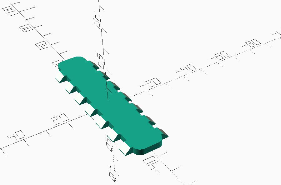

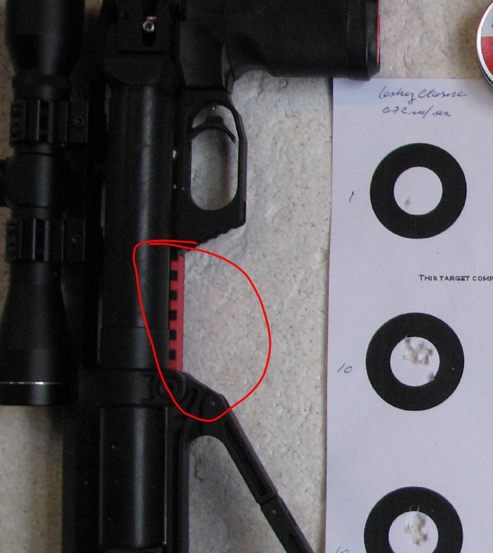

Sure would like to try that, would you share the .stl pretty please with a cherry on top?
Ok...two cherry's on the top and wait there more! ..... a special edition .stl for a Leshiy Classic lower picatinny rail cover!

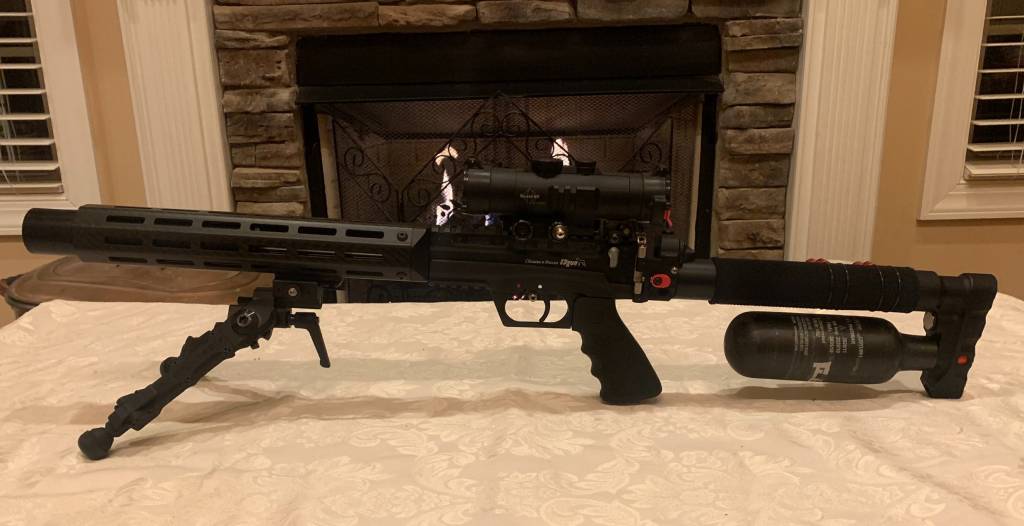

My gun arrived yesterday. .25 350mm. Cleaned and installed the bottle, CF handguard, Donny Shogun, Valkyrie long lock pin, Dedal Stalker, Magpul rail and AccuTac. Reg is as set from OE/Distributor (assumed 130) nozzles are marked .4/.5. Gun is shooting the 34s at 805 over the chronograph. Sighted in easily at 40. Dialed n Strelok.
Went out and shot a mag during a break today. First shot was 7 mil ho (120 yards) at a 3” bell... DING... then 7 through a splatterburst dot at 40. I honestly can not relate to folks having accuracy concerns. I am enjoying this gun a ton. Of course it is very early, but first impression is WOW... Love it!
Sorry for the picture, but it really is cold and nasty out. This will have to do right now😉
