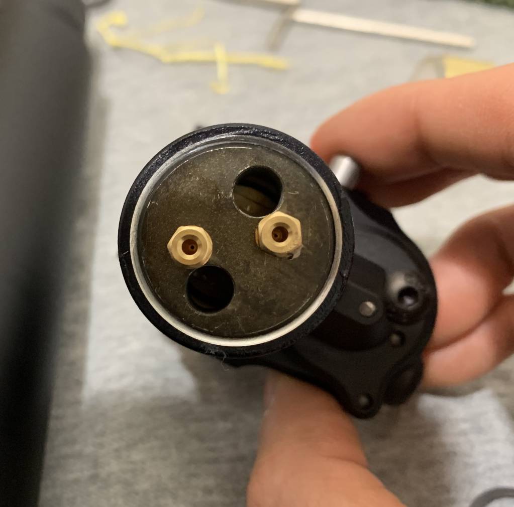

I just got L2.
I encountered an unsolvable problem.
My L2 is 6.35 (250mm), there are two nozzles, one is 0.2, the other is unmarked, it seems that both holes are the same size.
The key question is, when I inflate to 15 MPa, the excitation consumes 5 MPa at a time, and there is a sound of extra gas flowing out for a short time after the excitation.
I don't know what went wrong, I just bought it and it is new. Please help me analyze, so that I can further detect and exclude. thank you very much

Hello makarov
So when you fill to 150 Bar every shot lowers the pressure 50 bar and the valve leaks a short time after you fully release the trigger
..and you do your trigger pull in a quick pull-release motion?

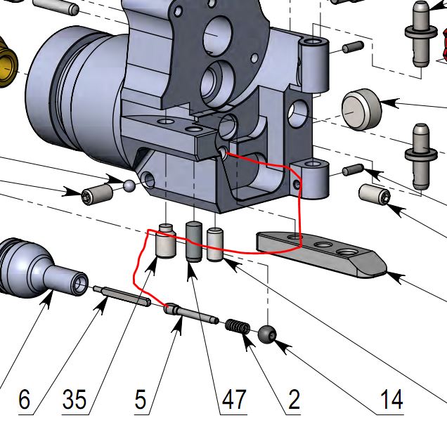

Not much is known about the valves inner working, but Comtruise had a problem with his (starting page 92 this string tread, picture of valve dismantled at page 94), do your Disconnecter pin (part 5) show the same excessive forward play?
Quote: Comtruise page 92
"Disconnecter" pin has excessive forward play, likely due to a spring failure that is in front of it as it seems designed to restrict its free movement forward. Mine has no tension for 3mm or so back and forth without too much force so that the valve pin is depressed and gun fires

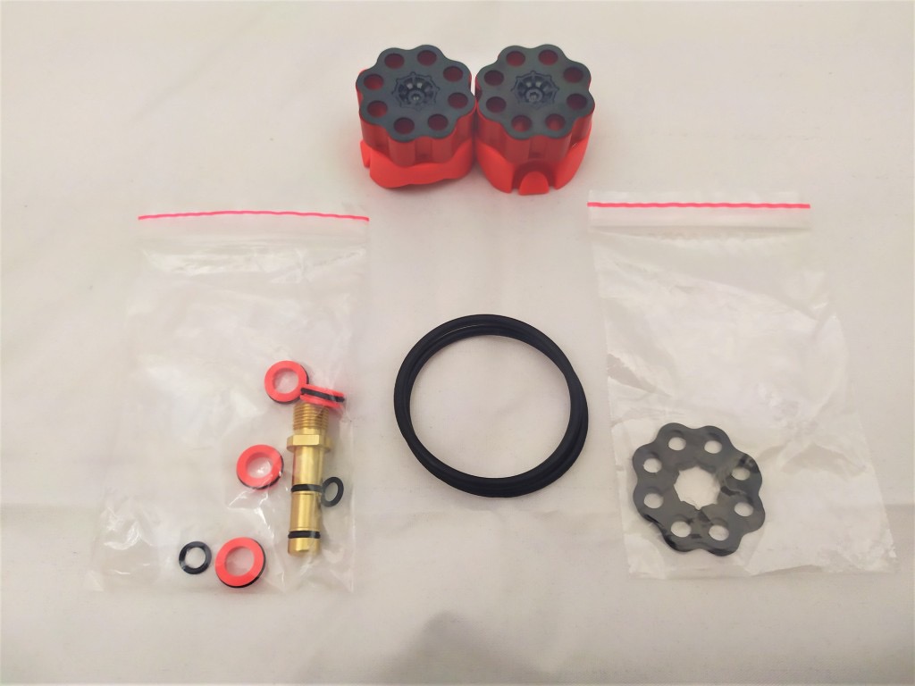

I just asked the seller. The seller told me that I had a red rubber ring and forgot to send it to me. There are two specifications of red rubber ring in the original box. They have different inner diameters. I didn't give me a small one, only 4 large ones. No., so I used a large one. The seller sent me the small one today. I don't know if this is the reason, I'm still waiting for the rubber ring.
Do you also have two types of red rubber rings in your package?
Don't think so, a smaller one should not effect lock time of the valve - or make it leak, only restrict the airflow
Yes 3 large and one small, only use the large one (.177 cal) - the correct way to adjust the power is to change jets

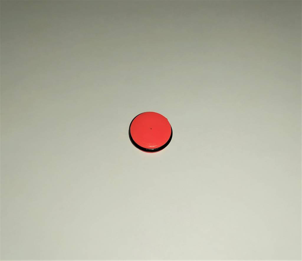

The red rubber o ring as you call ik is called a power puck , its made of plastic and its use is to get the air flow restrikted .
Due to the regulations in russia and other countries guns ar to operate at very low power 2j and germany 7 j ,uk and poland 16j etc.
So that is where its for, for the uk specs 16j they dril the hole to 2,5 or 3mm and install 0.9 and 1mm Jets so the guns even at 70 bar reg pressur don't exeed the legal limmit of 16 j.
It reduces the power but does not make it more efficient because of the volume behind it.

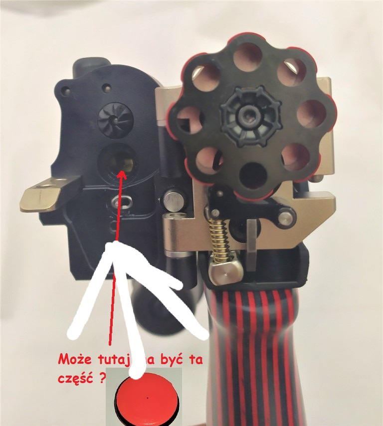

The problem is with the adjustment on the gun, do not send it back. There is a small Allen key just below where the power puck is located, you need to adjust it, slightly, it is very sensitive. Brian from edw spoke about this on the Facebook forum.

Your problem is the stopper pin. It needs to come out. I answered your email last night in Polish but didn’t realize you spoke English. Your dealer is not correct the puck will not solve this issue. Loosen the locking screw on the bottom of the valve assembly, then turn the stopper screw on the breech face CCW. Test the shot on an empty magazine

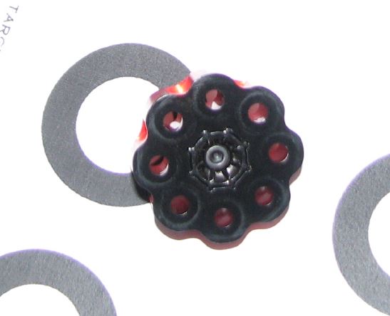

...but my Leshiy is in .177 cal with smaller holes in the cover plate than yours so there is more back pressure for the valve to work, it has to be same caliber to be comparable
