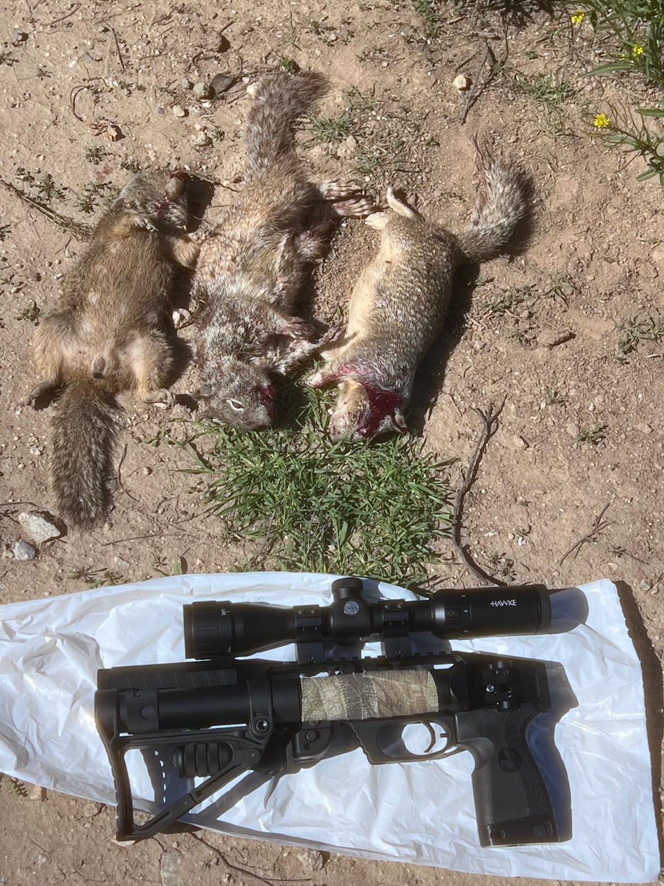

Yes:) my favorite thing in the world . Ground squirrels with Edguns
