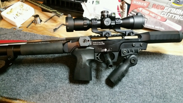

Here it is. I had one of the older Hawke 2-7 scopes but 7 power is just not enough mag for my eyes. I tried the 3-12 bugbuster and it is really nice for $100, but then I saw this Burris and with the Plex reticle seems perfect. The reticle on the BB is THICK compared to this Burris. The BB is nice with it's side focus (if you're right handed), but since I hold the grip with my left hand, having the AO on bell is easier to adjust while hunting for me.
That looks great! I also like that folding foregrip - it looks like it fits the Leshiy very well :)

Thanks - the fore grip was $8 on ebay. It locks in 4 different positions. I usually wind up shooting it like below

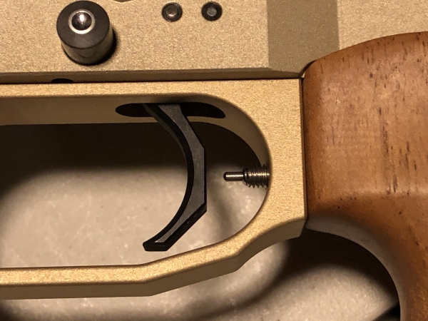

My Leshiy will not cock with a bipod on the front. It would prior to the trigger mod, but now the butt stock needs to be able to set the safety in order for it to cock.

Just tap on the trigger when it should cock and the trigger will set. The trigger mod applies to much pressure on the trigger. So when you fold the gun to cock it just press the trigger will allow the sear to set.
Either that or you can install an additional spring under the trigger guard.
I had heard something about adding another spring, is there a link to diagram or other instructions? It would be nice to use a bipod off the bench

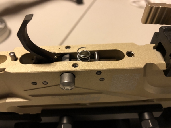

Here is where I place the spring for my Leshiy.
I trim a couple of coil from the spring to make it shorter.

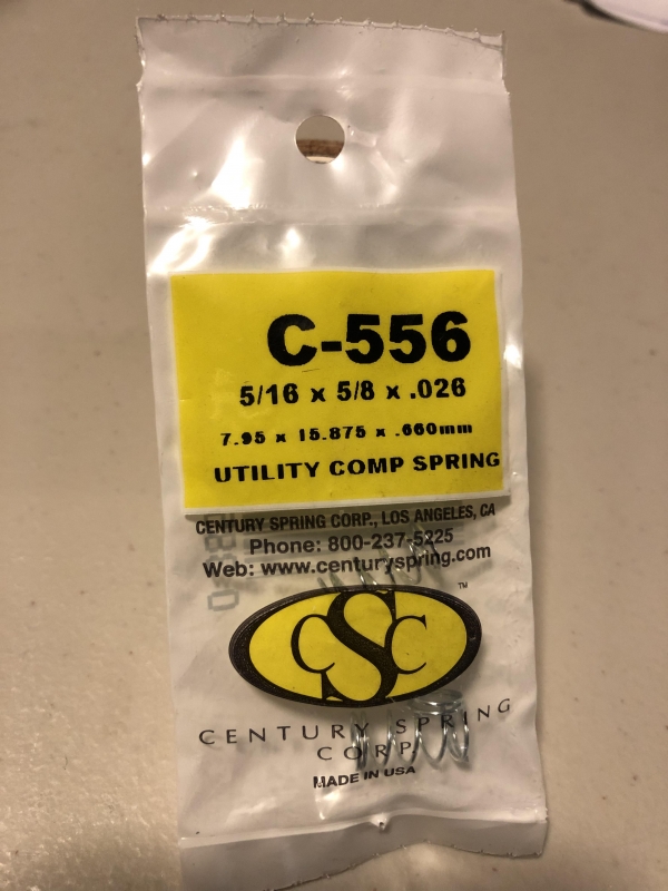

Thanks for posting that! BTW, What are the dimensions of that plunger screw behind the trigger? 14mm, 16mm M4?
M4x16mm
