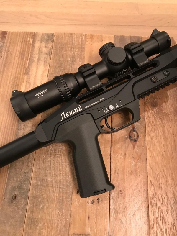

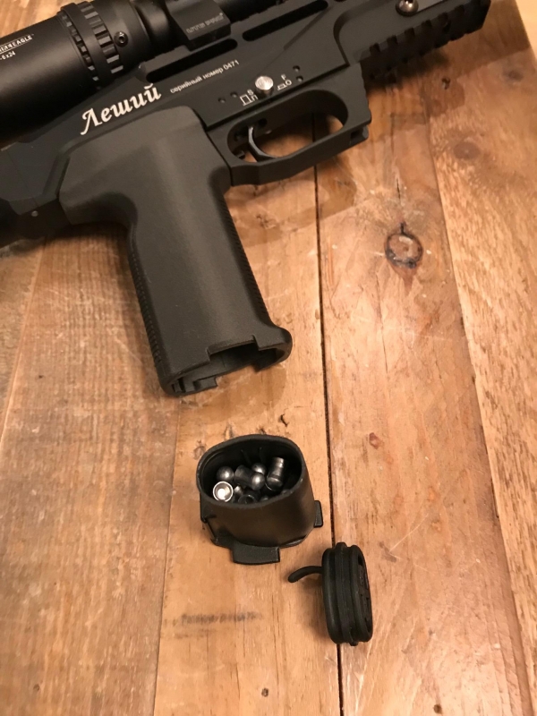

I love this gun but decided to model up an alternate full-sized grip for mine. Included storage in the bottom for a reserve cache of pellets. This grip is printed in nylon and carbon fiber but the design would work fine on most any 3d printer. If anyone wants to print their own and try it I am happy to share the STL file free of charge. I love this gun even more now :)
