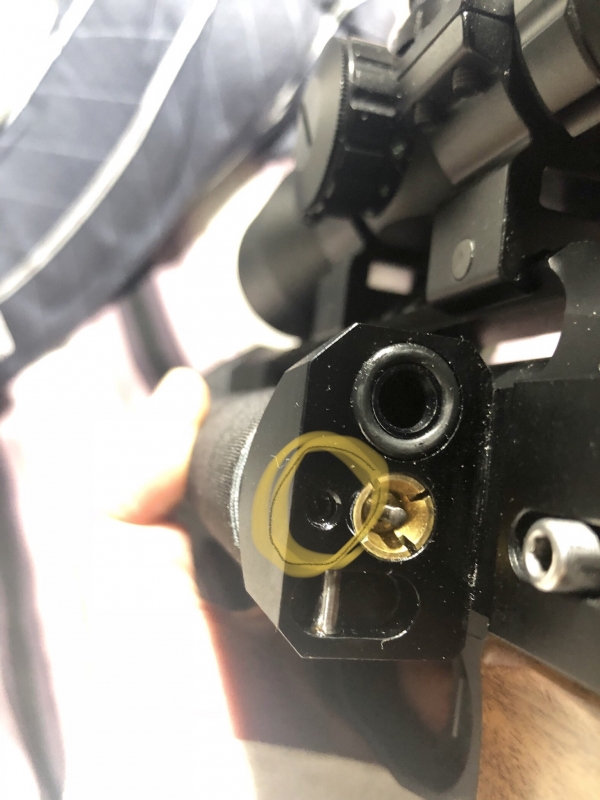

Finally I found where it is leaking but not fast....
even I tightened the screw very much. Any suggestion guys?

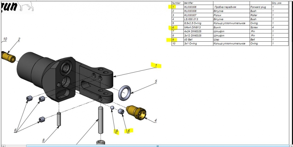

That's the drain screw for the air reservoir. I haven't drained my Leshiy in a while, but I believe there is a small ball bearing under the screw that does the actual sealing, the screw just pushes the bearing into the breech block. I would loosen the screw to fully drain the reservoir (and then press in on the valve stem to verify the reservoir is empty), then remove the screw and make sure the small sealing ball bearing is present and that it and the sealing surface in the breech block is clean.
It does not take much torque on the drain screw to get it to seal up, so if yours is leaking from there it may be debris, a deformed bearing, or deformed sealing surface in the breech block.
If I'm wrong about the presence of the bearing, someone please correct me... I'm going off memory here, it's been a while since I've drained my Leshiy.
