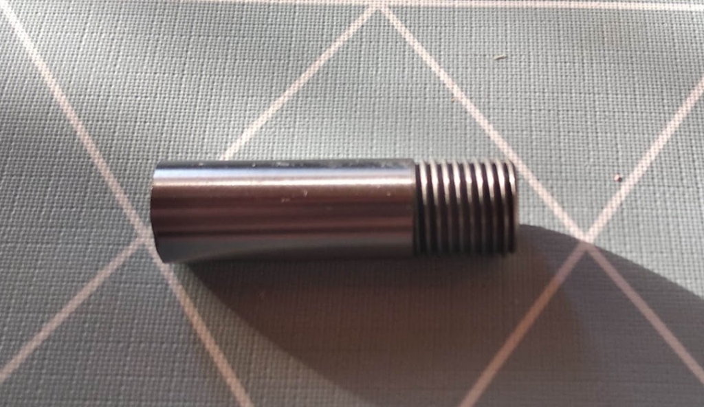

Mike what did you do to the inside of tube where the tension nut goes against ? Got a photo ?
What to you mean ?
I made a new one, same ID and OD but shorter
Mikepr Sorry my MISTAKE bad memory Thought where the nut tightens against was attached to the shroud I see its a separate piece one day I'll have to tear into mind to be more familiar with it
