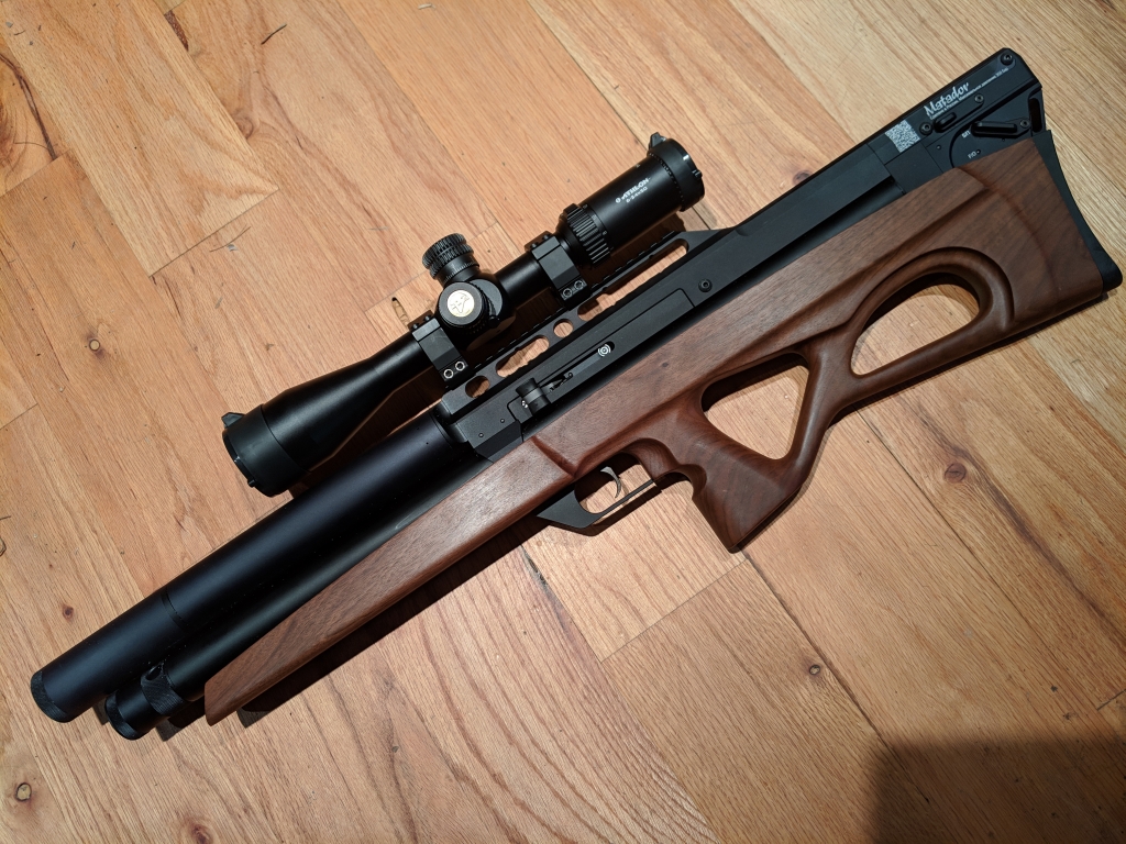

Edgun Matador R5M Long in the house
I've got some nice toys, but made a deal with wifey that I couldn't have a new gun w/o selling an old one. So I sold my nicely performing .25 Streamline and ordered an Edgun .177 to use for field target. Not sure what I'm thinking here, but it's done and arrived today.

It had a rough ride getting here. The styrafoam was really chewed up and had little bits of it all over the workings of the gun. Would have been nice if they'd put it in a bag before packing it up. Oh well, air compressor to the rescue. There's also a pretty good scuff on the tube that I'm hoping some gun oil will take care of.
That taken care of it was time to shoot it. Which way does the mag go? Darn, no instructions. Oh well, google to the rescue. Hmm, no instructions on the Matador R5M, but did find some on a leshy, so at least I got the mag in right.
Didn't really have time to setup a table and everything so I shot freehand into a trap @25yds. Hit it every time. Nice! I'll dial it in this weekend.
Fit and finish. Stock is a little rough here and there. Doesn't fit very tightly either, actually, it's moving quite a bit. Email off to edgunwest on this issue. The metal is quite nice. Action is kinda rough though...compared to the Impact anyway. Maybe some oil.
It's a tank. 10.6 lbs all up. But I'm a big guy so NBD.
I thought I'd ordered extra mags, ammo and some rings. No show. :( email on that too. Luckily I had a tin of JSB 10.34 Heavys or I'd have been slinging 7 grain pellets.
oh, and does anyone know what the lever is for that is at the top/back of the gun on the left side above the safety? Doesn't seem to do anything. Must be something...
Overall I like it. I'll probably refinish the stock or get a laminate one. Gotta deal with the looseness though right away.

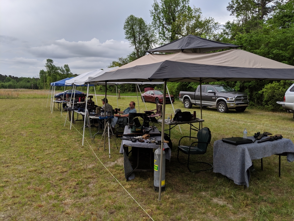

Went to Cross, SC yesterday and had a great day. It rained like heck on my way down (3hr drive), but once I got there the skys cleared and it was a nice day. Arrived about 9:15 and shot till 5:30.
I shot 2 guns mostly. My recently tuned HW98 and the Edgun. More on the 98 later.

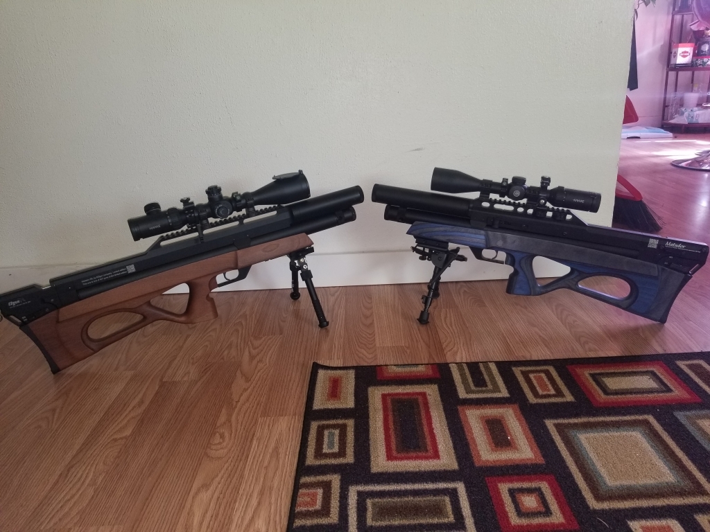

I just got my second Edgun a month or so ago. My first one was a Lelya 2.0 which came out of the box flawless. My second was a R5M Long in .22. Only real problem was a puff of air in my face.
After a bunch of trail and error, I finally found the fix. I put a small thin rubber washer behind the breach o-ring. It was a $0.30 fix.
I think that the high pressures I was using was pushing the breach o-ring just back enough to let air excape out. This thin washer that I installed was just enough to keep the seal tight.
This is where Edgun shines- simplicity of design. If there is a problem, I am able to work through it-not ship it off and be dependent on someone else. I am now shooting 24g slugs at 945fps for 48fpe, with about an average 1.1-1.5" TEN shot groups.
Now, the the puff of air in my face gone, and several other tweaks in mind, I have no doubt this will be a MOA or sub-MOA slug shooter at 100 yards. Ill have video soon to prove it.
I expect your R5M Long to like even heavier pellets. My .177 R5M STD is tuned at 29 FtLb right now. Mine shoots the 16.2 grain Beast at 933 on this tune😳 Micro HAMMER😉
