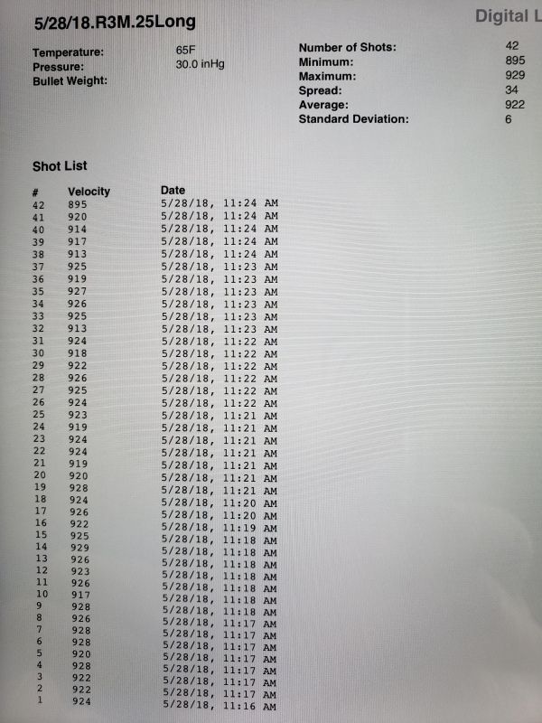

now my question is what is the stock fps fir tge r3m long? The previous owner said it shoot the .25 25g at 905.
seeing I'm only iinterested in shoot the 34g pellets, would the gun in stock for push the 34s? I'm hoping it can push the at least 840 without any adjustments.

"Terryb00"DeadEye,
I shoot it over the chrony with the Heavys, without the stock on, so Im able to access and turn the HST little turns till I get my speed where I want it.
With the Long's longer barrel and air tube you should be able to get similar results easily.
Enjoy, awesome gun.
