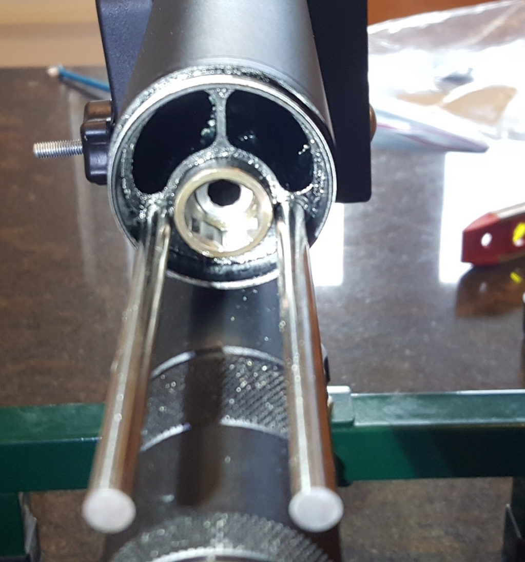

  1. Get two 5.5mm small pieces of drill stock. I ordered mine from McMaster-Carr (https://www.mcmaster.com/catalog/2900A322) for roughly $4.50 each.
  2. Loosen the barrel nut
  3. Insert the drill stock into the two hole in the barrel nut rest.

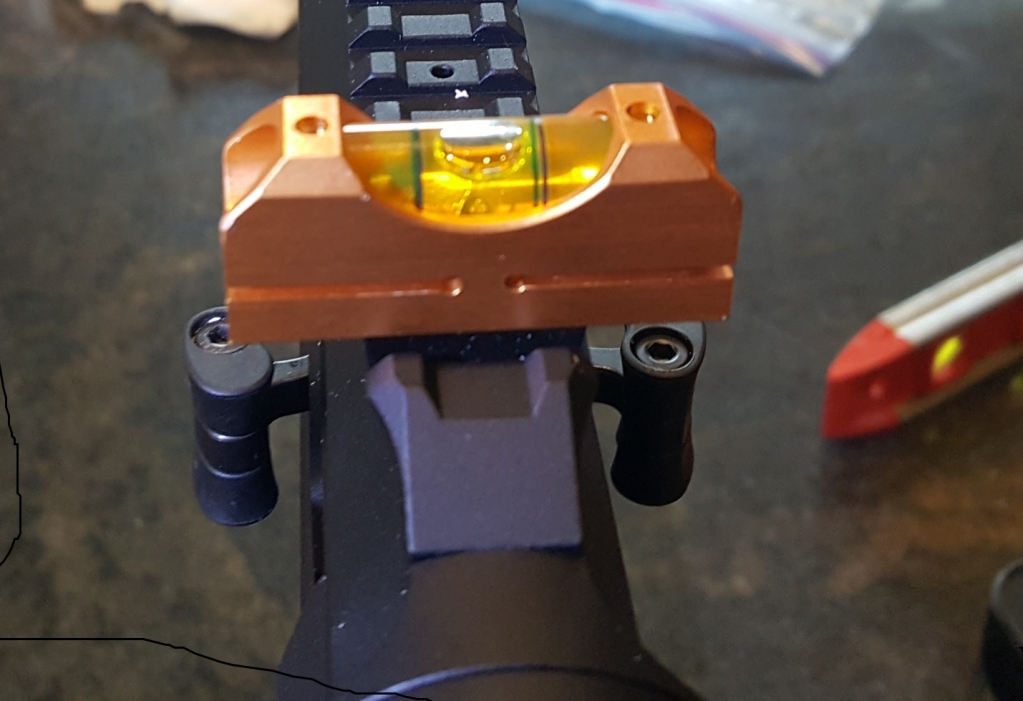

  4. Level the rifle using the scope rail.

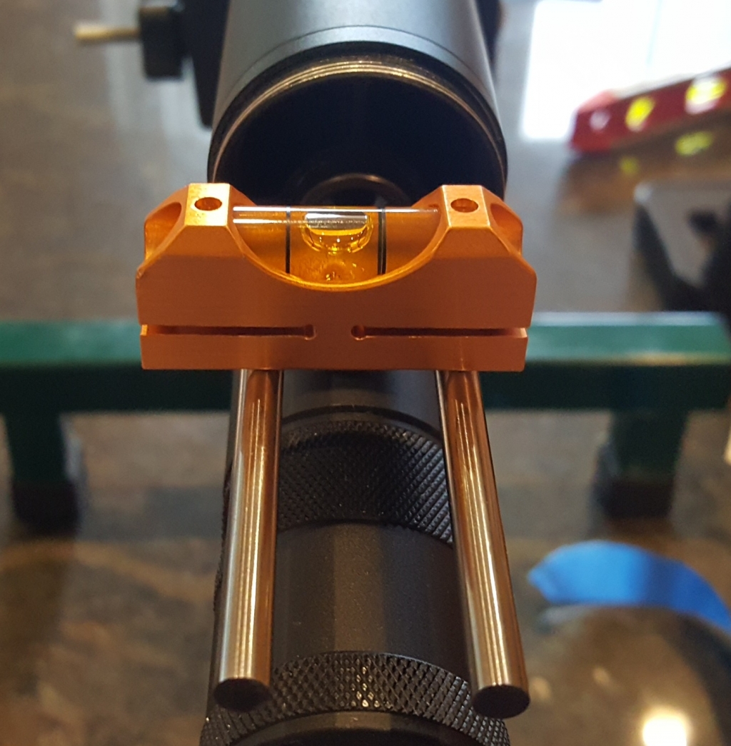

  5. Place the level on the drill stock and twist the rest until both level measurement places are in alignment.
  6. Hand tighten the barrel nut slightly and verify both level measurement have not shifted.

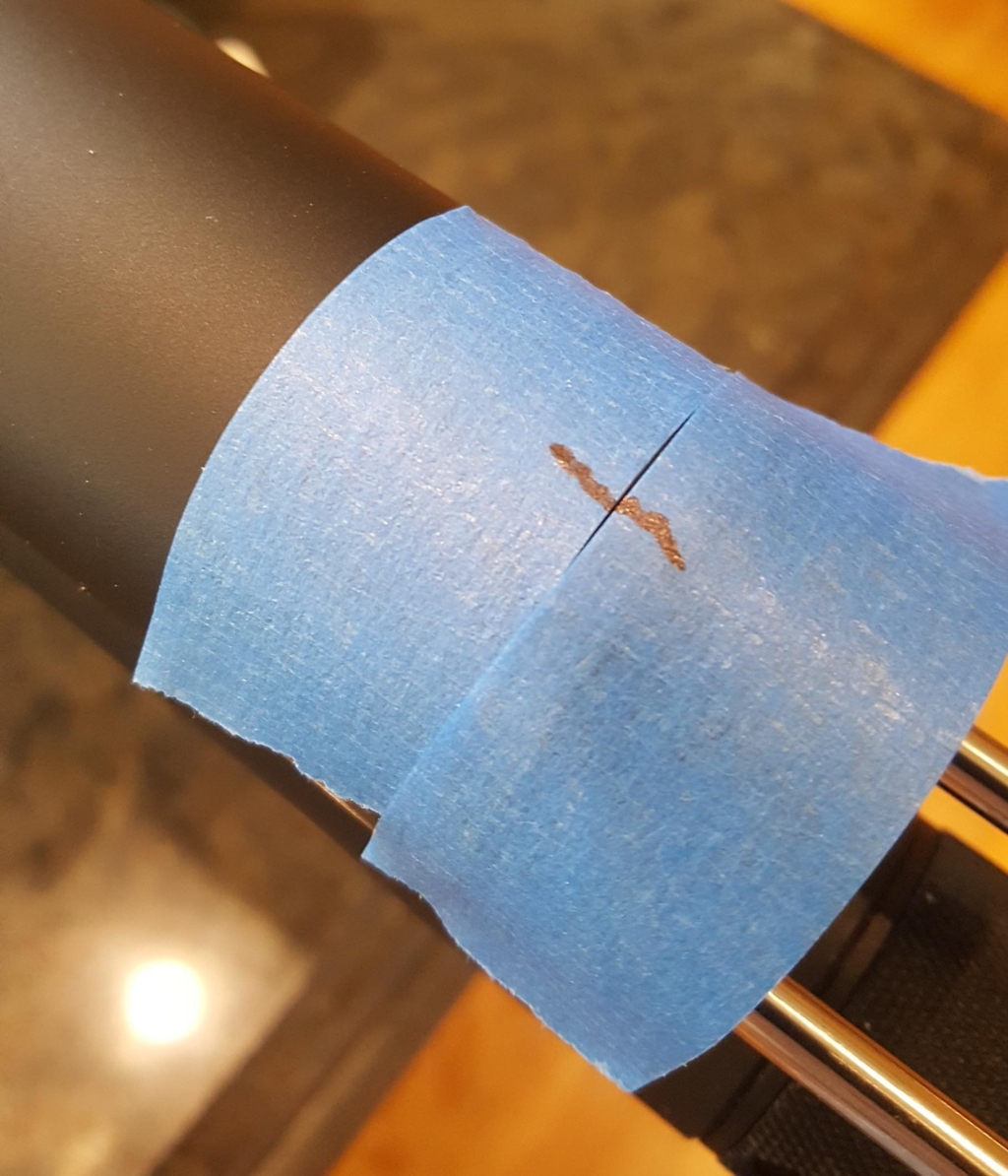

  7. Put a piece of tape on both the rest and the barrel shroud. Draw a witness mark to verify the rest does not shift during torque down.
  8. Torque the barrel to 12 foot lbs per zx10wall.
