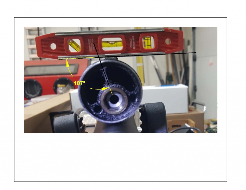

Well while fussing with the EDMU to get the button to work reliably, I lost the 3mm ball bearing on the fill shroud. So the moderator needed to come off to install the new ball bearing. While putting it back together I noticed the exit hole on the moderator is at 5:30 versus 6:00 or right at the bottom. It seem like something went wrong with the moderator install so I pulled it apart again. It appears install was correct since the barrel is in that location. Is that where it is supposed to be? Hopefully, the scope rail is offset also.
The more I looked at the barrel alignment, the more it bothered me. See the marked up photo below:
The 107 degree angle is measured from the flat on the scope rail through the center line on the barrel nut. I'm thinking that angle should be 90 degrees. This means the barrel was tensioned with the barrel nut rest rotated a full 17 degrees counterclockwise from the bottom. What do other RM5 owners see on their rifles?
Loosen, square and torque to 12 ft/lb. Hold square while you torque. Your barrel is being held out of alignment as is.

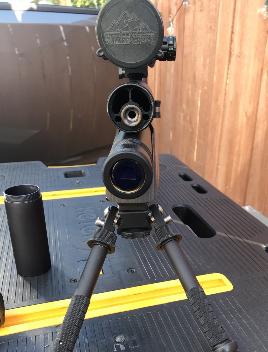

Mine is not zeroed as well.
1578609661_15529617915e17abfd4cd918.62185674_3BF13659-053F-4B49-BE89-8B49598FB7C4.jpeg

Simple fix as suggested by ZX.
When I looked at my rifle last week, my barrel offset was the same as your's pictured. I adjusted mine to set the barrel at dead bottom. I assumed that my gun was just a goof up at the factory, but now seeing that multiple guns have the same offset I'm wondering if it is done on purpose. Hopefully Ed himself will comment on the issue.
It just seems like the location of the "rest" could have been fixtured for ease of assembly.

I just looked at barrel i had on last and the unit is not aligned, I had this issue with my lelya on reassembly one time , I am grasping at any straw to get this to shoot slugs well lol
https://www.airgunnation.com/topic/edgun-r5m-barrel-alignment-procedure/
i am sure this wont help it ,
you know I made a tool for my lelya with 2 1/4 rods and a 1/8 medal and migged it to rods , sort of like this thread to align ,
I will try it upon assembly ,and next week this will be my gun or ill set it out at 100 yds for a target if it gets me pissed ,
