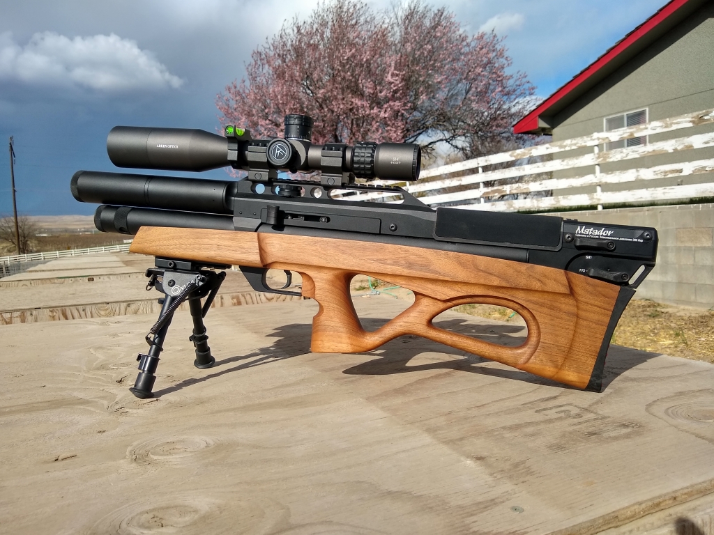

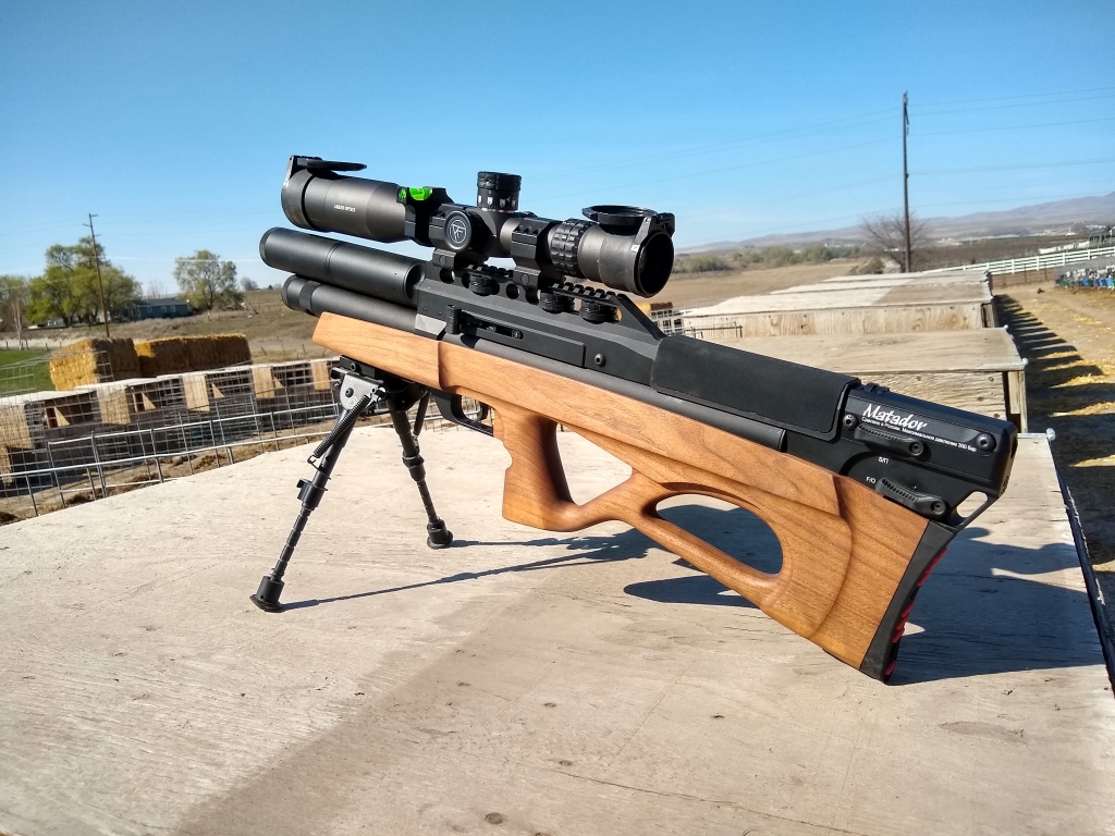

Think I can now be called an Edgun fan lol. Recently getting the R5 I just realized how much I really enjoy Eds guns. Top knotch build quality and rugged, powerful, accurate guns. Also very easy to work on if needed thanks to Ed himself doing tear down videos and Brian at Edgun West also. Also wanted to have 2 guns that shared quite a few same parts. In comes the R5M Standard .22. This gun is a beautiful gun and just a very good shooter.
Gun came with reg at 125bar. Fps maxed at 1000fps so decided needed to drop reg pressure. Dropped it to 110bar and now maxed at 940fps and tuned to 900fps with the 18gr JSBs. It's shooting hole in hole at 50yds. I'm not sure what I want to do yet if down tune alittle more or not to the 860fps range for more shots or I want to try NSA 17.5gr slugs in it and see how they do first. Would like a tune that both will shoot good at so I can use slugs for windy days. Compared to my long R5M .22 I had before I really like the feel of this gun for an everyday shooter and carry around gun. Balance is awesome.
It's paired with an Arken 4-14x44 SH-4 scope. I honestly think I found my new favorite scope. Really like the reticle and just everything about the scope works perfectly. Tracking is awesome and the side focus is very nice. If I ever need another scope I will be picking up another one of these for sure.
