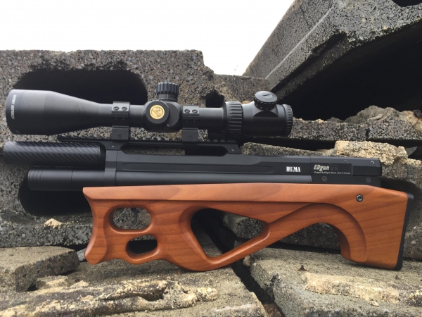

Nice, here’s my Lelya, same action ad the Veles.
I also upgraded to the HUMA reg with wonderful results.
