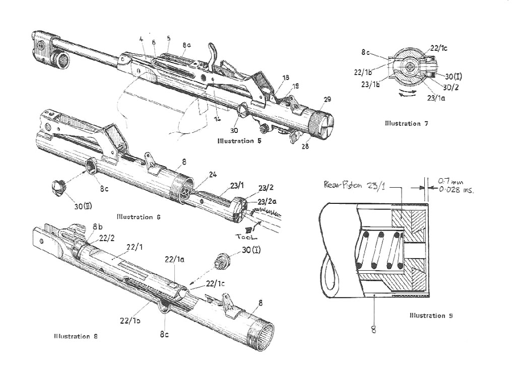

Somewhere, I have the maintenance book put together by the original air rifle headquarters. I have some scans of the maintenance procedure and diagrams, one of which shows the spacing between the counter piston and rear cap. I resealed this pistol once in the early 80s but it has been too long for me to remember details.

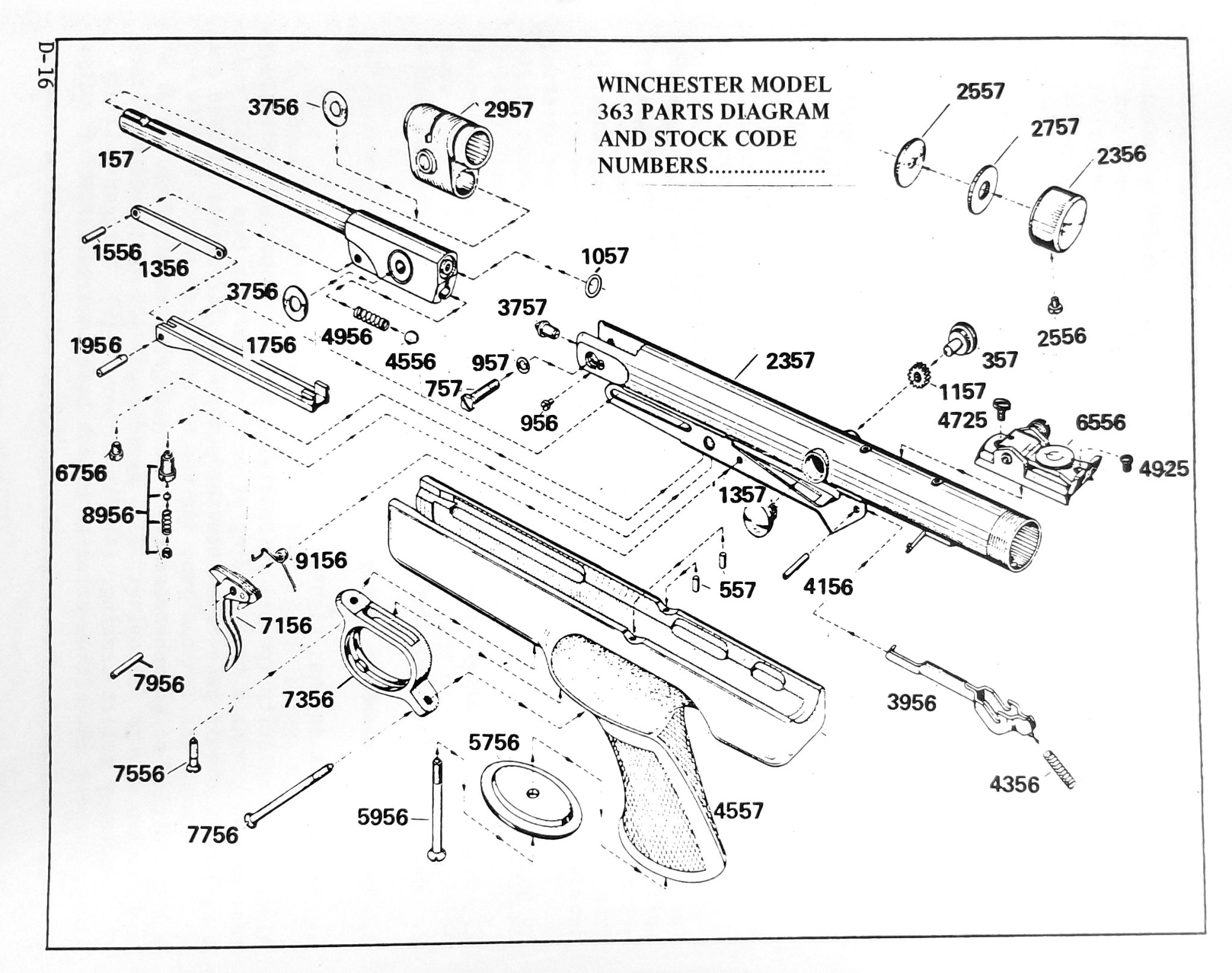

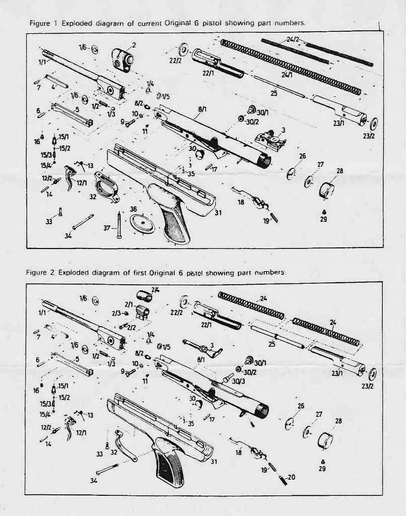

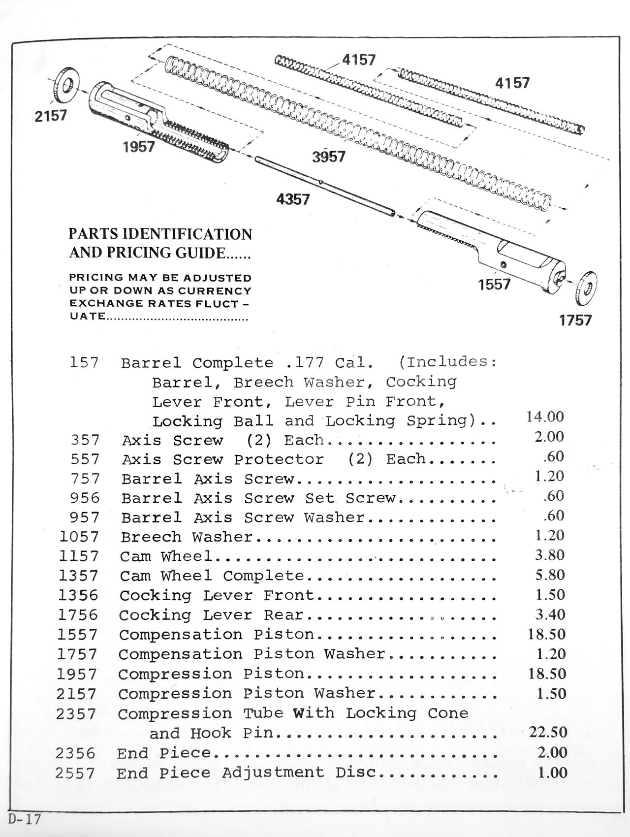

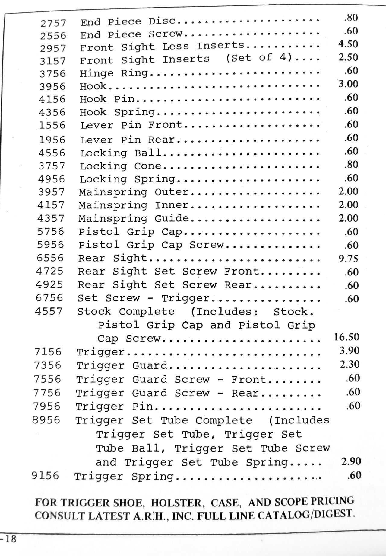

Hey guys, looky what I found today. My original Diana 6/Hy-score 816/Winchester 363/Gecado 6 instruction manual, compiled by Robert Law of the original Air Rifle Headquarters, dated 1973.
Here's the cover, I'll upload some of the more relevant pages when I get a few more minutes.
Diana 6 instruction manual.
Hy-Score 816 instruction manual.
Winchester 363 instruction manual.

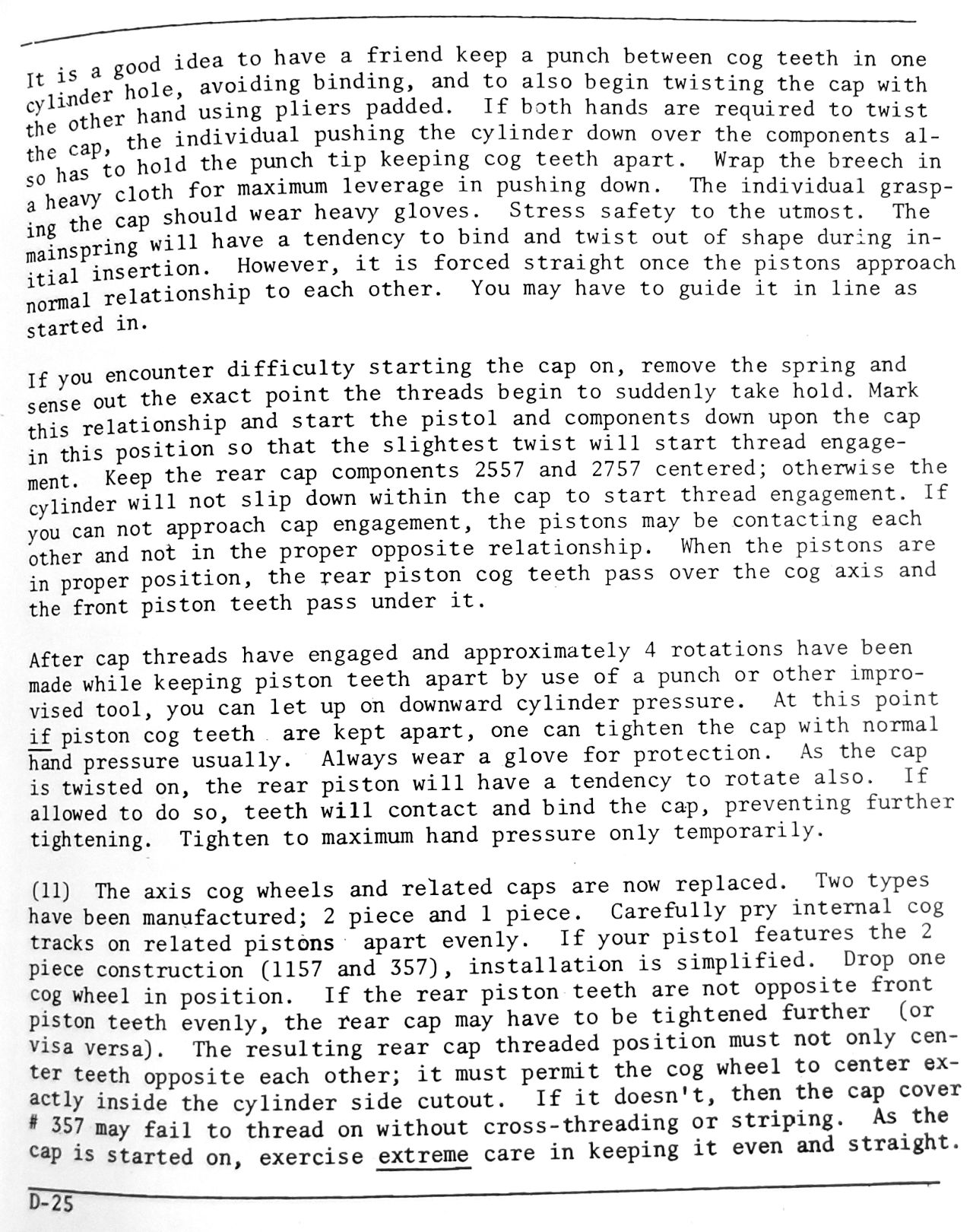

@Motorhead ,
Did this help you? Robert Law's procedure differs from what you did by using a punch (or other rod) inserted through the receiver cog holes to keep the piston gears separated while first compressing the springs and installing the end cap. The cogs are installed last, with minor adjustment of the end cap threading position to get the gear teeth lined up. In this way, both pistons stays at their mechanical limit of travel in the uncocked state.
