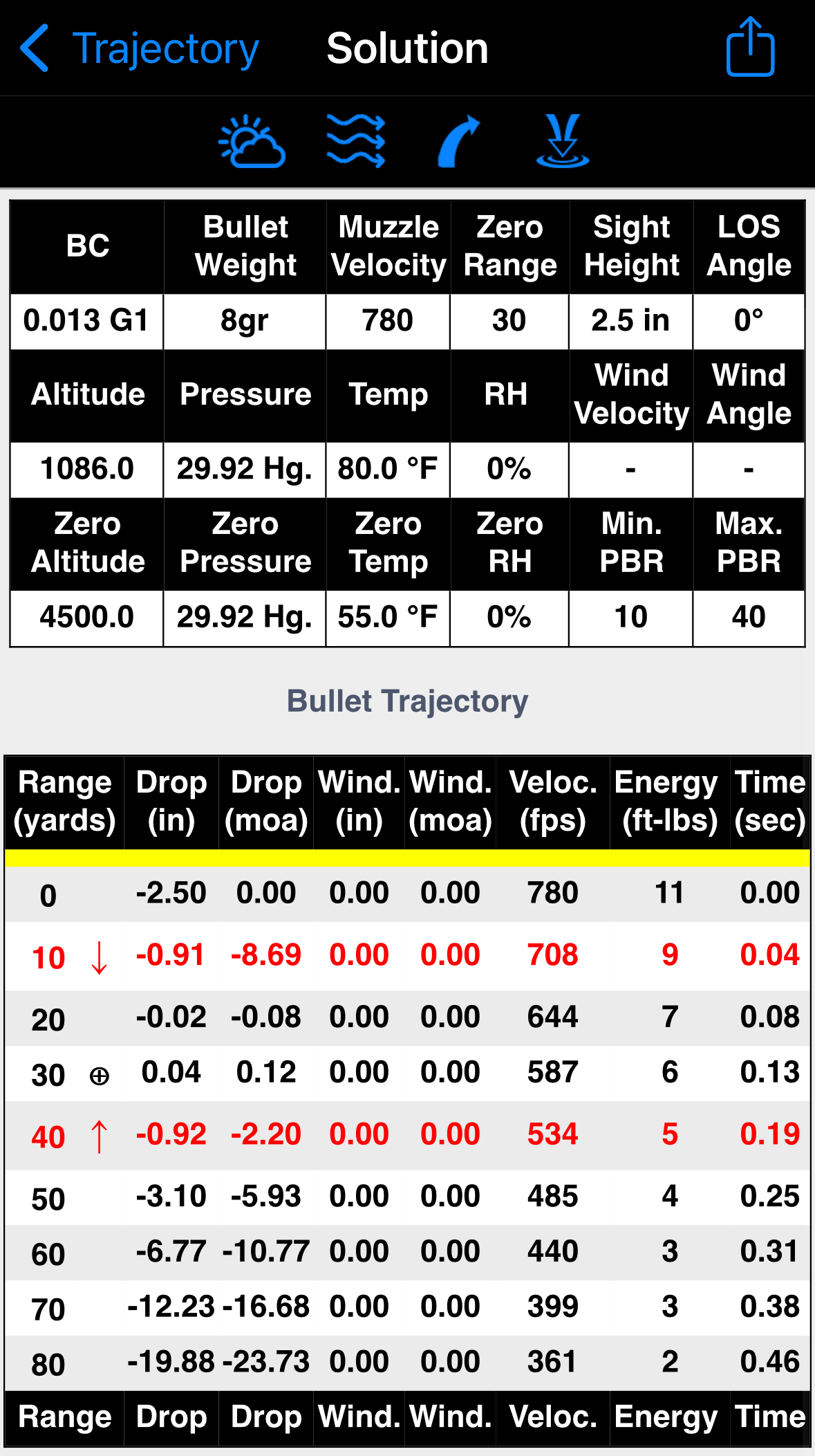

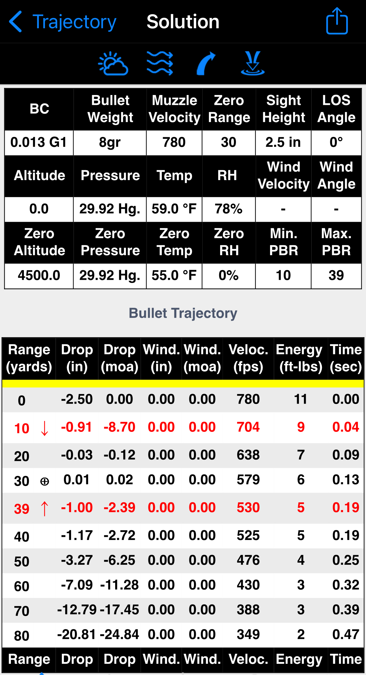

plugged in your numbers
This chart shows adjusted altitude and temperature difference.
