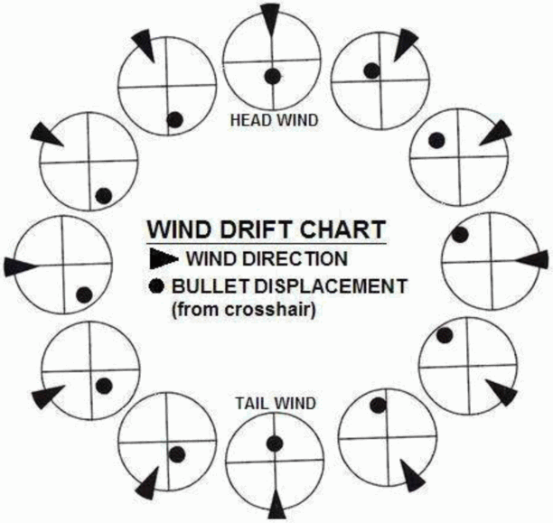

Bullets:

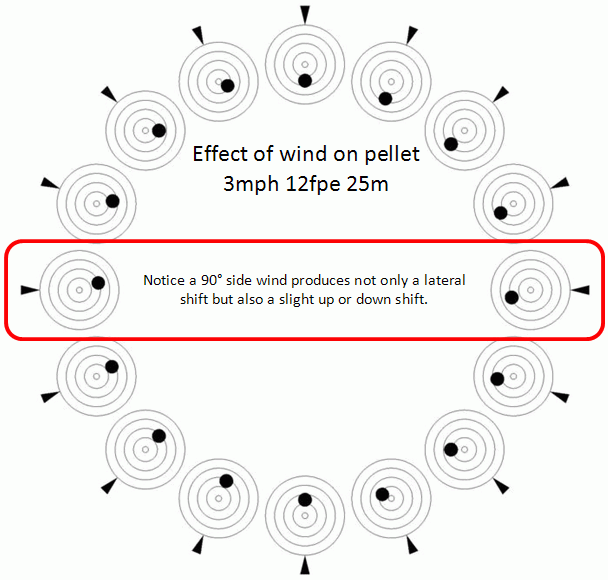

Pellets:
In my narrow experience, pellets drift more than slugs or .22lr rimfire. Actually I was kind of amazed just how much wind has an effect on pellets. I compensated and on a few rare shots, shocked I actually hit the target. Youtube had some videos on HFT. I have one of those airport wind socks on my property which I find handy at times. Good luck in your venture!
That chart is the biggest scam in shooting history. It would be fine if wind was constant. Or if wind only moved in the direction of the pointers on the chart. That's not what wind does. It's turbulence. And it's not a constant variable. Light a small fire in 3 places along a 50 yard path. Then watch the smoke. You will find that this chart means 0- nada- zilch.

I know quite a few successful Benchrest shooters that do not use that chart, " for every shot." There is absolutely no way to tell what the wind will do along a projectiles flight path. In terms is Pellets with a large sail, called a skirt, that chart is useless. You may get a little closer to the x ring....you may not. It is not a holy grail by any means.
Of course, there are variables, but it will get you in the ballpark. Only practice and experience will refine the chart for that day/pellet and gun.

The chart works but you also need to understand the wind may change along the flight path of the pellet or between when you checked it and when the pellet flew. When it varies along the path you need multiple wind flags to even see what is happening.

The mechanics of downwind drift were explained here. https://www.airgunnation.com/threads/how-wind-causes-pellets-to-drift.1278969/.
The vertical effect is due to the gyroscopic stability effects. I did do a thread once, but I don't think I have ever put it on this forum.

The flare on a pellet has noting to do with the downwind drift of a pellet and has very little relation to the effects of a sail on a boat, unless your pellets have very serious stability problems.
