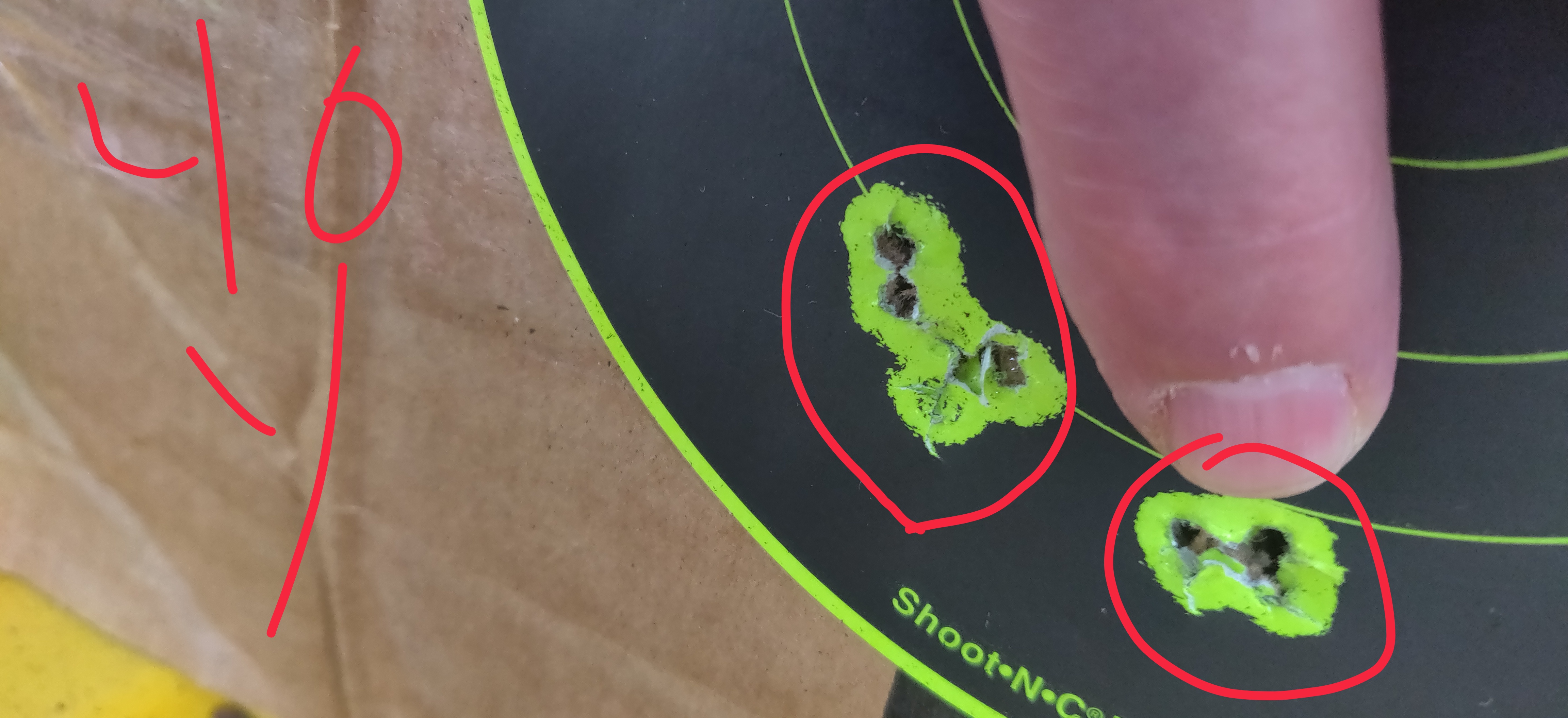

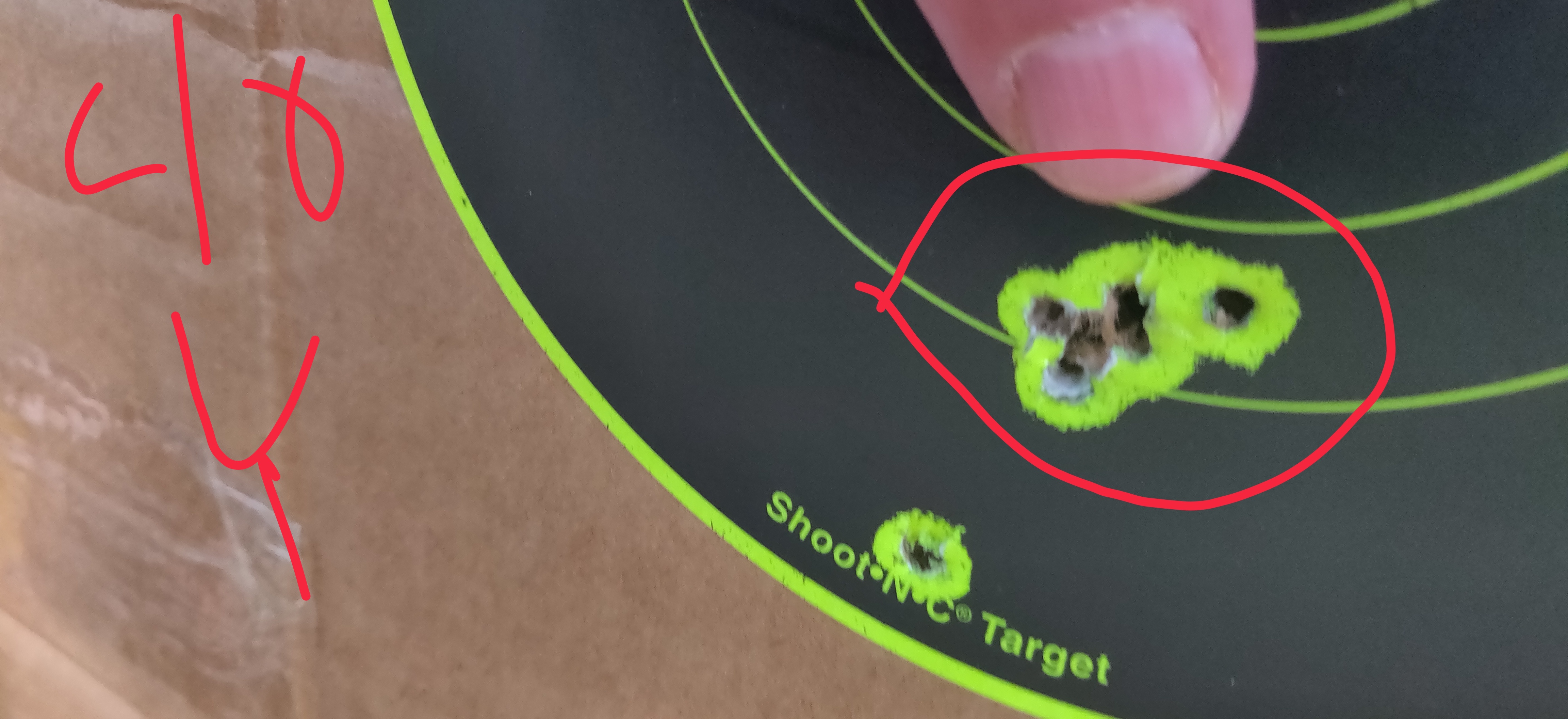

El cheapo Beeman 2027 @ 40 yards
Picked this little guy up for $110, cleaned all the internals, added a oring behind the hammer to reduce bounce and lightened the hammer spring. Added a 18" barrel from a Barra 1100z. 40 is the furthest I can shoot at my place but I really want to see it at 50 and beyond. Getting 36 shoots 2800-1200 psi at around 750-800 fps.

Doing the bstaley mod and mucking around with the hammer spring really helped with flatting out the bell curve and giving me more usable shoots. Not to mention adding the 18" barrel help out with the fps quite a bit. Also note that out of the box with the hammer turned in about 3 quarter of the way I was at 910fps in the Middle of the shot curve. The gun really has a lot of wiggle room for improvement.
