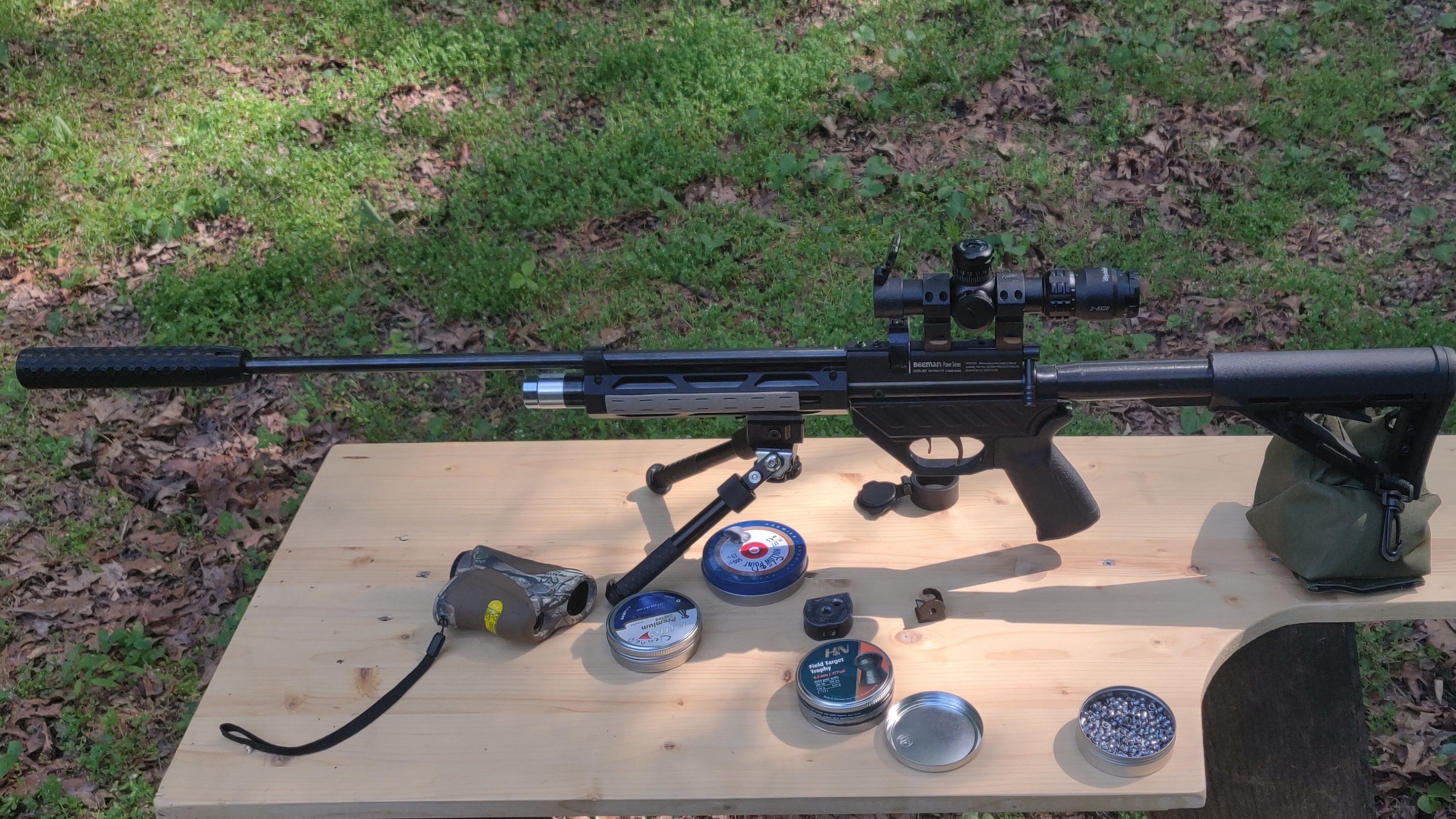

El cheapo Beeman 2027 @ 40 yards
Picked this little guy up for $110, cleaned all the internals, added a oring behind the hammer to reduce bounce and lightened the hammer spring. Added a 18" barrel from a Barra 1100z. 40 is the furthest I can shoot at my place but I really want to see it at 50 and beyond. Getting 36 shoots 2800-1200 psi at around 750-800 fps.

Very nice rifle and shooting. Do you have a shroud over your barrel? Thanks
