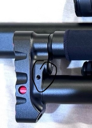

Yes, I agree that its not the gauge ... but I'm not touching anything leak-check related because that was supposed to have been fixed upon receipt or repair order. In the meantime, could someone please pm me some pictures where the "3" bleed screw locations are on the Leshiy 2 so if I do end up having to do the unfinished work that I can. Visual learner here ...
if they Leak don’t snug the crap out of them. note where the wrench sits, loosen then tighten slightly more until it stops leaking. Remember the secret is to loosen first and then tighten
Yours may or may not have the back one. It’s metric
