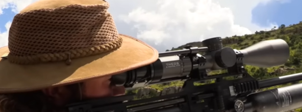

Matt mentions the Element Theos at minute 4 in this video. It is also seen at 13:28
