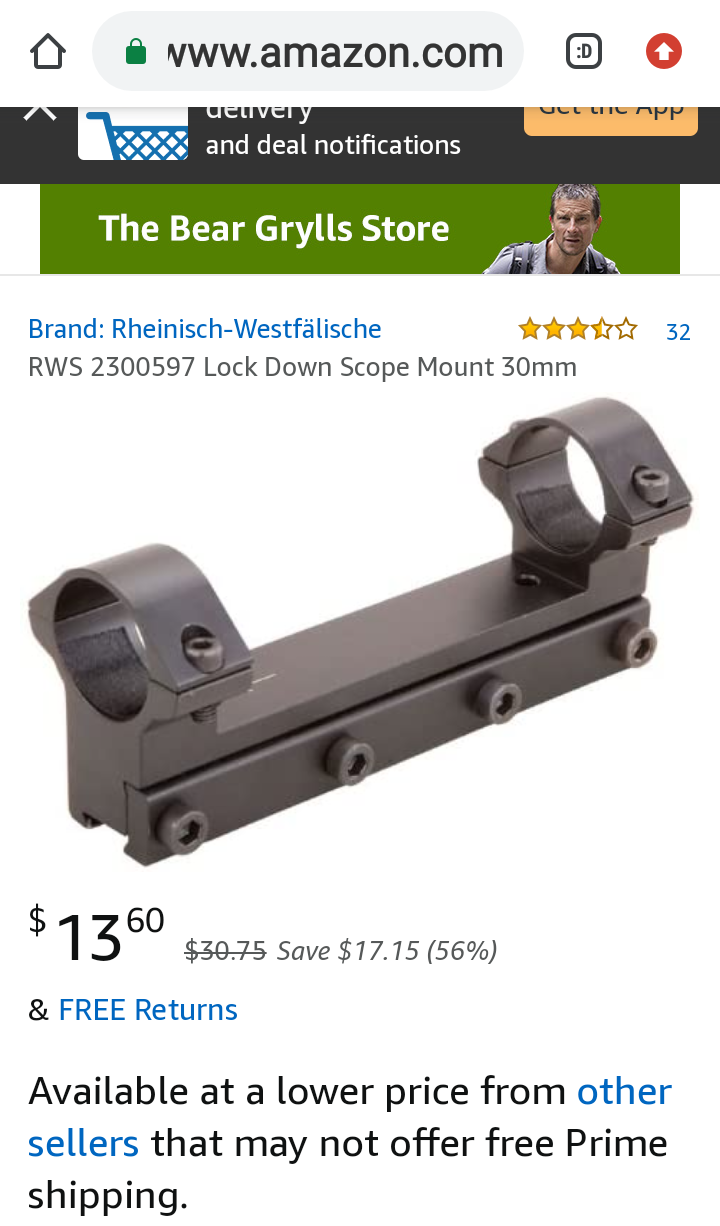

Your other option is...If yours is a 30mm scope tube...

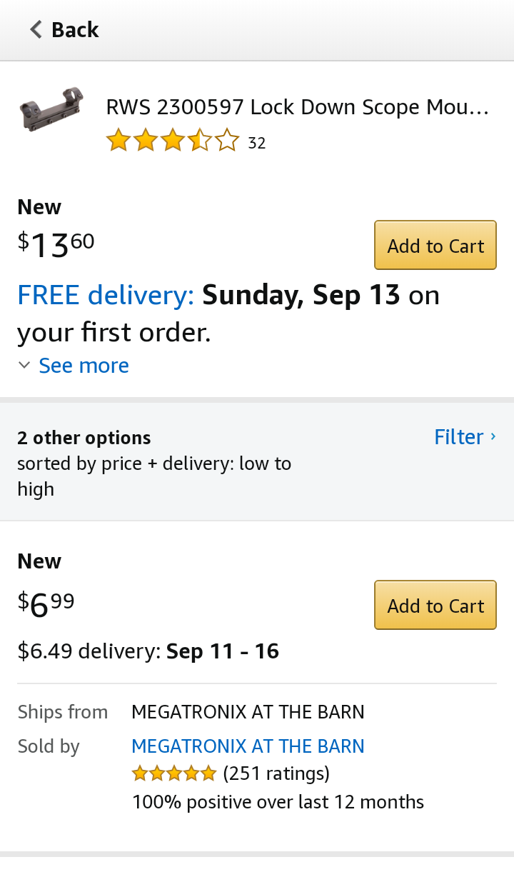

THIS IS REAL CHEAP NORMALLY SELLS FOR $30.00 OR MORE.
https://www.amazon.com/Lock-Down-Scope-Mount-30mm/dp/B003UA9PN0
