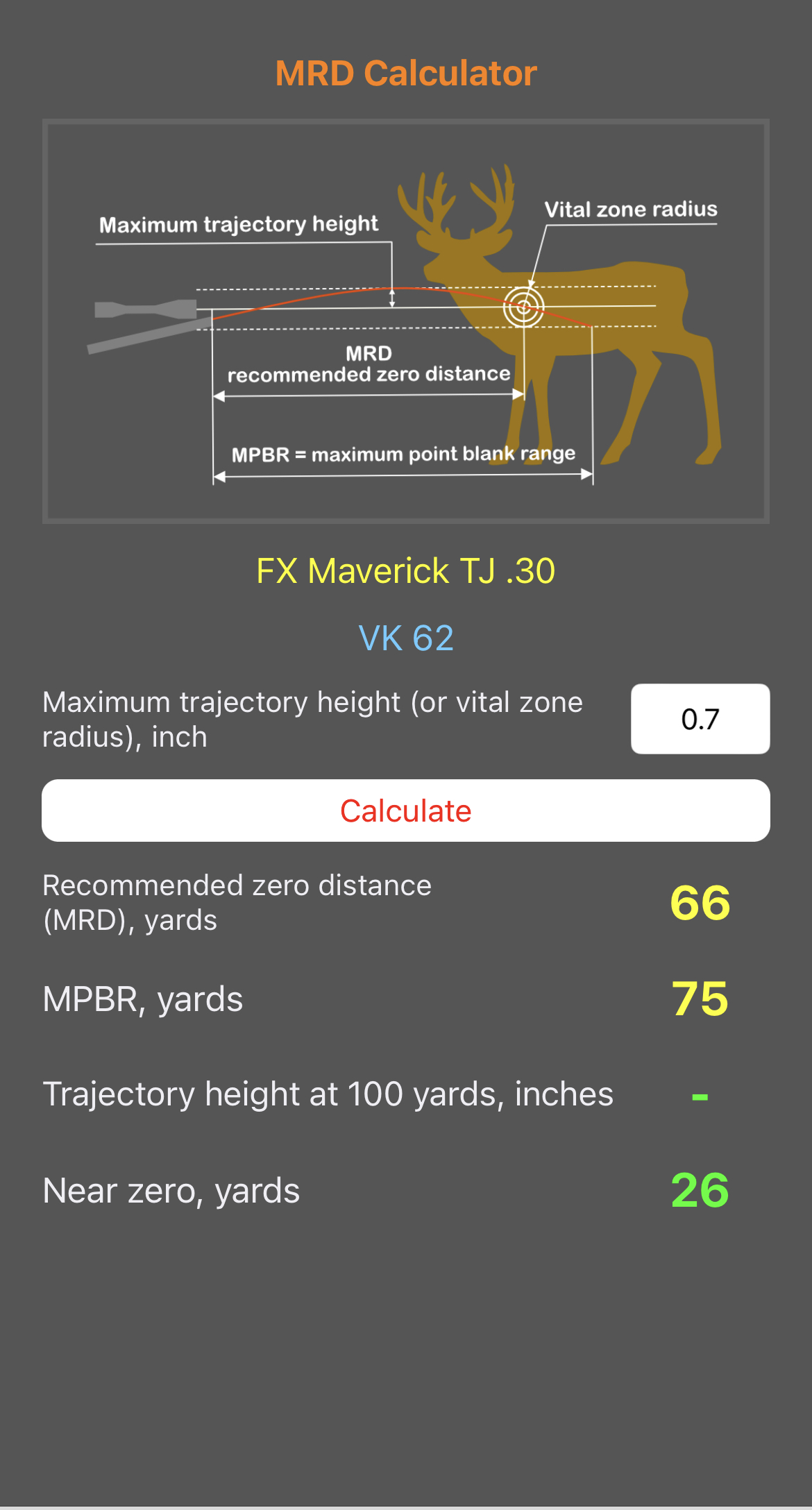

I have 2 rifles that have near identical (+/- 0.7") MPBRs setup that give me a 26-75y shot without holding over or under the vital kill zone. I only have to hold over a tad for 90y in these configurations.

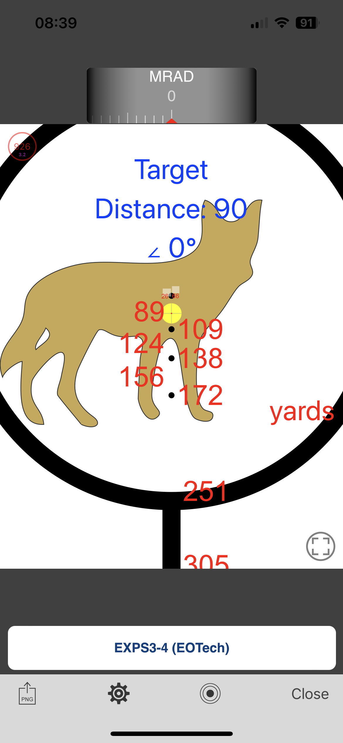

My Maverick is setup exclusively for coyotes shooting hard lead 62gn slugs at 1045FPS. These are the "old style" Varmint Knockers that work well in my 600mm TJ. I have an EOTech on it with the EXPS3-4 ballistic reticle with the G33 magnifier. 90y is probably the furthest clean shot range that I can get on them in the yard from my patio, but I'm very comfortable taking a shot at that range with this setup day or night (I can mount my PVS-14 and ~88mW Luna ELIR-3 laser illuminator to it with QDs in a matter of seconds).

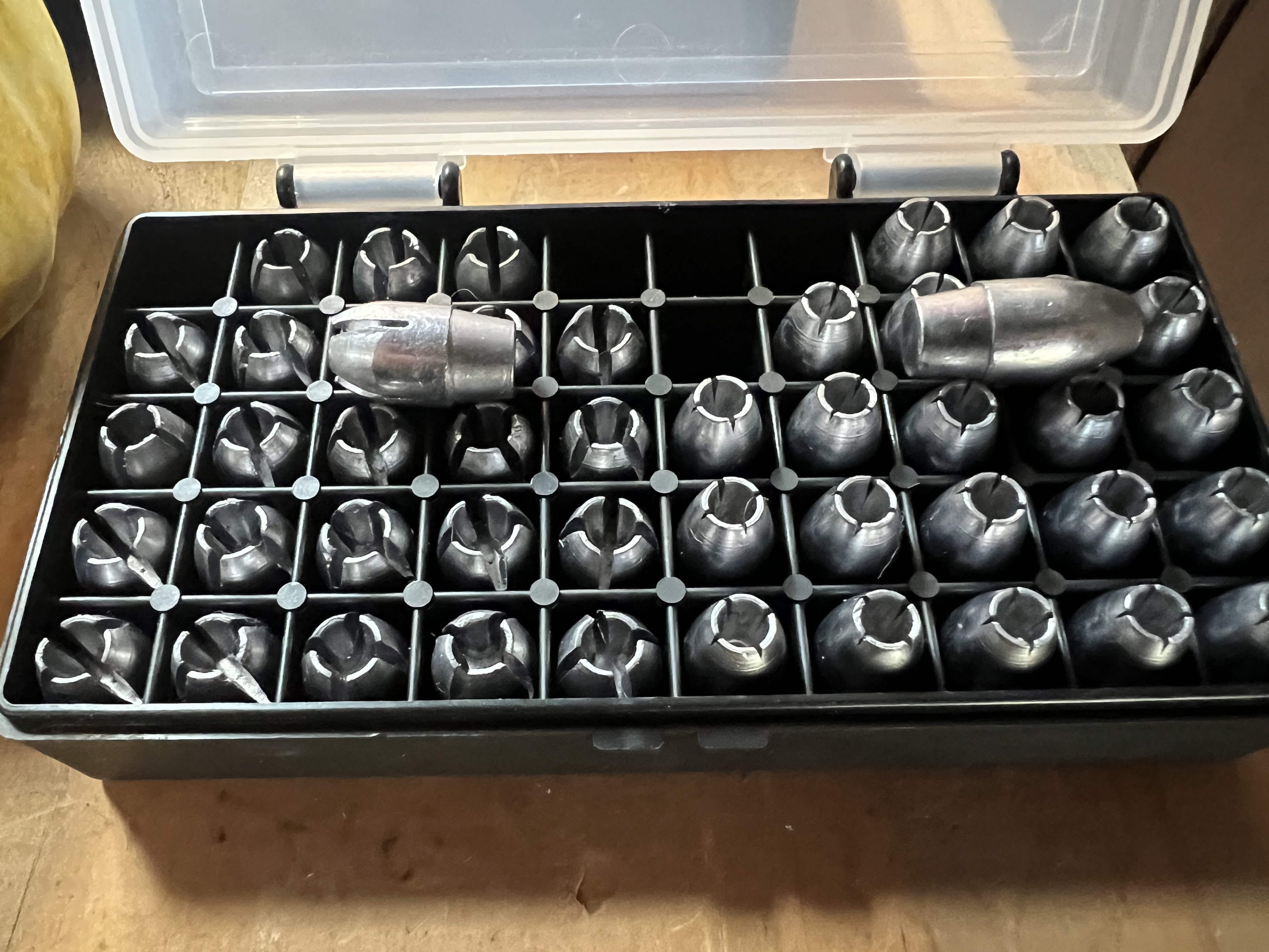

View attachment 410456 View attachment 410457 This ammo is devastating! Meplat diameter is small with a high speed ogive. Excellent penetration, and you hear a "POP" when it hits flesh as it creates a big wound channel. The soft lead expand a bit more, but I use the harder ones because they've worked better with how I lapped and chambered the TJ. The FX Hybrids also make some pretty big holes and shoot really well from this barrel, so I tune for those when I want a higher shot count.

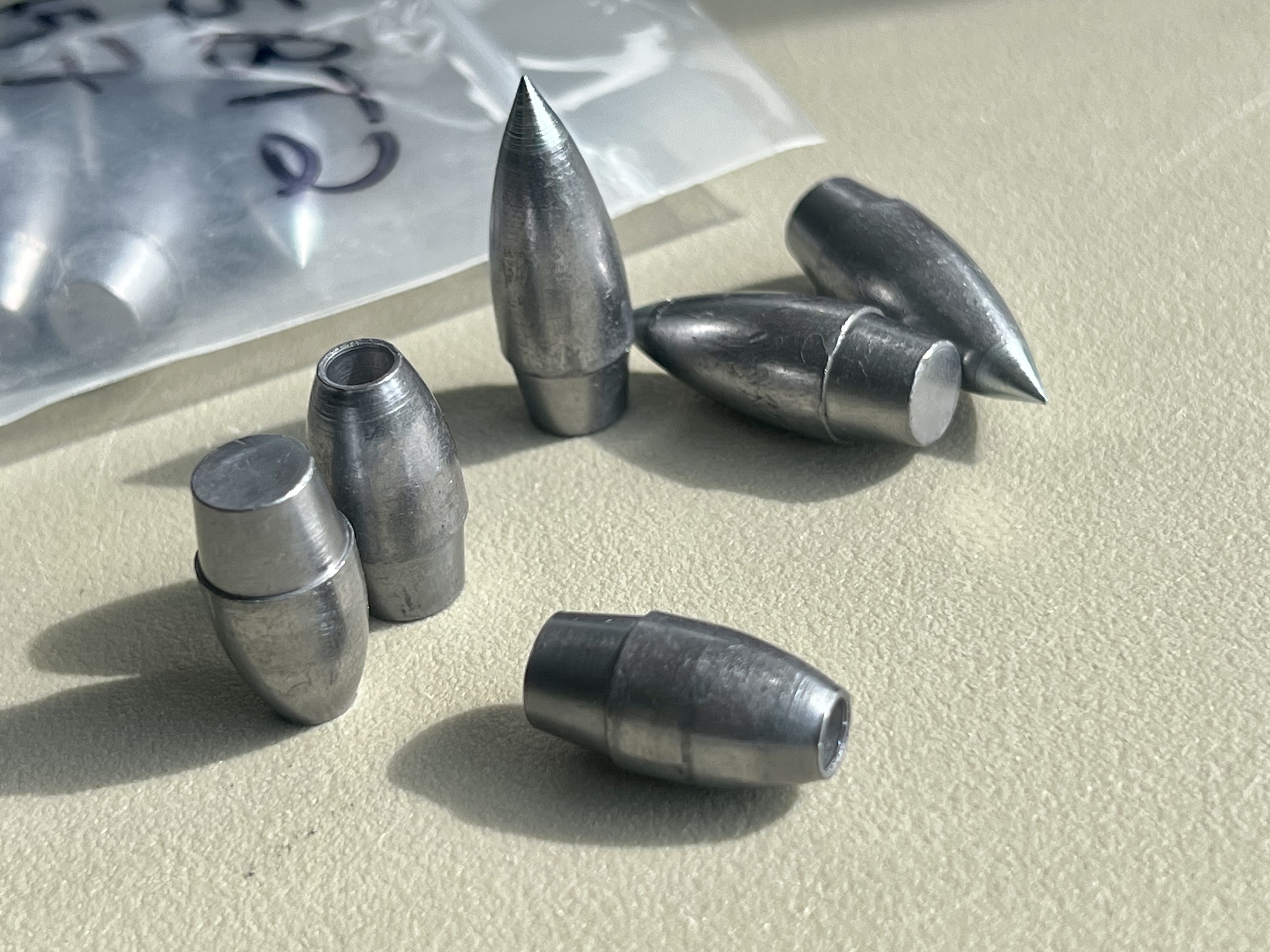

My other PCP hunting rifle is my Texan LSS .457 (TX2) with 228gn WickedAir RBT (split point) at 990FPS. Haven't shot a coyote with it yet, but I can imagine that this ammo will invoke serious carnage!

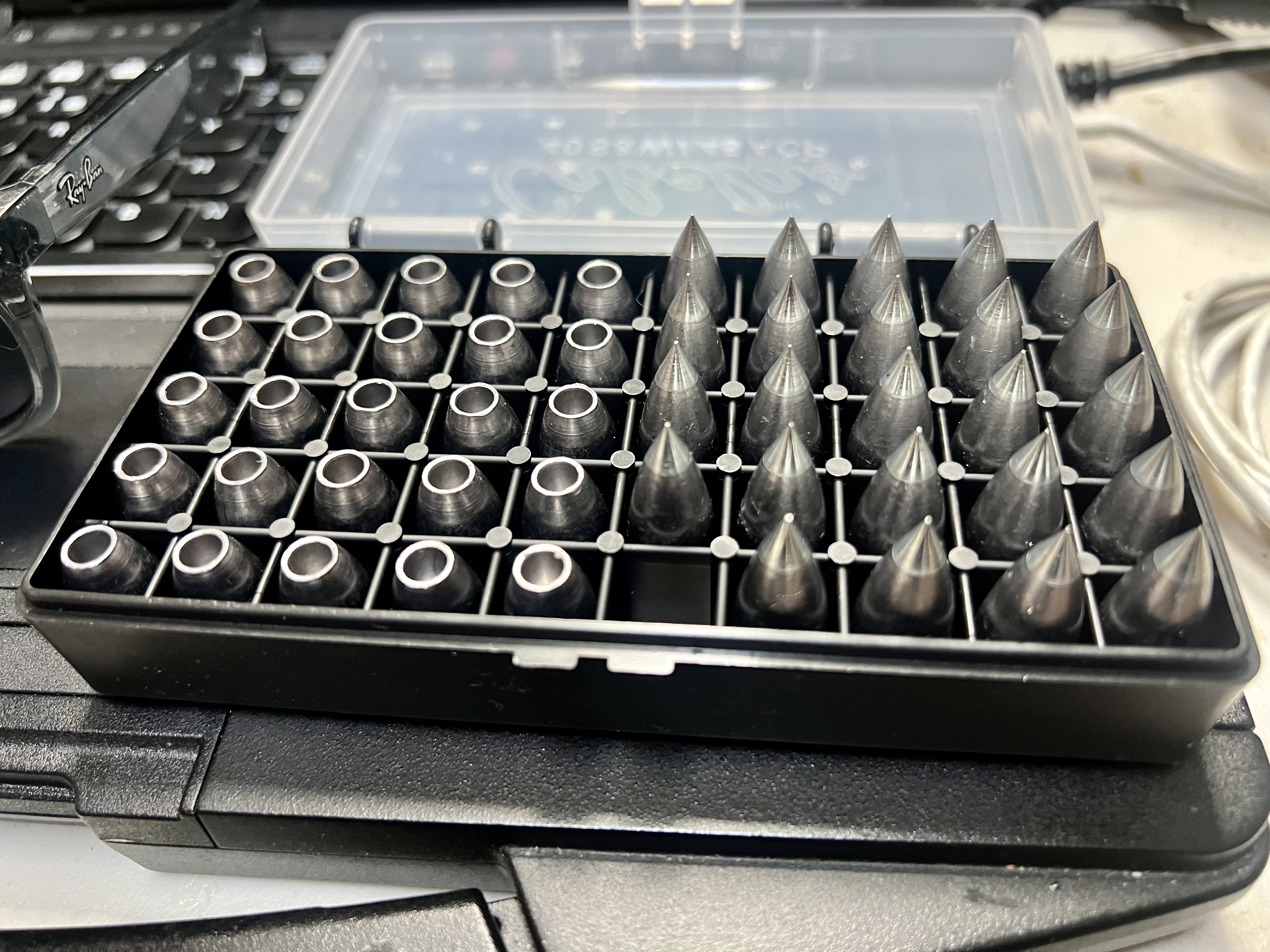

View attachment 410466 WickedAir ammo is currently being sold exclusively through LethalAir, and they're making excellent ammo in .30 on up that shoots phenomenal.
