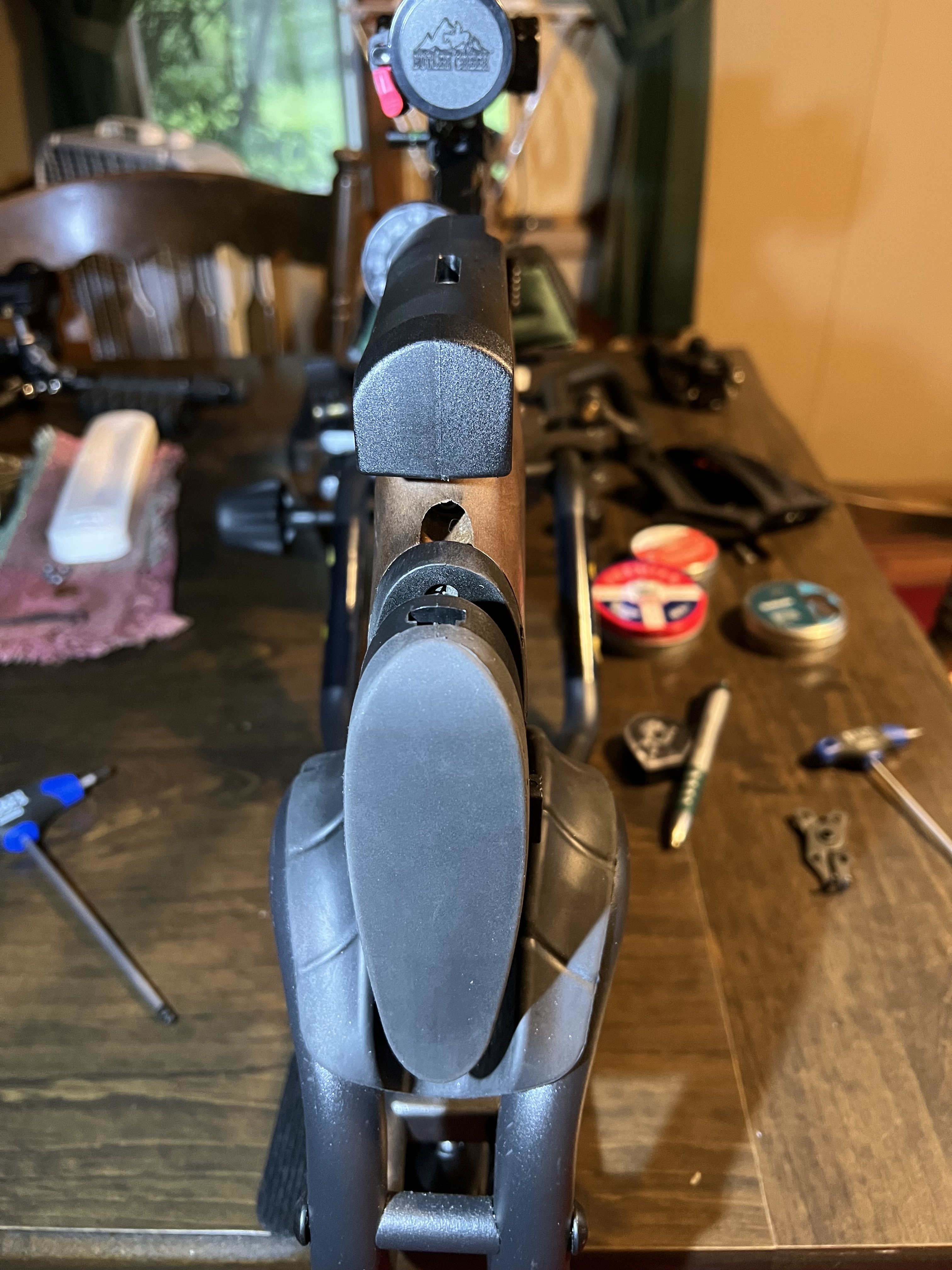

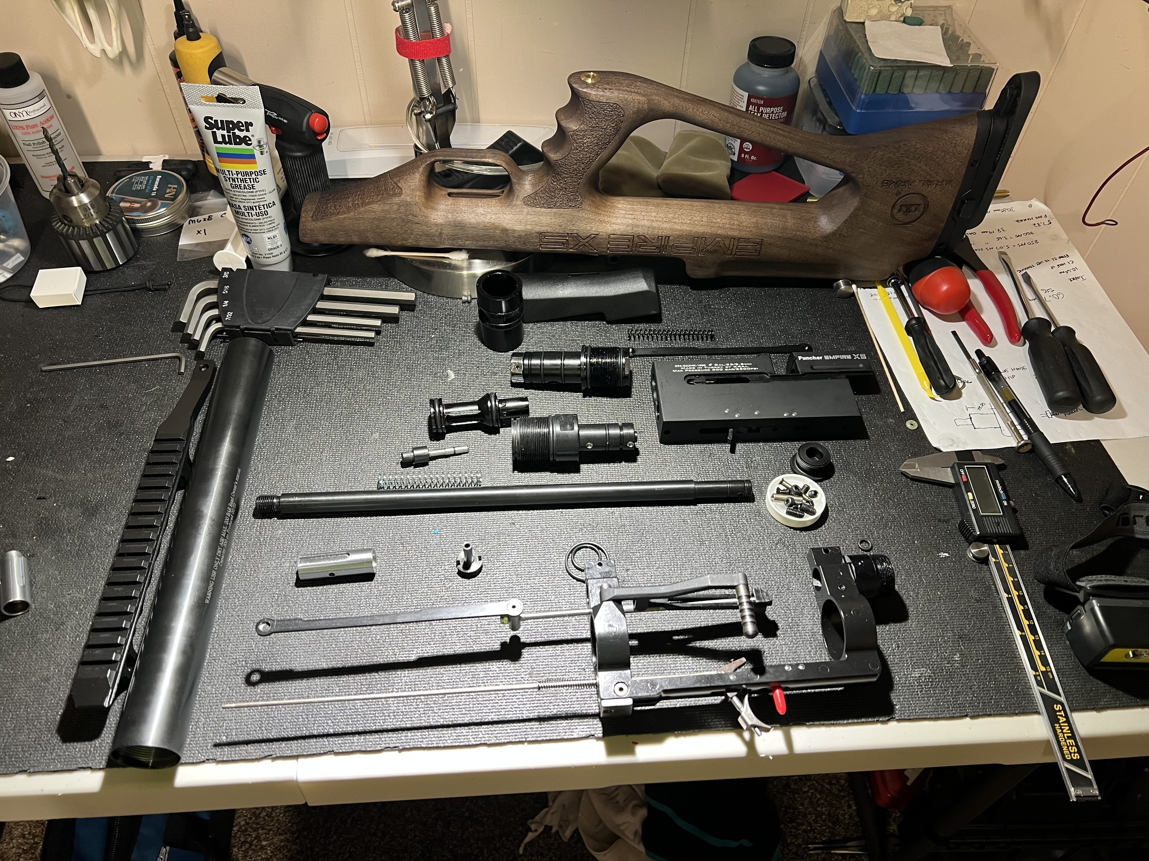

PS somebody posted a picture of a completely disassembled empire xs and I can’t seem to find that post -seems like a useful thing to have on hand.
That was a picture I took the day it arrived and I took it apart. It can’t be ported much. Increasing the power sets off a chain of events to make everything come together. Making a smaller diameter poppet out of better material is part of it. When you install a better hammer spring and have the gun operating at the upper fill limits, you can start having cocking lever popping open issues. But that’s fixable when you make a poppet. Out of the box it’s a gun that’s a light weight pellet shooter and probably with a good shot count once you figure things out with the hammer spring and fill/refill numbers.

Would you mind posting that photo or sending it to me by private message? It would be nice to get a look at the physical parts in comparison to the diagrams and there really is not much online.

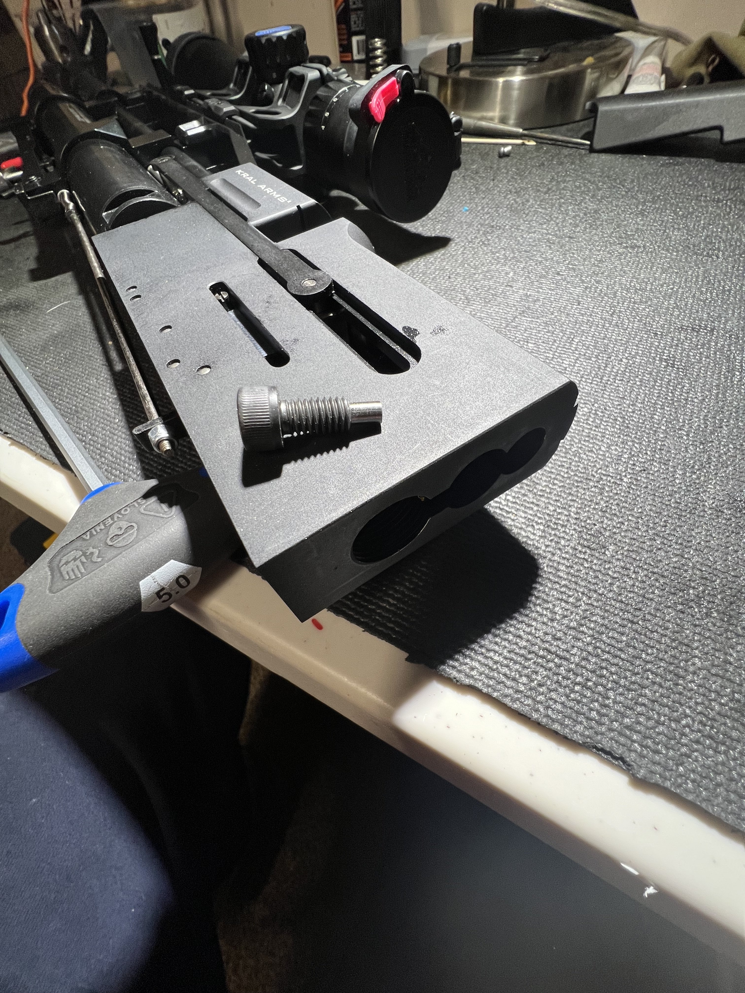

I also had some issues with the scope rail and pellets clipping. So in truth, I just wasn’t impressed with it as an out of the box gun. But after some work, it turned around. Here is the screw I made as a set screw for the hammer spring adjustment. Nothing worse than when the adjustment starts to walk and you can’t figure out why your gun is slowly getting whacky. I eventually built a SSG for it also. I gained 3 or 4 shots with it. I think if you get the hammer spring setting right, you should get 3 mags with a stock gun. The velocity will be what it is.
Reactions: MrP

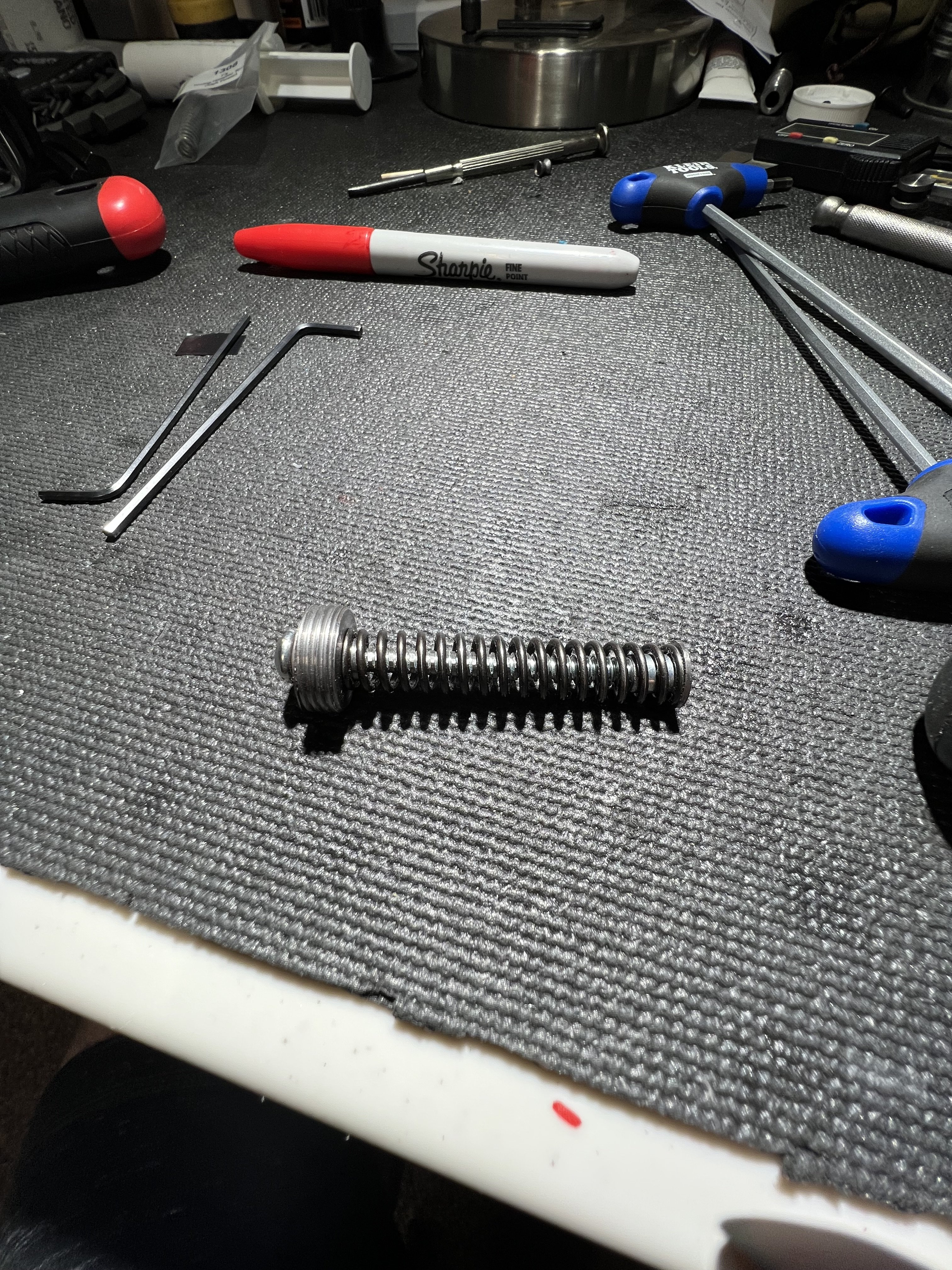

The screw that goes in the bottom of the gun to lock the hammer spring adjuster and that other pic you wanted

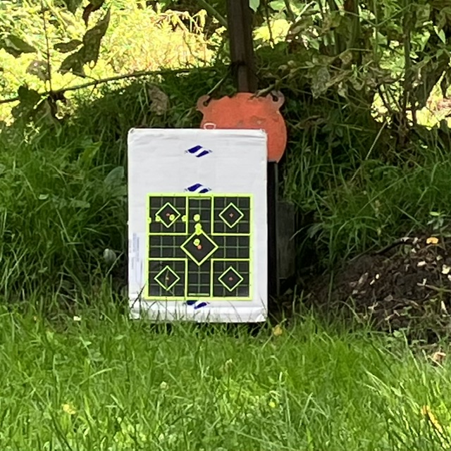

Update: I corrected an issue I wasn’t aware of it first with the scope mount, and put my bug buster on it, which I think should be a reliable scope, compared to some of the other cheap ones I have.
It is shooting perfectly… very easy to get it zeroed in and grouping is as good as I can pull off using shooting sticks.
I posted a pic of the first shots I took getting it on paper and zeroing it in. I was going crazy last night because I was not able to get any consistency and thank goodness it was the scope mount and not clipping in the air stripper.

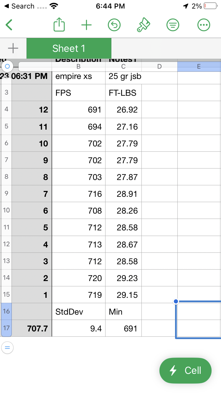

Ok power is kind of low - I screwed up saving the group, but I took screenshots.
What I got with cphp 14.3 grain was a straight descending shot string starting at 874 fps (24 fpe) and ending at 757 fps (18fpe). 200 bar down to about 135/140 for 24 shots
I don’t see how this lives up to the 30+ foot pounds specs (maybe they used heavier pellets to get a higher fpe). Am I wrong that the fact that this is a descending shot string and not a curve means that gaining power by tightening the hammer spring isn’t possible and the spring needs to be backed off.

Yep, your 14.3 shot string is an indicator that you have too much hammer spring. You might think when you fired that first shot that wow, this gun is pretty fast. But you are too hot for this platform. When you get your hammer spring set right, I would think you’ll be 820’ish at the peak of your bell curve. That’s just a guess. Accept the gun is not a hot rod or you’ll have to start with modifying.
