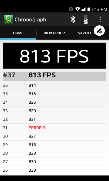

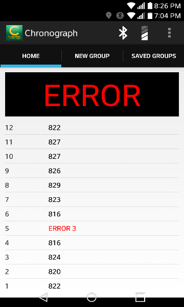

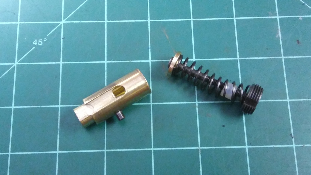

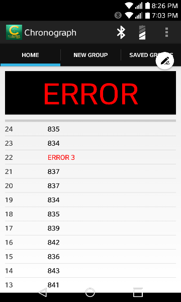

Got around to putting some shots over the crony. To be honest I was really surprised at the outcome. 200cc air tube filled, to 210 bar shooting 14.5gr CPs Home made hammer at 24.5g made out of Ampco bronze, home made SSG, spring is from a Kral np03 with 1&1/2 coils removed. 1mm clearance between hammer and SSG.
Start pressure 210 bar
End pressure 155 bar
I think I'm just going to leave it but I'm open to suggestions and no I am not going to install a reg.
