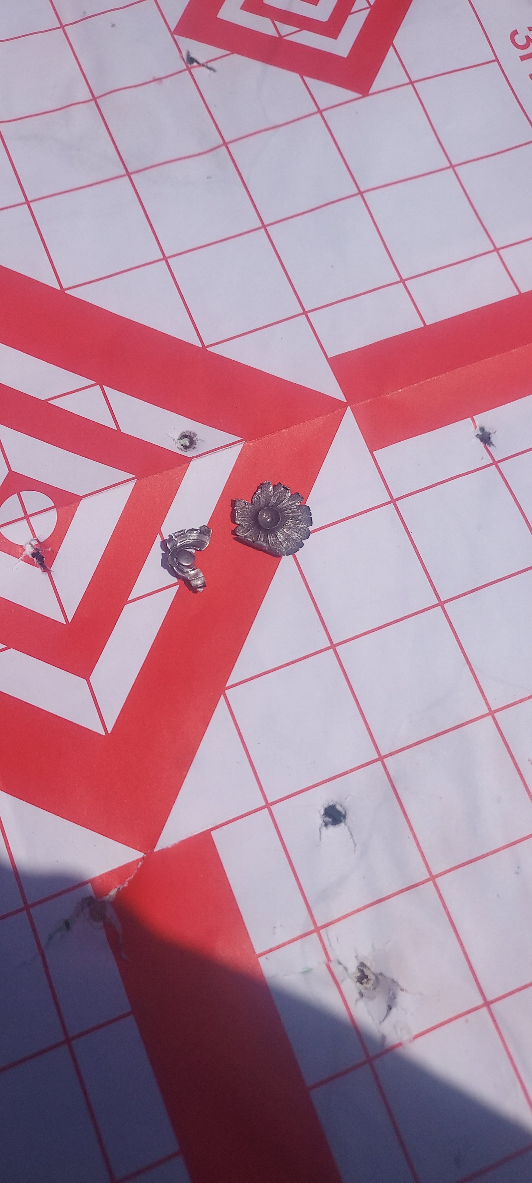

Seneca Dragonfly MK|| pushing 40gr H&N sluggies(I need to chrono) @ 30yrd.
Left side is a good Ole crosman 14.3gr Hollowpoint.
Right side is the 40gr🤩
