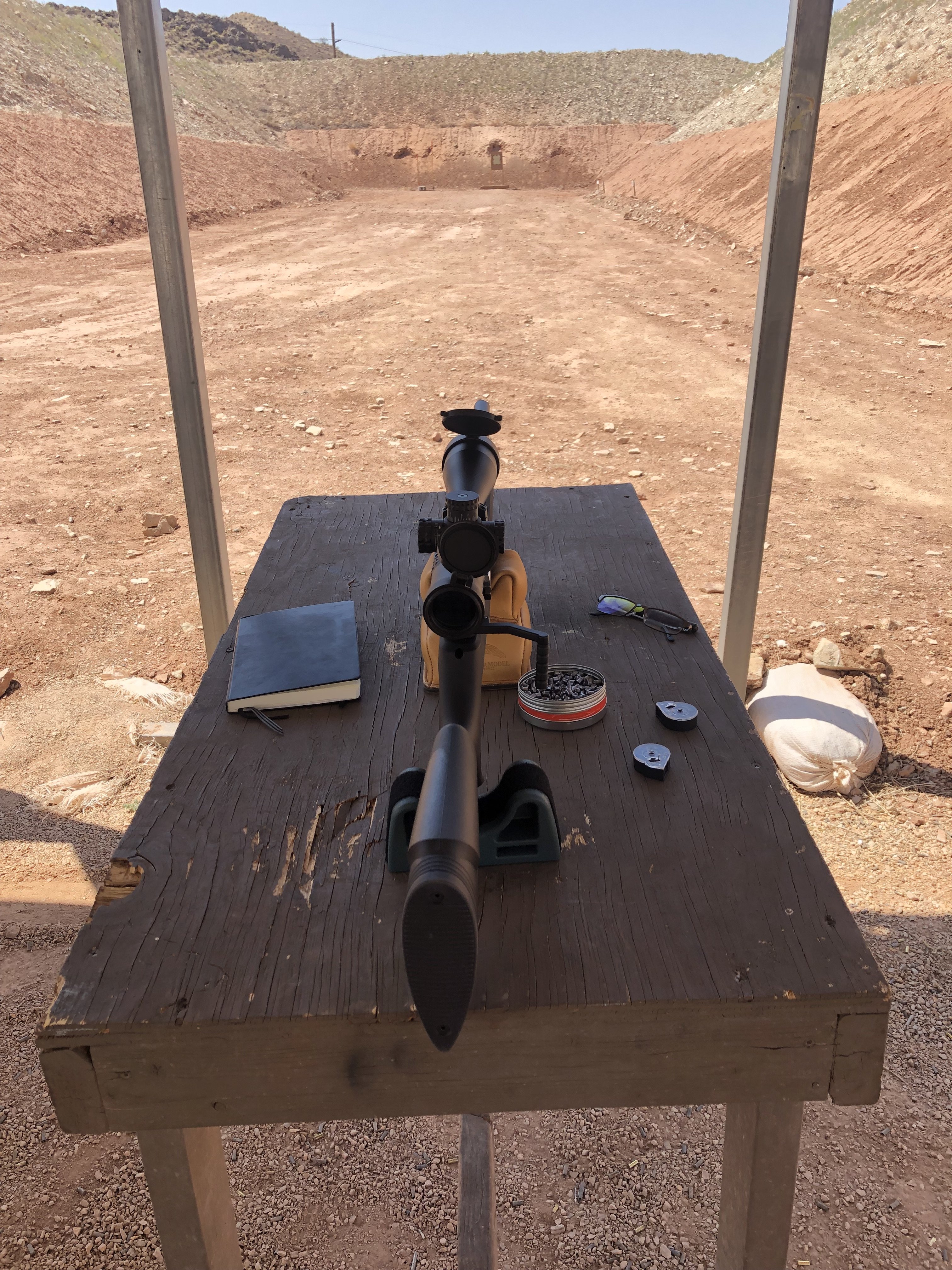

Hi All,
I appreciate your support!
Today was my first day on the range, 65 yards, could keep 3" groups. I was pleased first day, new gun, new scope.
  1. Avenger .25 Refurbished - $286 with shipping
  2. Protektor #13A Rabbit Ear Rear Bag (used as front bag) - $64 with shipping
  3. Plano 1612 Case - $45 with shipping
  4. Vector Optics Sentinel X 10-40 x 50 SFP Center Dot 1/8MOA - $209 with shipping
  5. JSB Match Diabolo Exact King MKII Heavy .25 Cal - $29 with shipping
  6. Four Uncles Hand Air Pump 4500psi - $67 with shipping
  7. TOTAL $700
Usually, when I start a new sport, I try to buy inexpensive equipment until I learn if I will "stick with it." After three days at the range, I can tell I will "stick with the rifle". I also bought a Notos, thinking I might like to try an FT pistol, but that has been less interesting.
Now my question is, is it worth it to upgrade the Avenger or move to another PCP straight away?
I could add DonnyFL 1/2 x 20 Adapter $49, DonnyFL FX Moderator $119, Vector MINOTAUR 12-60X60 GEN II MFL SFP $399, AE Swede Bottle Adapter M18 threads $89, .5L Bottle $40, AE Swede Plenum $30, Sidewheel $13, Trigger $36, adding $376 plus shipping (not including scope). Then I will have $662 into the Avenger. Not sure if its better to cut losses and switch to an Avenger X .25 ($729 with 400cc bottle) or Gauntlet SL .30 ($499)
+ additional magazines (not sure which is the best brand), + chronograph and + gun cleaning kit
I welcome any feedback!
