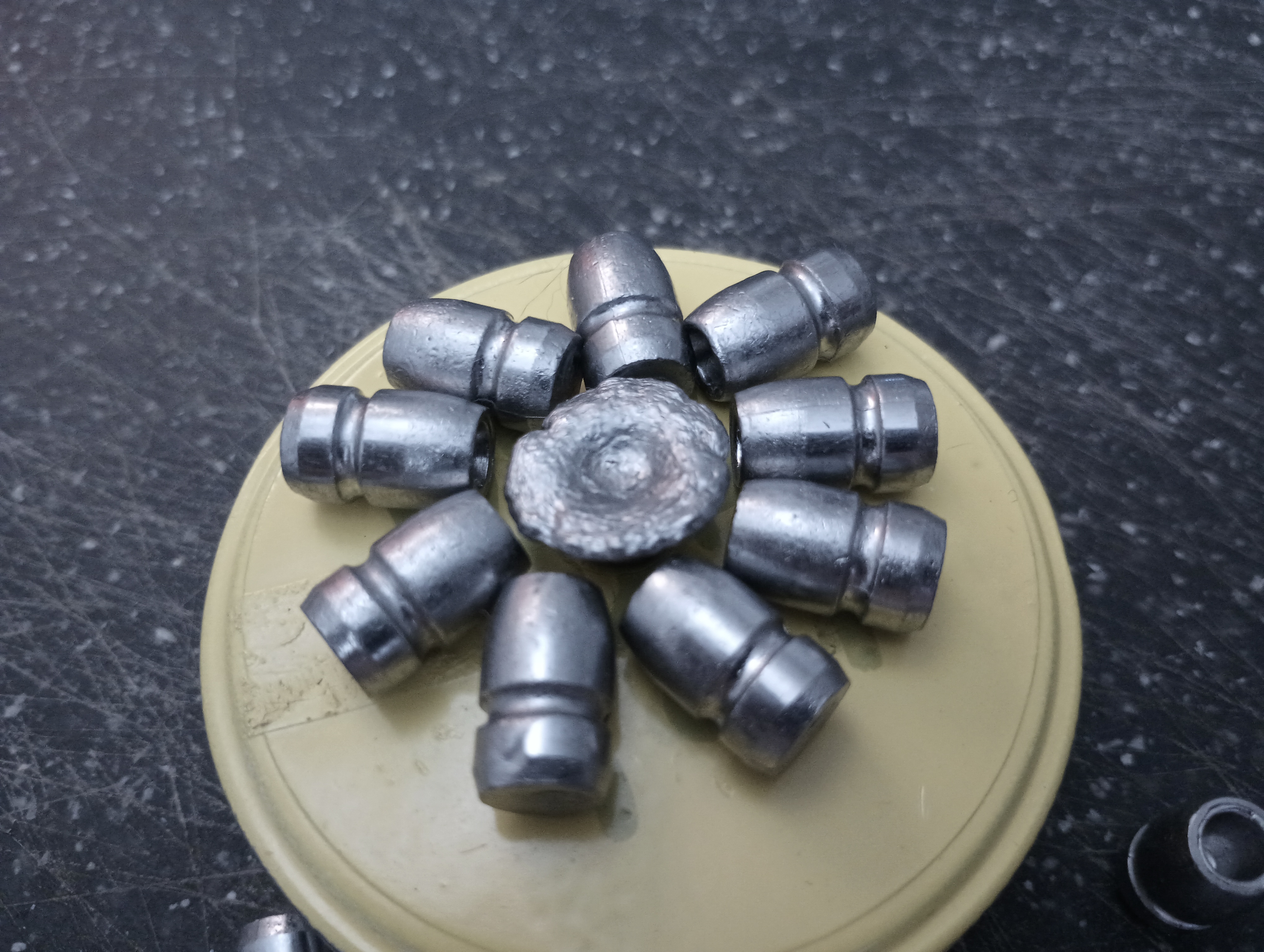

I totally agree and have been casting through four styles of both hollow point, round flat nose and some truncated cones for my 35 Cal.I don’t know if this is crazy, but I actually like sliding the bolt, picking up a projectile, seating it in the breech with my thumb.
One reason is that I cast my own slugs, and I can get a rough sense of the size based on how much force it takes to seat it. Provides one more little useful piece of information for me (about my casting technique and about whether tighter or looser projectiles tend to shoot better).

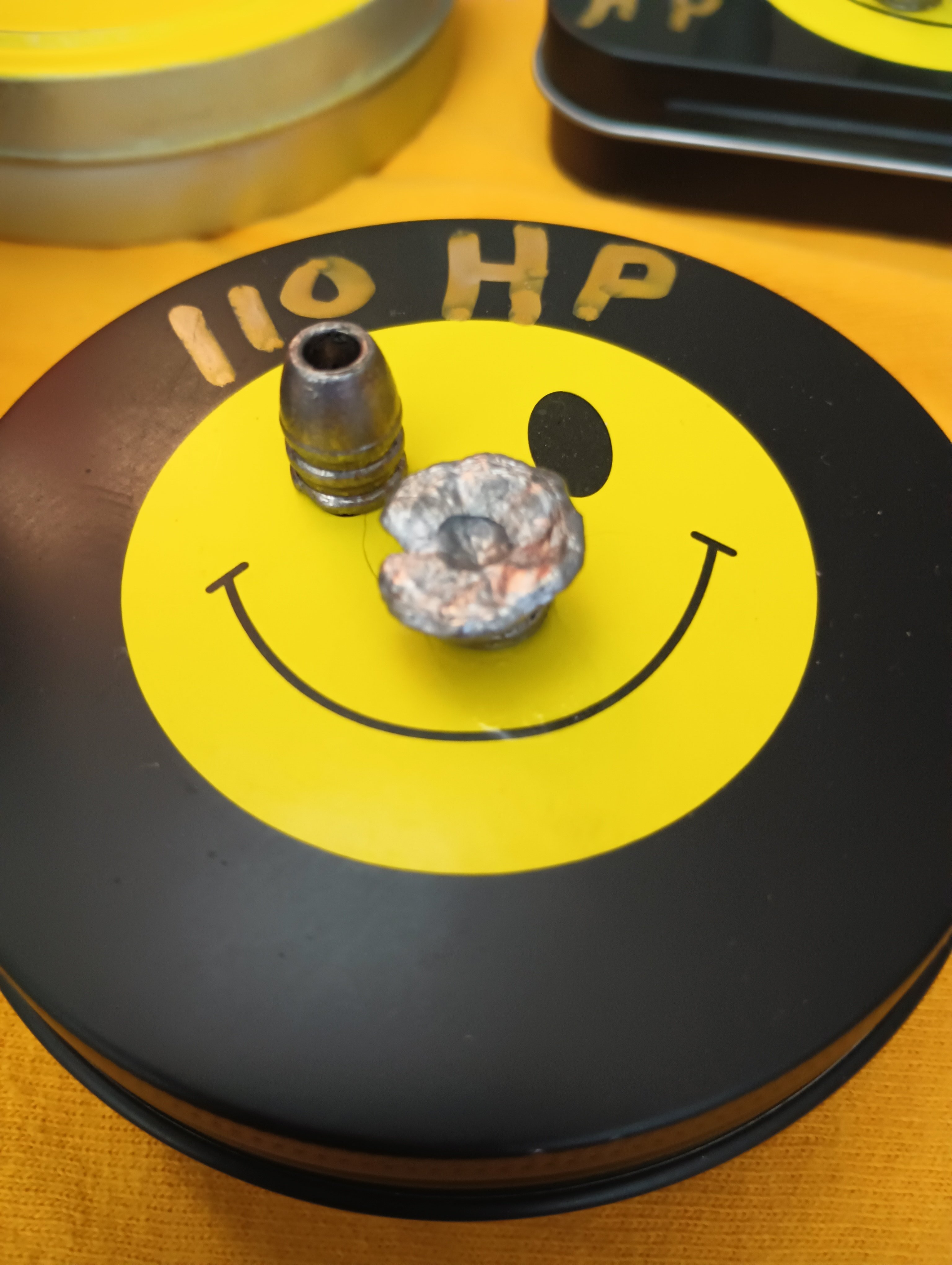

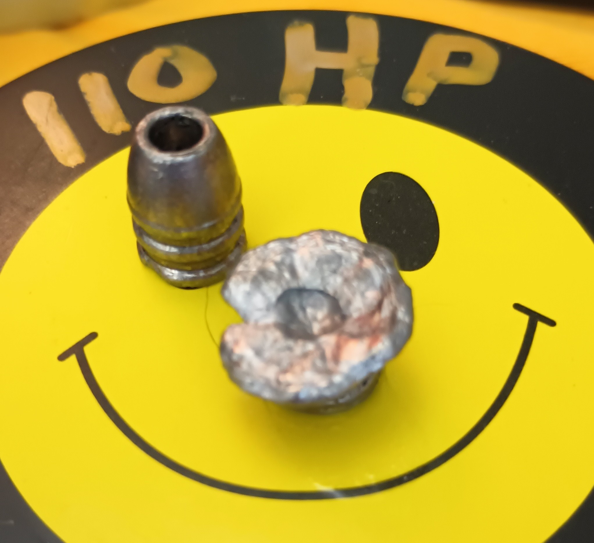

Lyman Devastator 357. I actually have two of them and it's supposed to be 125 grain but it cast 131 to 133 while the other one casts closer to 127 - 129 grain. There's another model that is closer to 145 grain.nice looking slugs - those are 357? i would be interested in knowing what mold they are from.

That's the one #656637 Lyman mold. So what's your platform? Just that most platforms are under 150 ft lbs. Also I found that slugs may have more contactThanks for the information I’ve been looking for something like this.
I found one mold in a single cavity 125 grain .358, placed the order.
The site is called buffalo arms.
I have .357 bushing so it’s nice it it is a little oversized. Sizing them down to .357 will clean up the edges and make sure they’re all as circular as possible. Not that would be able to tell the difference! I’m not a bench shooter and still learning how control my trigger pull and timing and all of that.
