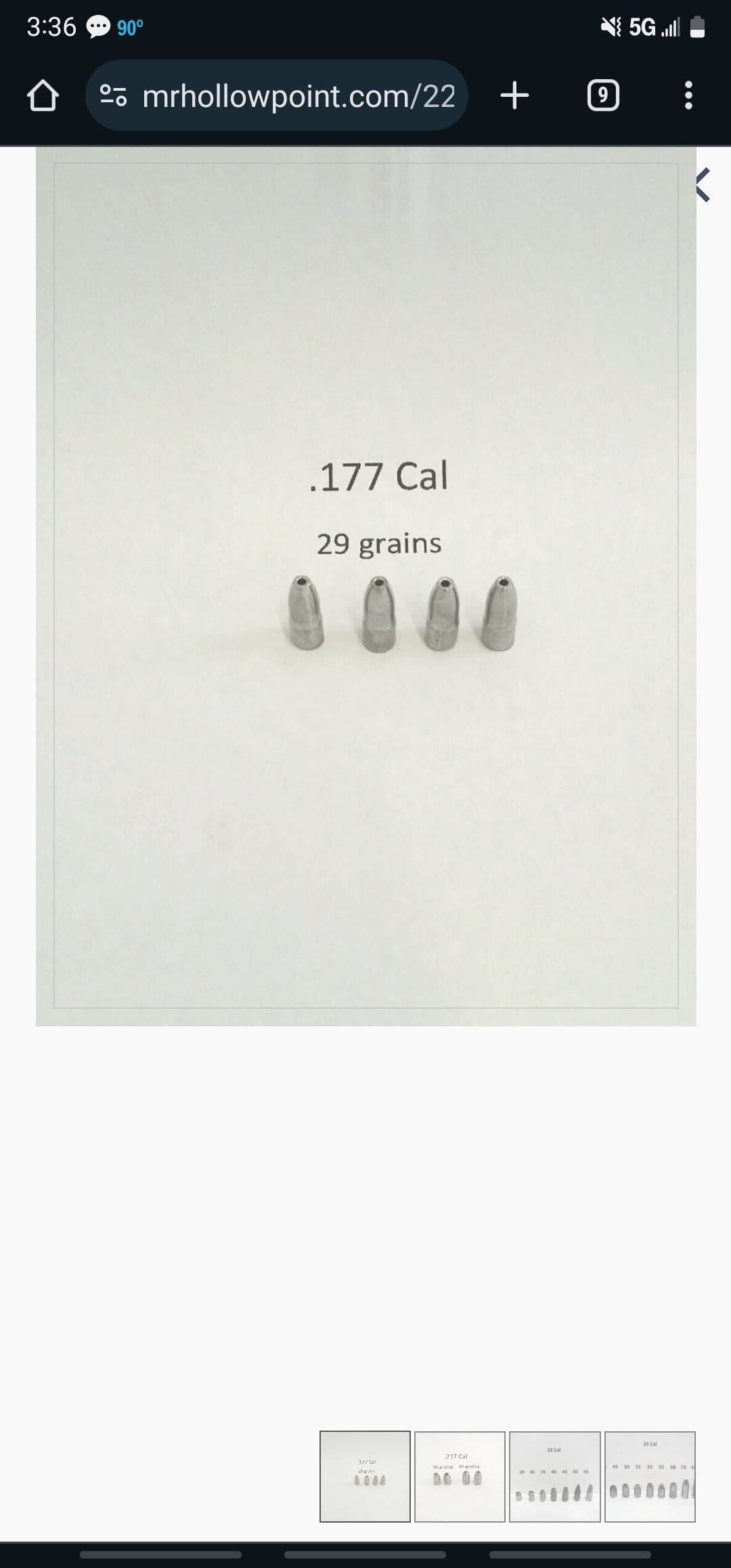

It is! It's also about 950fps with a 29 slug, Mr. HOLLOWPOINT makes 29gr .177 hollowpoint slugs.
Reactions: ZekeZX10
You bought the Epic II? 29gn slug @950 fps = 58.1 ft lbs....that's awesome for .177!!!

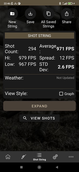

Shot my Two with pellets on Monday, and the CZub barrel did not seem to mind that.
Needless to say i did not attain ideal settings for the 4 weights and 3 brands i had with me, but it did look as if you could find something good it you wanted to. ( 10.5gr - 13.43gr )
Crosman premier domed 10.5 grain was the favorite of the day, even in round #1 where they flew +1000 FPS, and even more so in Round #2 where i had fallen back to 970 fps for those.
I will for sure have to get more of those pellets as i only had 2 tins in my collection for testing purpose.
I will of course also have to try even lower speeds, my last session was with the REG set to 63 BAR, unsure how much lower i can go and still get good regulation.'
Long string of crosman pellets.
A few entries are deleted from the string when i forgot to do a few air shots after a break, CUZ otherwise the first shot will be a little fast ( 986 FPS or so )
It take a while to shoot 300 shots, also when you hit a 6 mm red dot on a 2 " target at 100 yards with a .177 pellet, well at least this shooter have to do the victory dance even if it was pure luck CUZ otherwise it was pretty damn hard to hit that target and i only got 4-5 shots in on it out of maybe 30, but it was so dark i could not see where i missed so not really able to do corrections based on knowledge. Also that speed is probably still a bit high for longer range, but 50 M it was like laser and i was cutting grass and branches off a tree shooting at a 30 - 40 degree up angle.
Also i was zeroed for 30 M so used a lot of holdover on 93 M / 100 yards.
972 fps was a speed i heard often from the chronograph.
Reactions: Ranchibi
