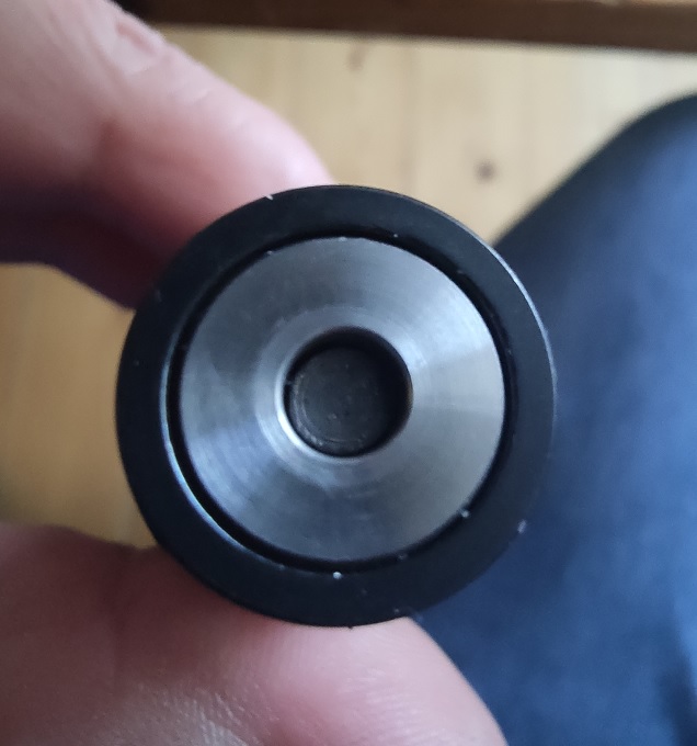

Shooting without the suppressor did not make any difference in my case. I removed the tension from the barrel system but I still waiting to try it

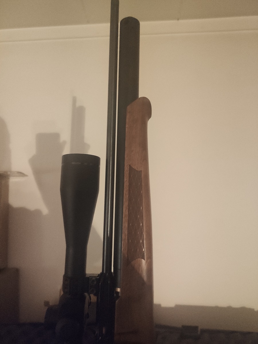

My air tank always ´maintain the 3 - 4 mm distance to the barrel, and is parallel with it.
I am shooting tethered but the tether is down so if anything it should pull air tank / pipe away from the barrel above it.
Also micro bore hose i use so not really any pull on things.

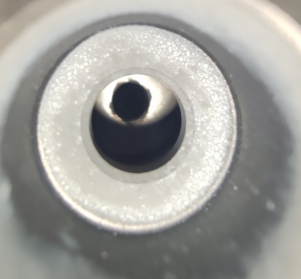

Just looked at the danger end of the rifle, the exit look strange, well at least compared to the feed end where it pretty much just look like a round hole.
The pic do not do justice, by eye the exit look like a elongated hole
Maybe you can try to wrap some paper around the air tube and fix it with tape and then shoot it a couple of 50/100/150 times. If the end of barrel do touch the air tube when being shot, the paper do get marked or damaged.
I would be more inclined to just remove the shroud and shoot the bare barrel free floating, then for sure nothing touch as there would be 10 mm if not more in between.
My .22 Cyclone have things just as close, and even decked out with a powder burner mono core moderator it never had any such problems. and it dont even have the additional stiffness of a shroud / tensioning system.
The exit has a crowned end and looks legit (y) :)
