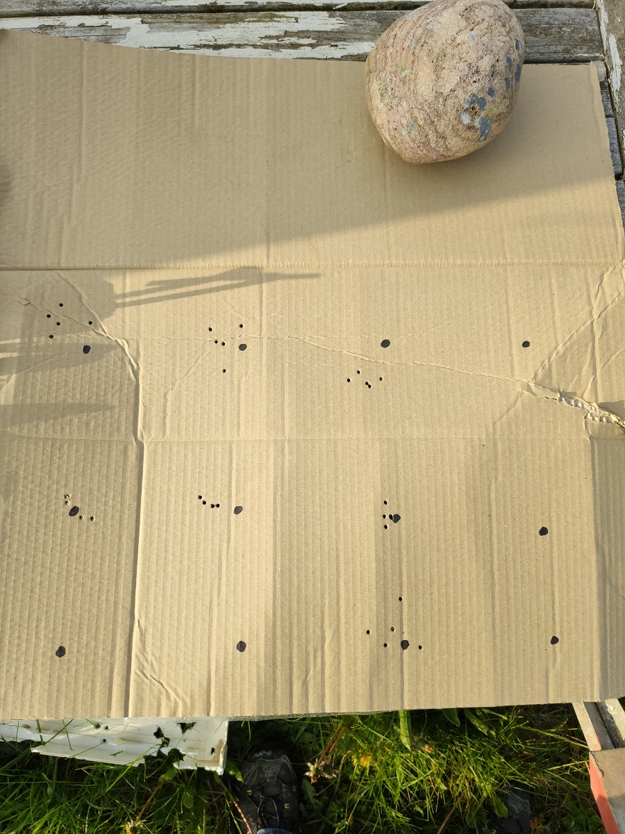

Okay so i shot the Two a little yesterday but only 50 M and in winds i would not ever consider shooting in, 15 MPH average winds and 30 -31 MPH gusts,,,, and lots of gusts, low pressures doing battle in this here part of the world.
Anyway all things considered, it is very easy to see what groups i just fired off as quick as i can, and what groups where i minded the wind.
And by minding the wind i mean judge by the creaks and moans the old shot shed have when it is hit by wind, i do not have a single wind flag at the range.
So it would seem i can airgun again,,,,,, my problem just is i have no idea why that is so, or what happened to make my Two a scatter gun in the previous 2 outings,,,,,, and that is annoying as hell.
My L/R of the scope was dialed for not much wind, and as it was R to L i would assume a L bias, and i also see that.
Also see a little down, and i am shooting up hill a little, so if a projectile are pushed down on windy days i would not be surprised,
So ! Back in business and now eagerly looking for a day with mode moderate winds, and the 10 MPH average i saw yesterday, well that is the gust speed on the days where i really expect something from my shooting.
5 - 15 MPH winds i can deal with, or live with CUZ TBT i dont really do much wind compensation, but i can click my scope to where it is in a " best of both worlds " setting that just let me aim directly at target.

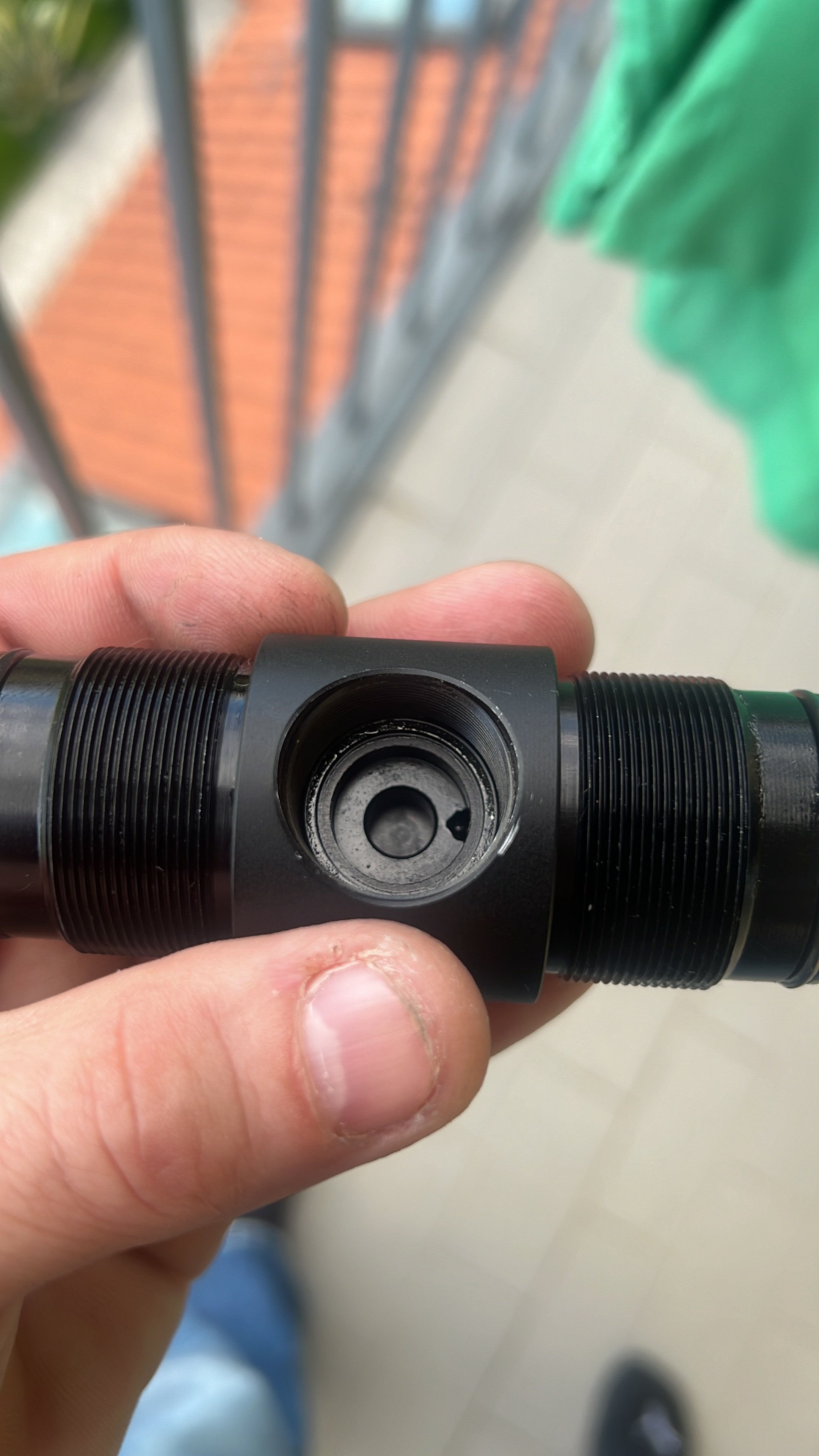

Yesterday I finally received the new updated Reg and valve, thinking the Reg was the Culprit because the Reg pressure was matching the bottle pressure. installed both of them but the problem was still there and to be honest I felt a bit frustrated.
This afternoon I received also a tutorial were Epic was showing how the Reg was installed ... and everything was fine until I showed to them how was the set up and finally the solution came out: the piece in between the tube and the plenum which I call the Reg holder, was installed upside down:rolleyes: ( the hole you see in the pic must be positioned to your right side for obvious reason but I never noticed something was wrong)
Until now I got unmatched customer service from Epic and David Hanusek.I'm very pleased,
Tomorrow I still have to fix the problem I had with the barrel too close to the tube but tomorrow is another day:cool:
There should be a laser engraving behind the sealing O-ring that said " this side forward " or something like that.
Or as i have suggested the fill port should also be in this piece instead of all the way out front.
My regulator seem to be doing what it is supposed to do, but epic have suggested sending one, and valve housing too, but to me at least and so far these parts seem to be working as they should.

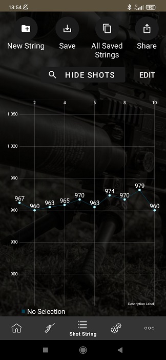

So my regulator is not doing what it is supposed to do, CUZ below 100 BAR it is next to impossible to get a flat shot string, but go to 110 or more and BAM and you have a shot string that is literally flatline.
So <100 BAR and you might get 3-4 shots at the same speed but then ´the speed would fluctuate, hell i even saw one time where the speed just climbed 30 - 35 FPS over 3 shots only to drop way down to where it was.
But the norm trying to shoot modest pressures of 90 - 100 BAR was just a irregular shot string that might be 10 - 15 FPS between fastest and slowest shot, and on the Two as it is now that seem enough to make POI change where as my Maverick feel a bit more forgiving to shot speeds that fluctuate a little
Of course when you have only brought 13 and 12.5gr slugs for your outing, this mean things will fly really fast, and while you can dampen things a bit with less hammer, then you dont get far before the more relaxed hammer make the shot string not flat.
Funny thing though, the Two seem very speed sensitive, so with a not super flat shot string, i would shoot 2 hole groups - 3 if it was a bad one, but at one speed the slugs would land at "A" and then a slightly slower shot would land at "B" so when my chronograph was reading out speeds i was way ahead of it just calling it by where the shots landed.
Another funny thing the 12.5gr NSA slugs did alright at 1081 FPS, though there was some POI chasing CUZ it is for sure not the ideal speed for those, but i did manage to put more holes in 2" targets at 80 M distance VS last time.
Sub 100 BAR shot string standard. ( 90 BAR ) Hard to get just a little more flat than this.

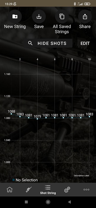

+ 100 BAR shot string standard. ( 120 - 130 BAR )
And this is including the first "hot " shot right after REG pressure change, NIX the 1088 FPS and it would have been a really nice string.

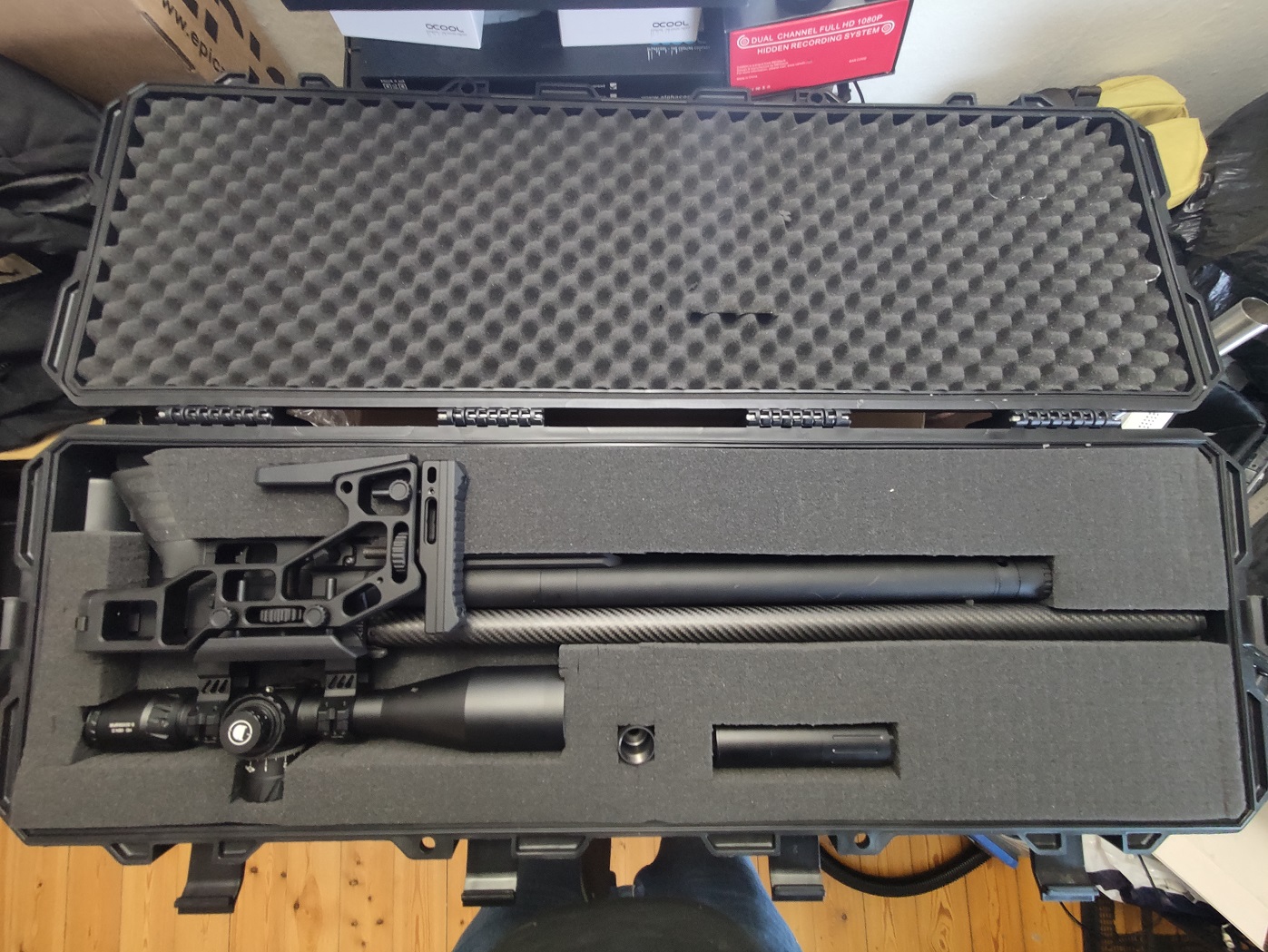

Okay so i got a little burned on the case i ordered for the Two, the listed measurements are the very outer most measurements and not the size of the compartment of the case.
So the one i ordered are barely able to do the job, for sure not have the adapter for the moderator installed on the barrel.
But i still made it work, just not as planned, but for transport to / from range it will be fine, but i would not ship my rifle anywhere like this, for that to work i would need at least 50 mm / 2 " foam all around to be able to feel good.
As i have cut so much into the form, well i will have to glue it into the case CUZ it have a tendency to want to follow the rifle out of the case when you take it out of there.
PS. IMO the matte surface on the Two, make it VERY susceptible to scratches, mine already look a bit banged up.
