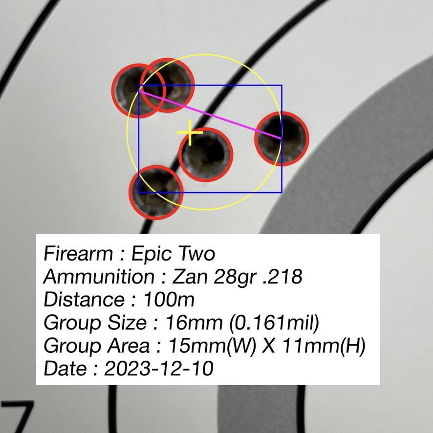

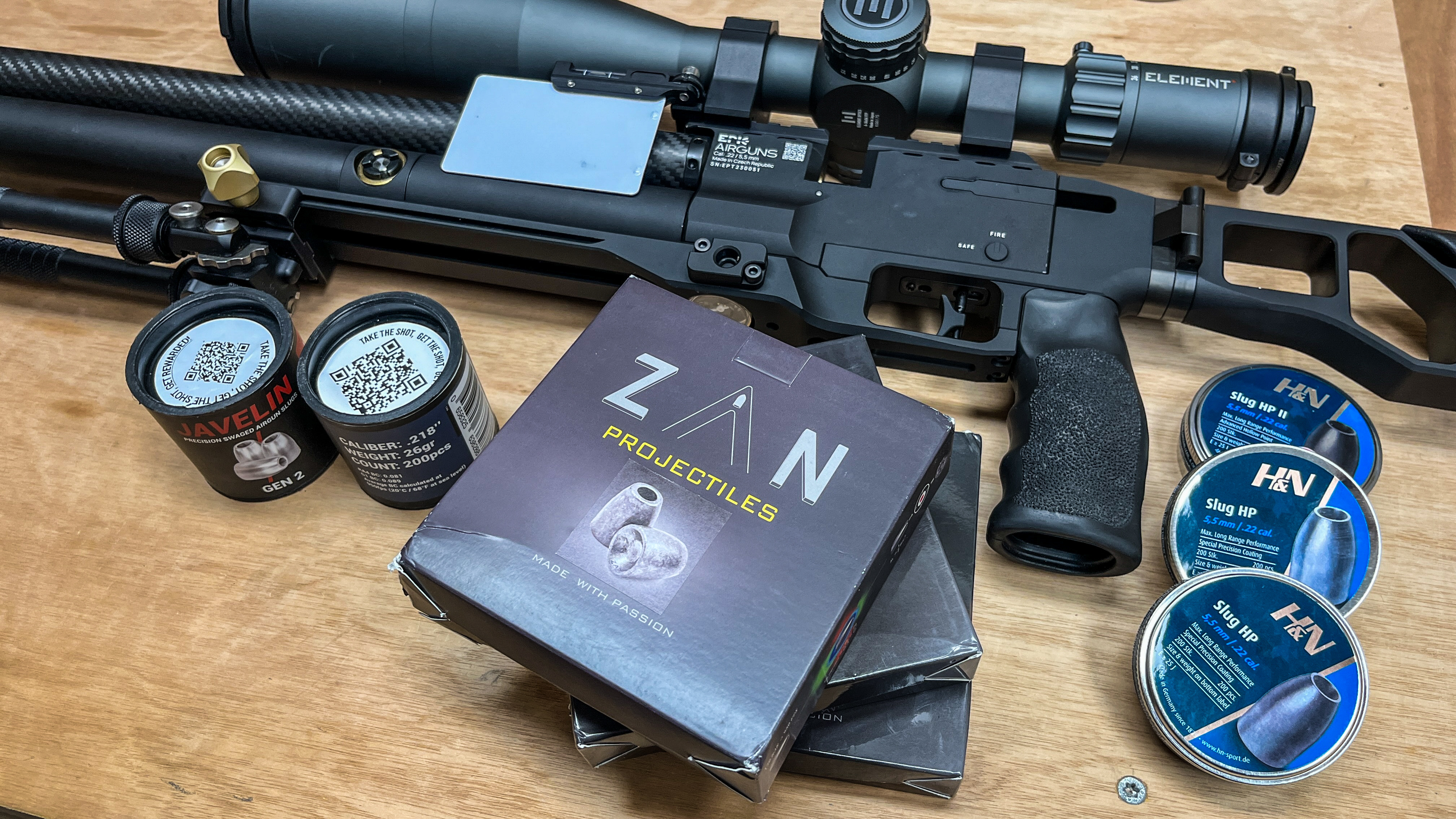

Took my Epic Two to the range last wednesday and continued testing slugs. Previously I found that I needed .218 sizing in the CZ barrel but this time I started testing which weight range will work in this barrel. I went from 25 grain to 34 grain and here are the results:
The range from 27 grain to 34 grain worked best. Haven't tested slugs past 34 grain since the maximum velocity at 180 bar was around 285 to 290 m/s. All slugs from the pictures above were around the magical velocity of 290 m/s (950 fps). Have to shoot way more groups to prove their consistency over large shot strings but the results of these quick tunes got me excited 😁
