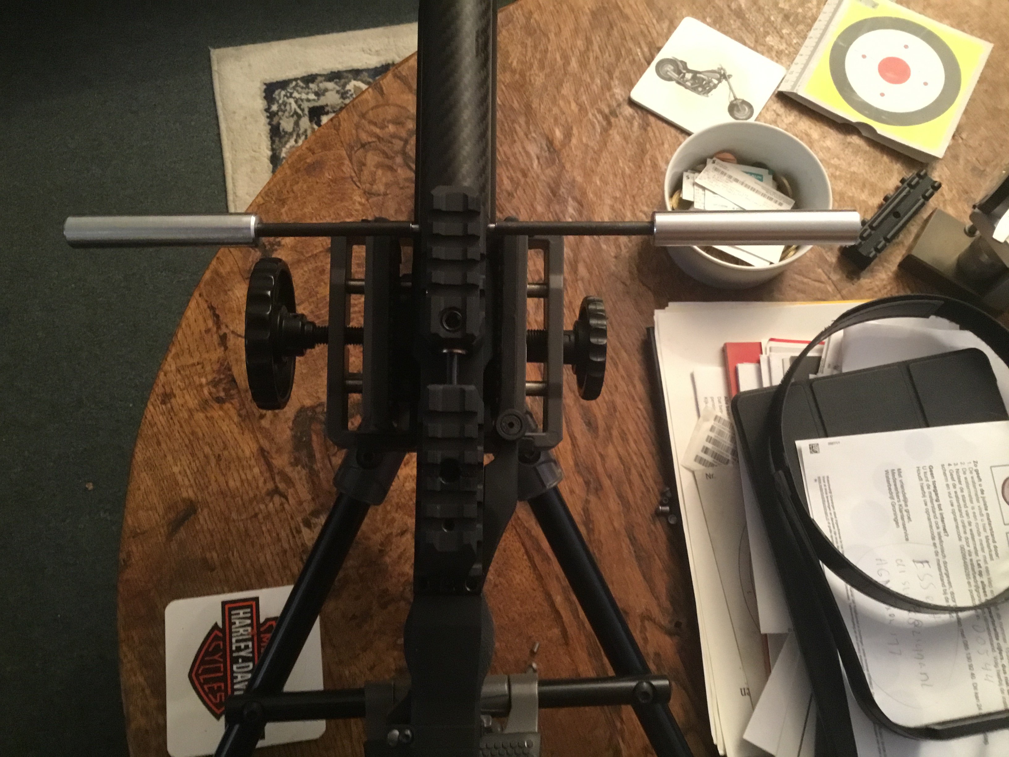

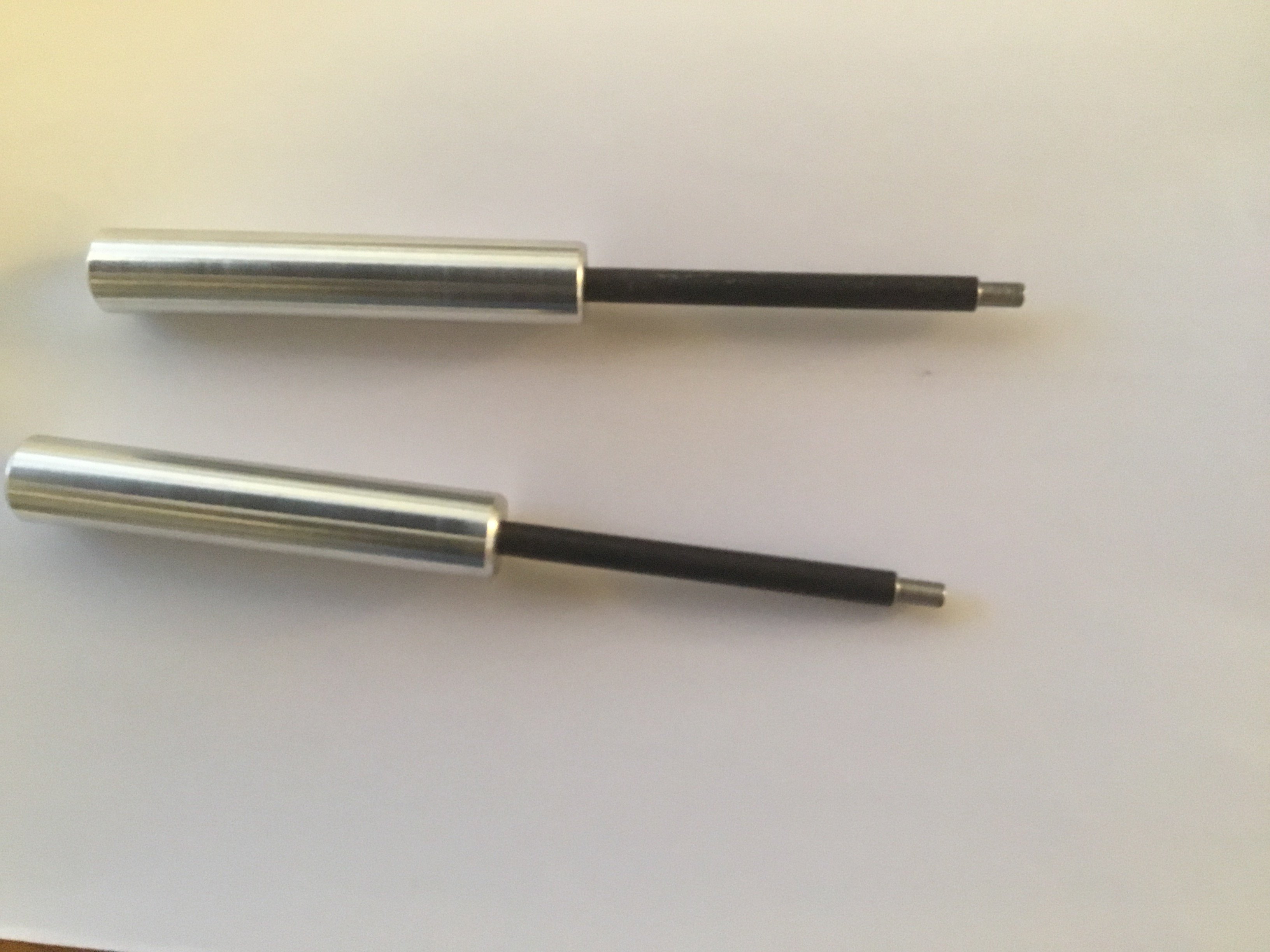

Did that, punch bend…….. gonna make an U formed tool with pins at 180’. Heeft daar een Tjech aardig op staan leunen 🤓😁👍

With the tool I made it is a breeze to get the barrel out. As I have no means to measure the tork I do it by feel. Have a bit of experience in using tools……… I use Molykote. When I had it out the first time there was oil on it.

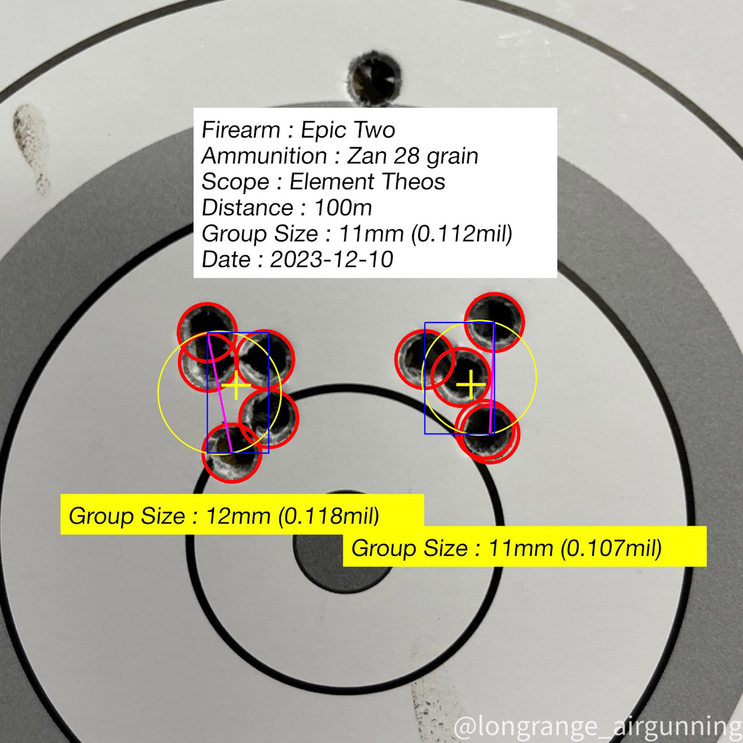

I have no idea what that french guy was doing but it's not hard to get within 5 cm at 100 meter with the CZ .22 barrel :eek: Even smaller is not hard when using .218 at about 290 m/s:

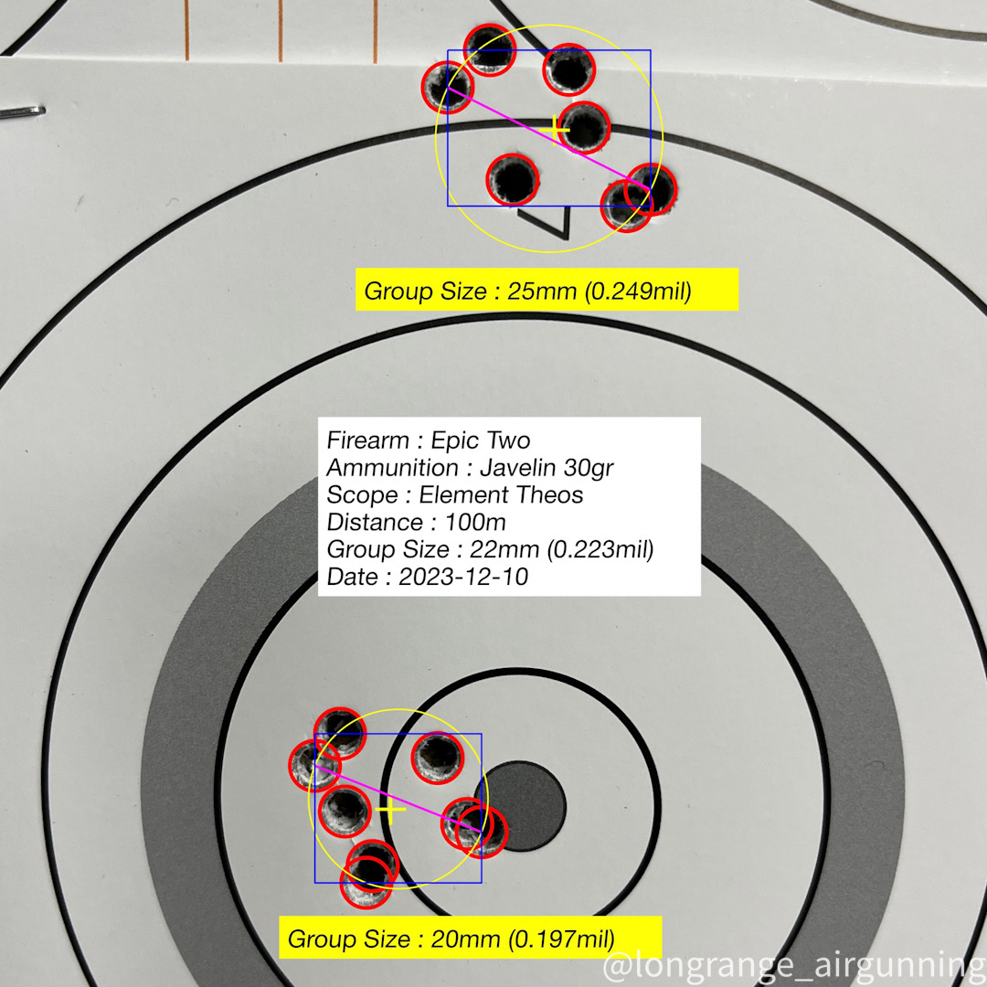

Did very well with Javelin 30 grain slugs as well:
This was done with the CZ barrel. I'm now moving to the LW barrel to continue testing to see what is possible there.
