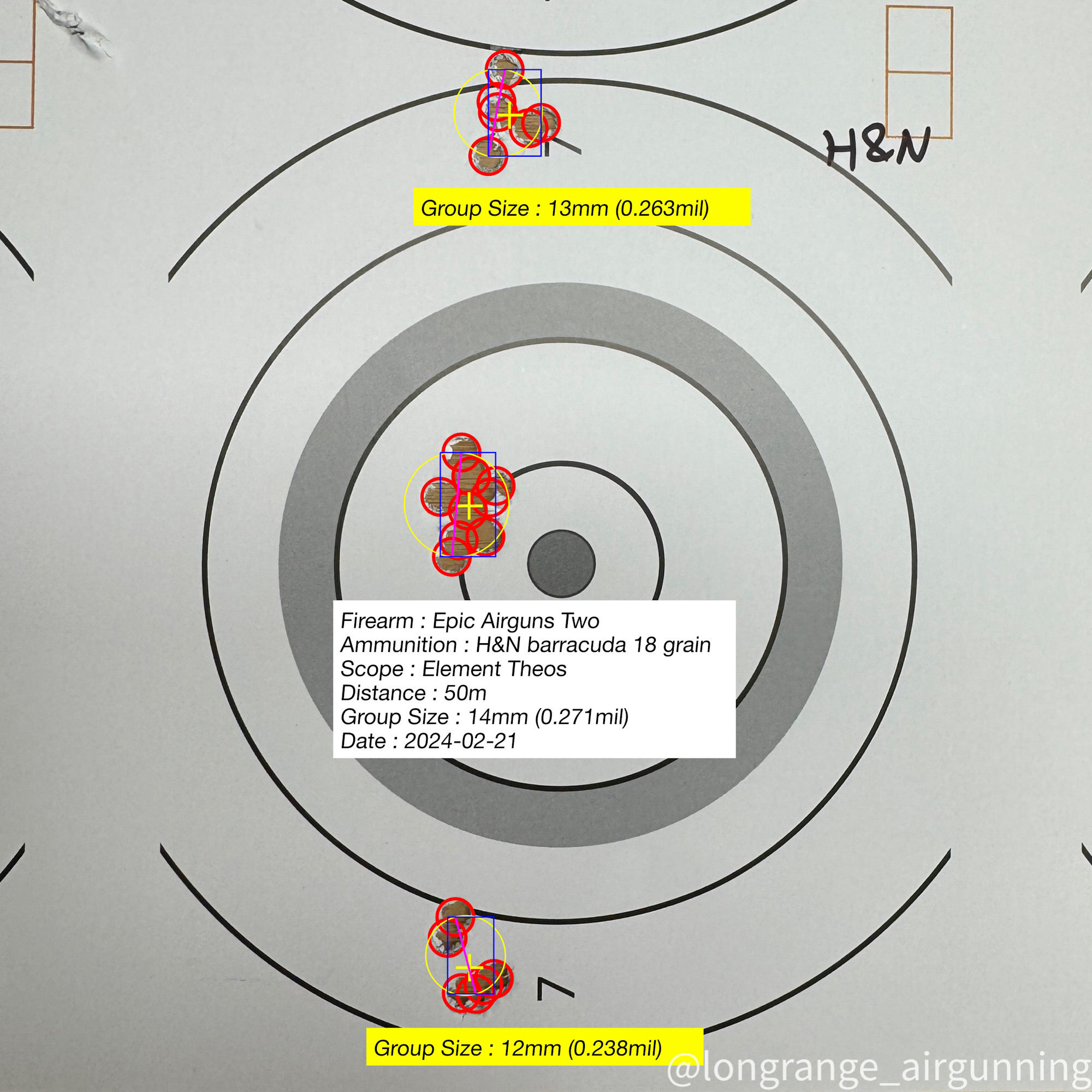

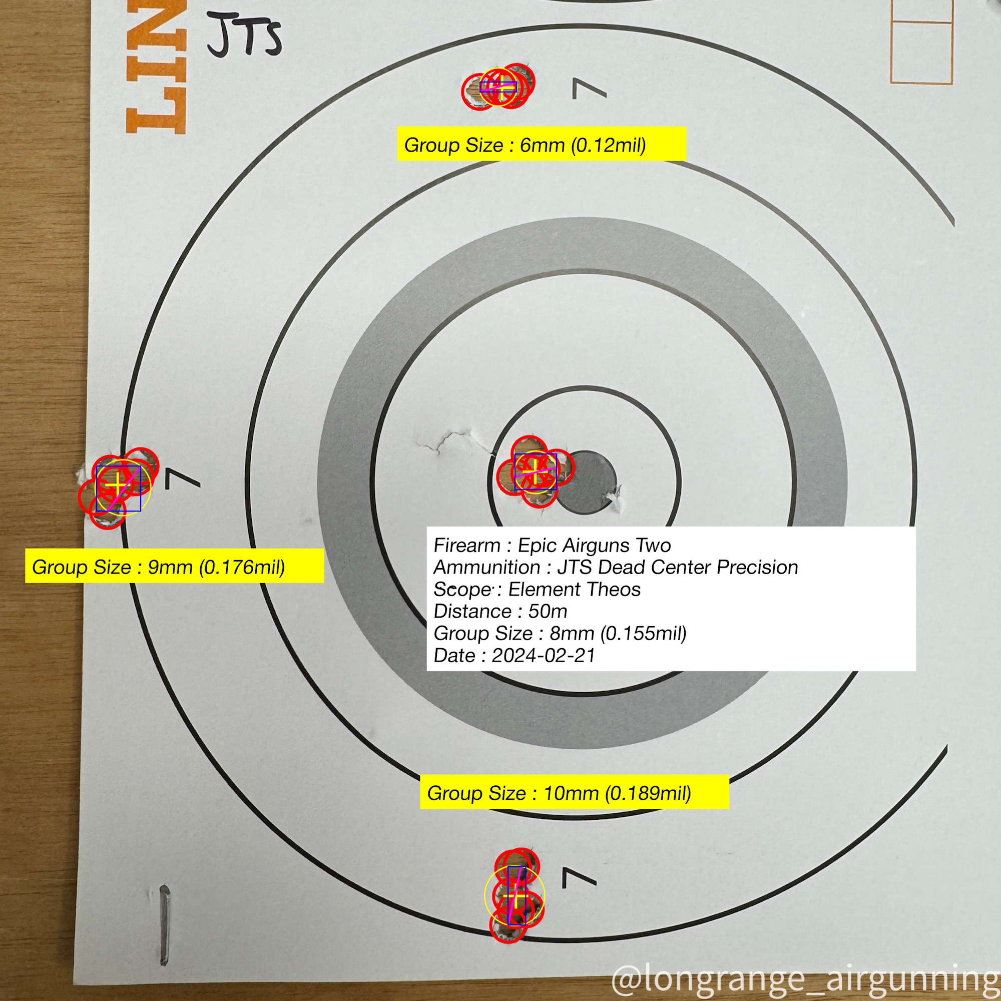

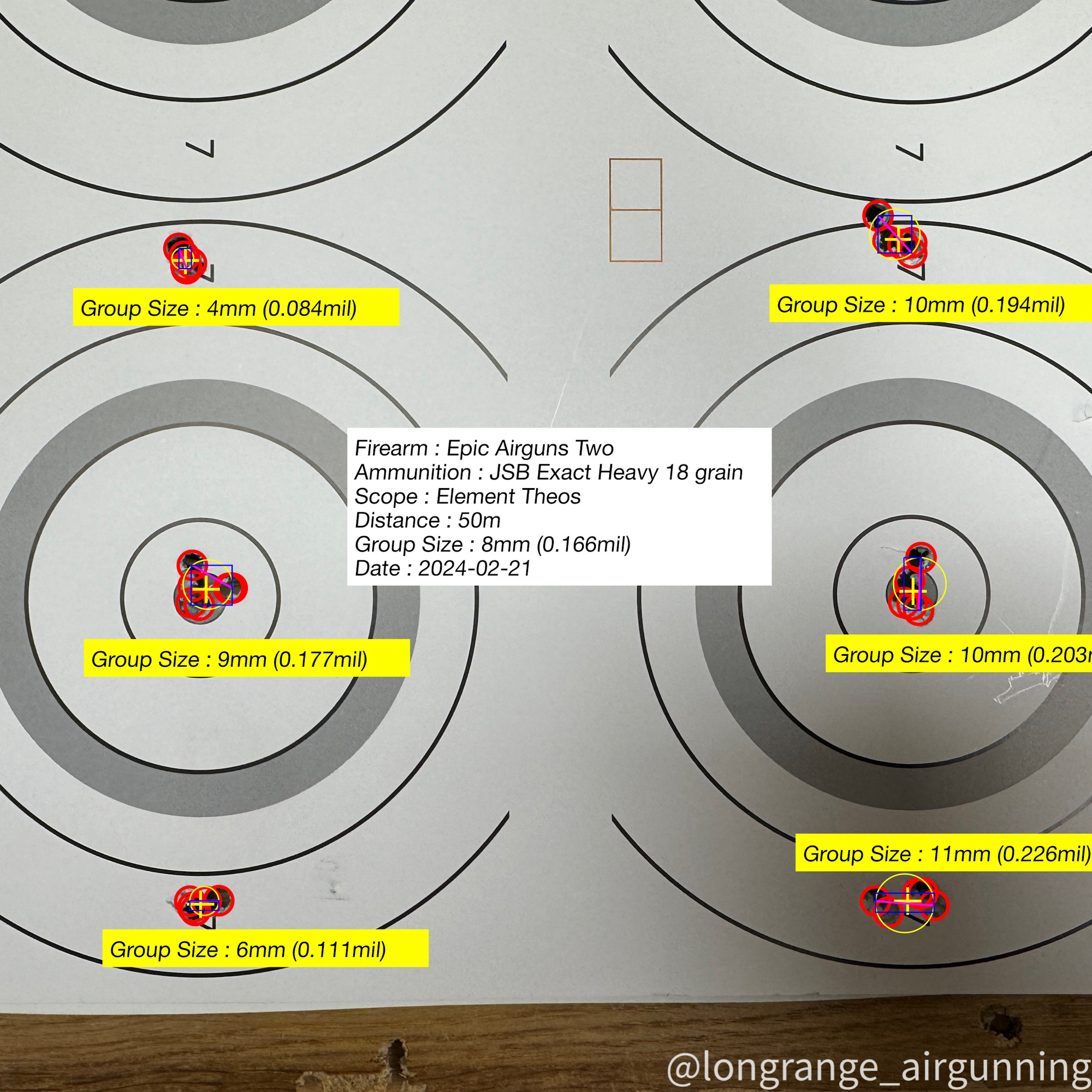

Tested 3 different pellets here: JTS Dead Center Precision 18.1 grains, H&N barracude 18 grains and JSB Exact Heavy 18 grains, all at around the same velocity of 270 to 275 m/s (885 to 900 fps). Will redo the test soon with the shorter barrel since the 550mm version is a bit overpowered with the valve at maximum opening. Also getting a delivery soon of some custom sized slugs to test. Measured the grooves on the barrel at .2195 for the CZ barrel and .2212 for the LW barrel so the standard slugs that are available are a bit undersized with .217 and .218 (for as far as you can trust the size on the packaging ;) ). Zan has some availability in .219 but I still have to test them at the range.

Goed stuff M8, groups look about as you would expect, some maybe a bit wide but that is what you get when you are not spot on with the pellet of choice and / or the tune.
I hope fit are better in .177, CUZ there you dont really get any choice in size, well aside for the 1 a given slug come in.
Well that is good info then. And that many groups looking so good is impressive at 50m. Not just a cherry picked one, that gives some confidence in its accuracy. Have you tried any JSB redesigned Monsters in the 900-930 fps range?

I had a lot more pictures of groups like this but no need to post them since they all look the same :)

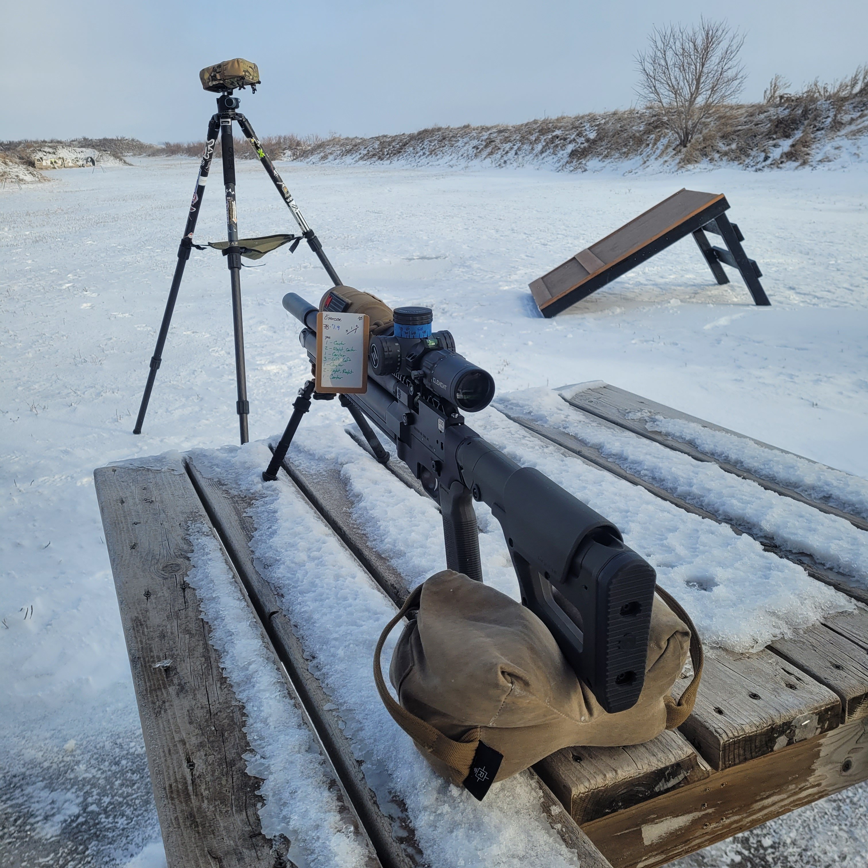

@woogie_man I got the flu 3 days after I played in the cold for two hours. Time spent to shoot the first rounds and zero the scope. It's not funny ;)
My excuse is that the local range is difficult for me to use - the one that's a 5 hour round trip much less so, but in the winter it is cold and the indoor portion only good for 20 yards. Yeah I am a softy.....
As for the rifle - no idea of accuracy as it was windy as could be - I had no idea of what power I was shooting at.
More exploring for me to do. With a little luck this weekend.
