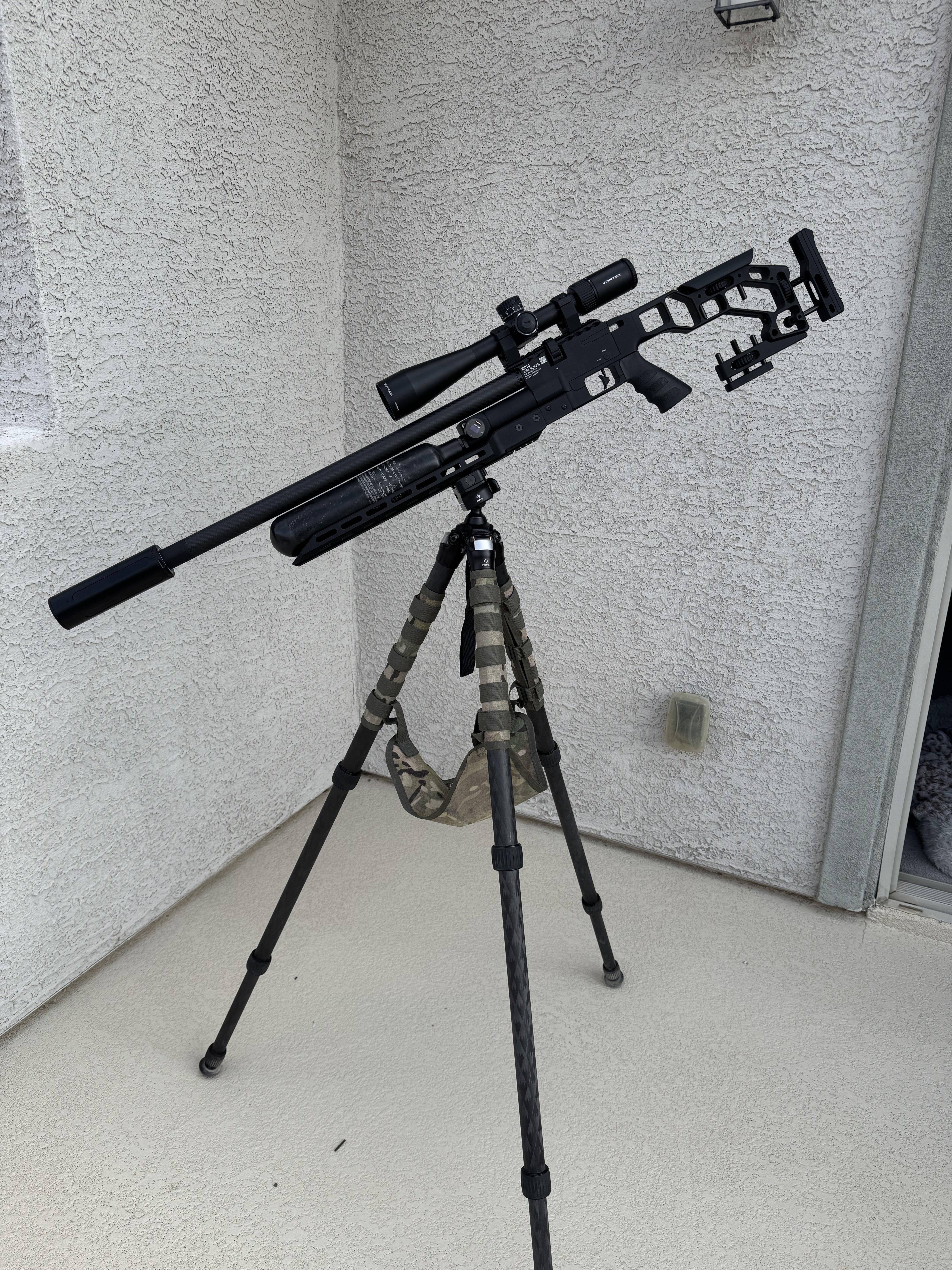

Picked up a gently used Epic Two on trade a few weeks ago and thought I’d post a quick review. It’s a 550mm .25 with a bottle.
I had some initial trouble with it that turned out to be not really a big deal. When the seller shipped it to me he degassed the gun completely. When I got it and tried to fill it, it was leaking from the valve (through the barrel). I took everything apart, checked the o-rings, lubed, put it back together and same problem.
So I reached out to Epic and David (who I think is the owner) was incredibly helpful and after a couple emails he said he was just going to send me a new valve. When the valve arrived I replaced it and……….same issue.
David was stumped and I was considering sending it to Edgun West to have them look at it. So I called Edgun and learned that because the gun has a balanced valve, it sometimes needs a little help seating the valve if the gun was completely degassed. They told me to hit it with a decent burst of air from a SCBA and mortar the buttstock on the ground. I did, and it sealed up perfectly.
Although there was an issue, I have to say that David at Epic was excellent helping me get things figured out.
Once I got it filled up, I took it out to shoot and I was impressed. The consistency, efficiency, and accuracy are fantastic. Getting 10 shot standard deviations of less than 1 and just over 1 for a 30 shot string. I haven’t tested shot count yet, but I started at 275 bar this morning, shot about 100 pellets and finished at about 150 bar.
With the reg set at 103 bar, it’s shooting 25 gr AEA pellets at 950 and 33 gr. AEA pellets at 850 fps. Some pictures of groups below.
All in all I’m super happy with the gun. The trigger is really nice and very adjustable; I just haven’t found the sweet spot for my liking yet. I need to play with it some more. My only gripe so far is the weight (she’s a pig).
I don’t post many reviews like this, but wanted to post in case someone else is dealing with the valve issue I did.

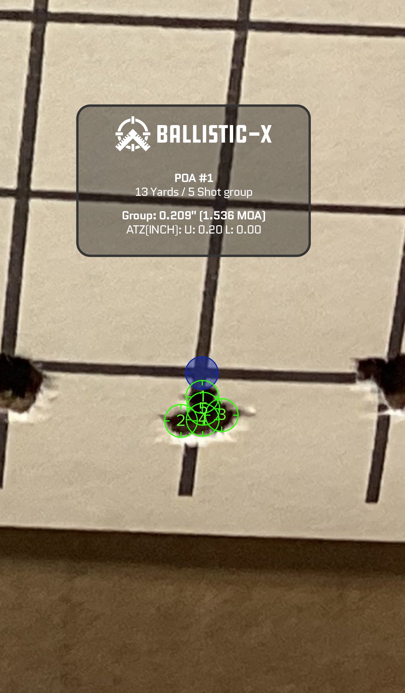

It’s pretty easy. You just take a picture of the target and make sure you have a 1” reference scale (just a line on the target in the picture that is exactly 1”). You select the picture, it prompts you to mark an inch on the picture, then it prompts you to mark the POA and each of the impacts. Then it spits out the result.
This one is probably not accurate as the picture angle is a little weird, I’m not sure if the squares are all exactly 1”, and I assumed .177 caliber.
Oh, and you can take one picture and then use it to mark multiple groups on the same target.

Is it comfortable to shoulder?
Does it feels heavy?
It’s a very comfortable gun to shoot, but I’ve only shot it off a rest/tripod. I’ve shouldered it offhand and it is definitely heavy. That said, I don’t think it’s designed to be shot offhand much.
On a semi-related note, I need airgun manufacturers to start using longer optics rails on rifles. I find that I’m having to use cantilevered scope mounts to get the needed eye relief on some scopes. Unfortunately, in this case, I can’t use a cantilevered one piece mount since the magazine extends above the top rail and the mounts I have would hit it. I’ll have to find a cantilevered set of rings to use.

Hey Joe,
I m glad you posted this , I got it today and MUCH to my surprise I was able to figure out measuring group size.
thats as far as I went so far. That’s all I need for now. I’m only at 13 yards so the pellets that shoot well are really close
but more accurate to determine the best.
