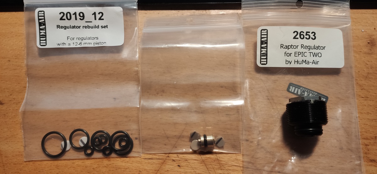

I wondered about the regulator housing being backwards myself but haven't checked. They didn't send any of the Huma supplied parts that you usually get with a Huma regulator, or I would have already started trying to work on it.

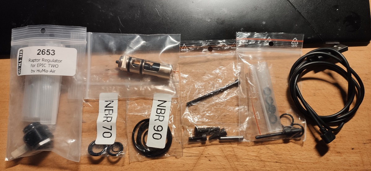

Yes just spare disk for these valves so i have +1 of those and then some as i have also gotten a repair / rebuild kit just to be on the safe side

My entire spare parts kit that follow my Two rifle, included the charge cable for the sekmet gauge on the regulated pressure.
I do need to replace some O-rings i have already used, primarily during my valve woes and then i have just replaced the front O-ring on the fill probe as it somehow gotten damaged, so ATM i just leave it in the rifle permanently as i shoot tethered anyway.

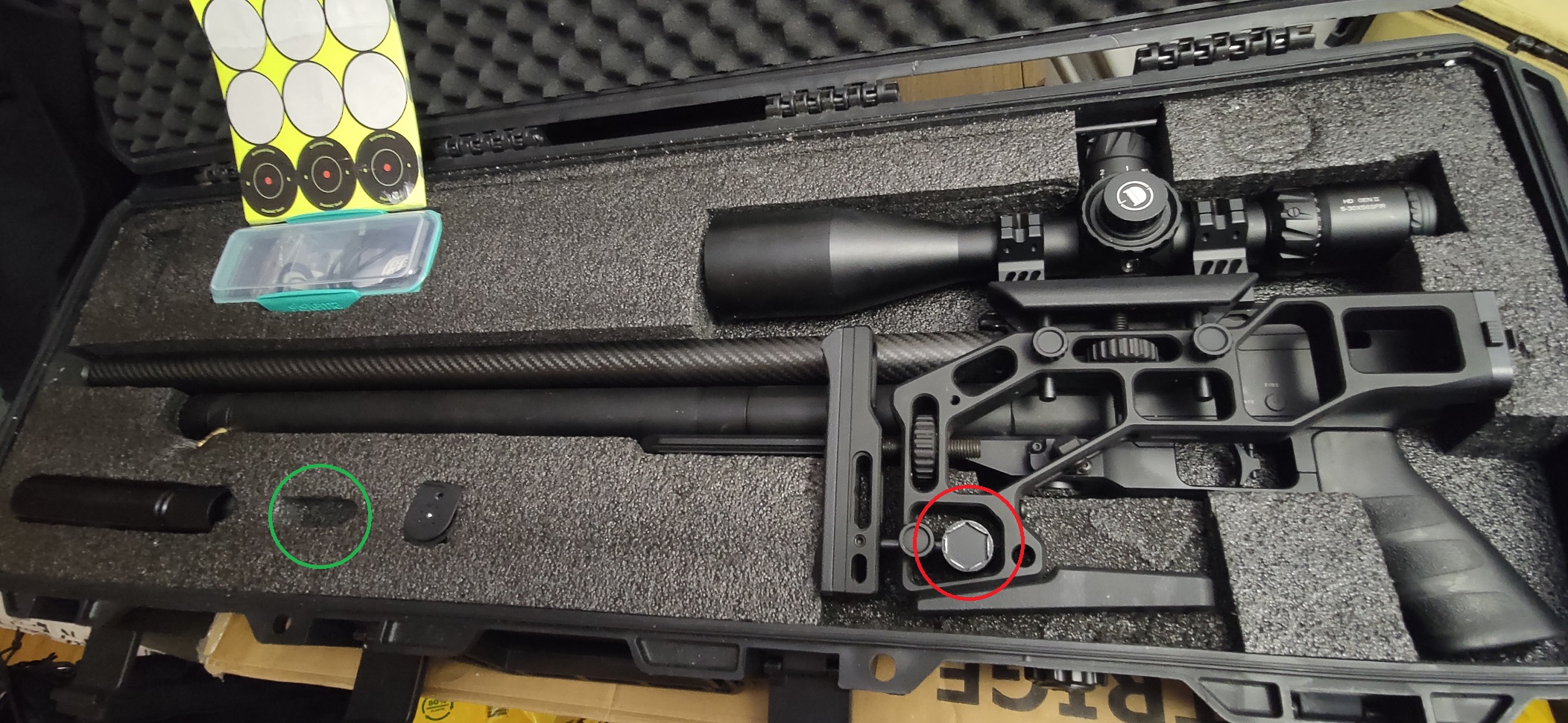

BTW the Huma regulator install and adjust tool, it is a MUST HAVE with these regulators, adjusting it without is a huge pain.
Mine use to follow the rifle in the case ( Green Circle ) But i have now moved to a location on the folding stock ( red circle ) CUZ i have at times forgotten it in the case, so now i do not have to get up to get it in the case at the other end of the shot shed.
