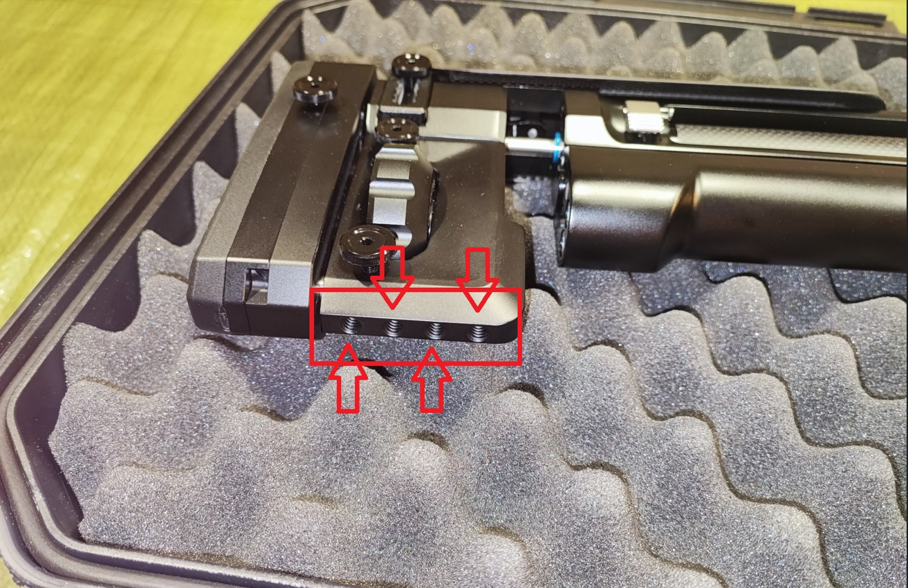

Skout Epoch - what is the thread size for under stock 4 holes?
Sorry for my ignorance but since I'm from Europe I have no easy way of checking this.
What is the thread/bolt size of these holes?
I plan to design/make some kind of monopod so I need to know which bolts I need to order.
Thank you!

1/4-20 Threads, the spacing from center to center of the holes is 1/2"
