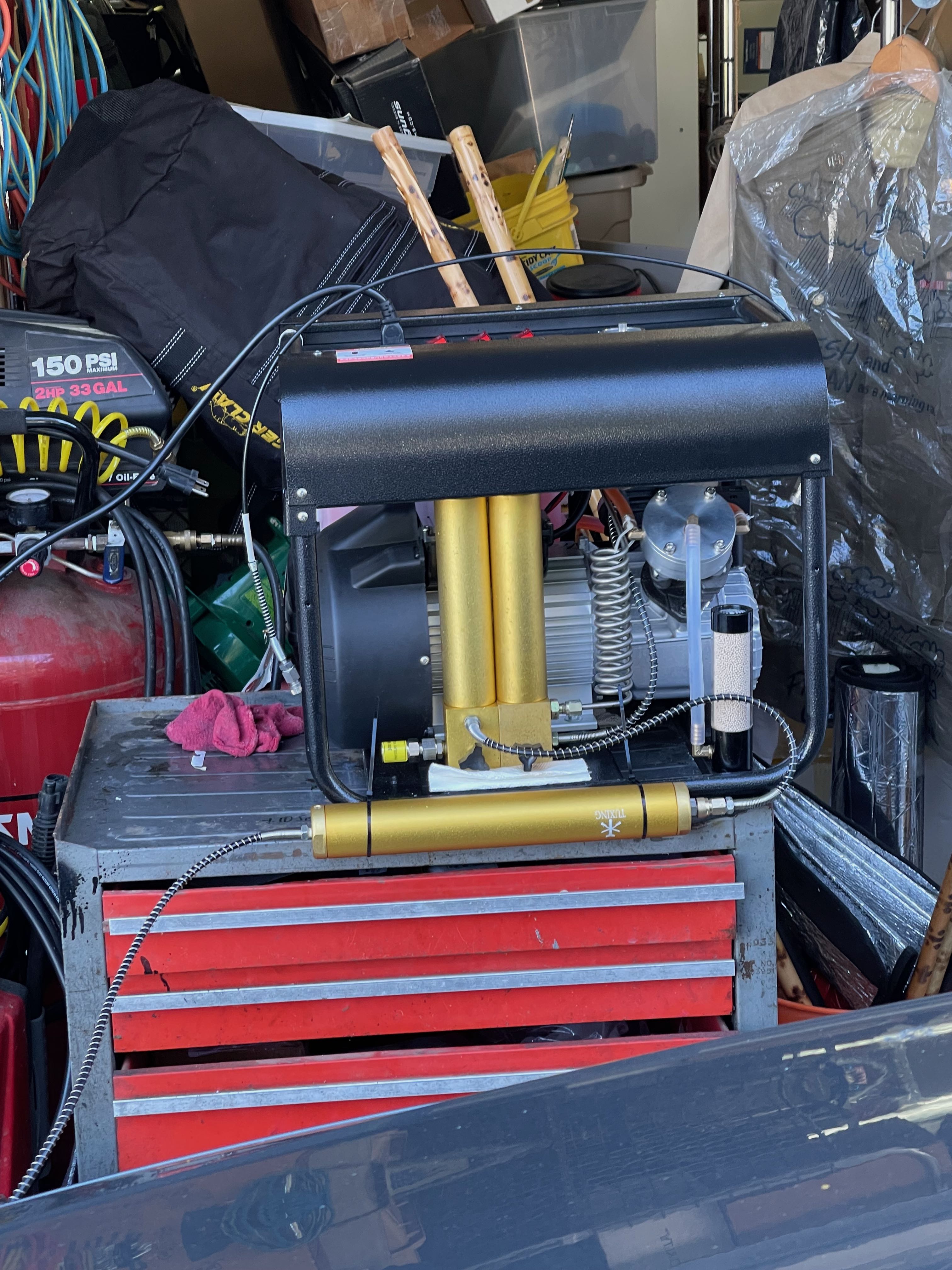

My 032's first filter catches 98% of the moisture, the second catches the rest, I've added a Tuxing Molecular filter, because I'm paranoid, it was a cheap investment, not showing a lick of moisture. It wasn't any near $400.

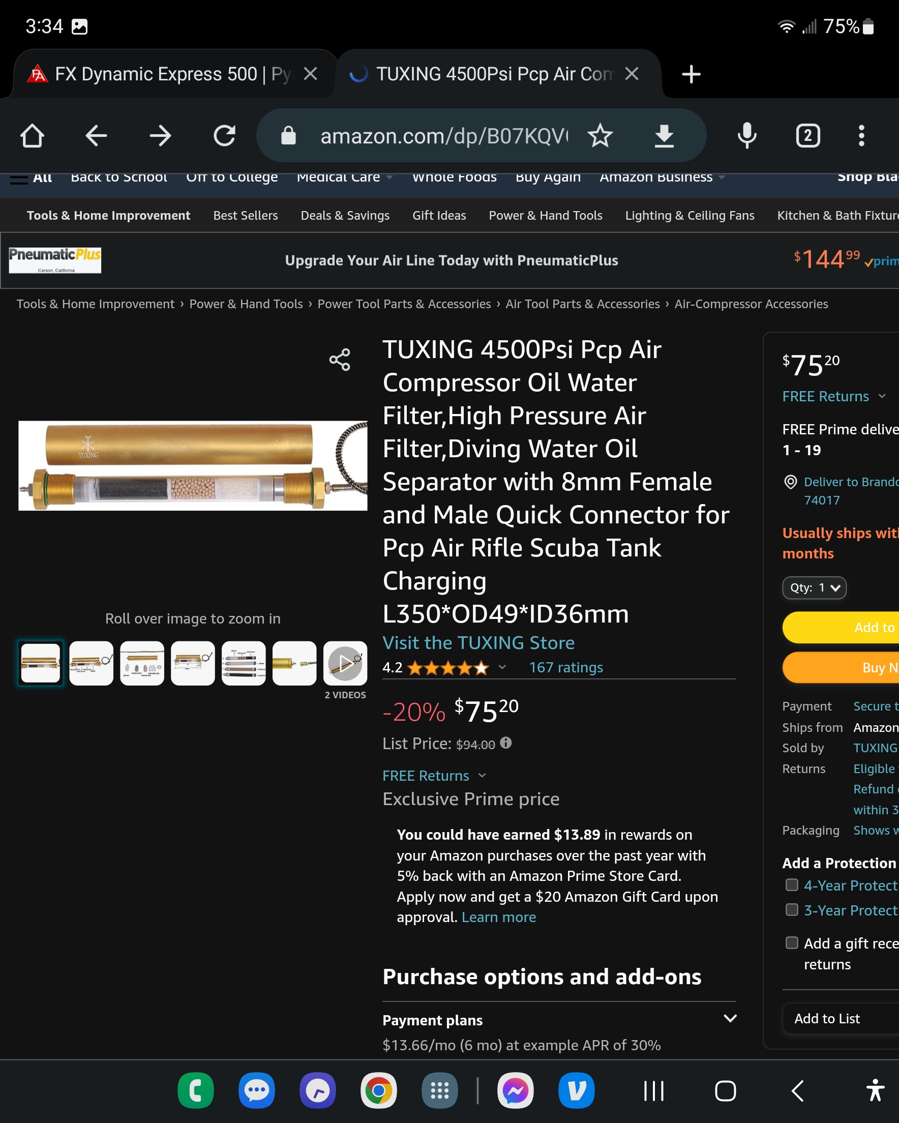

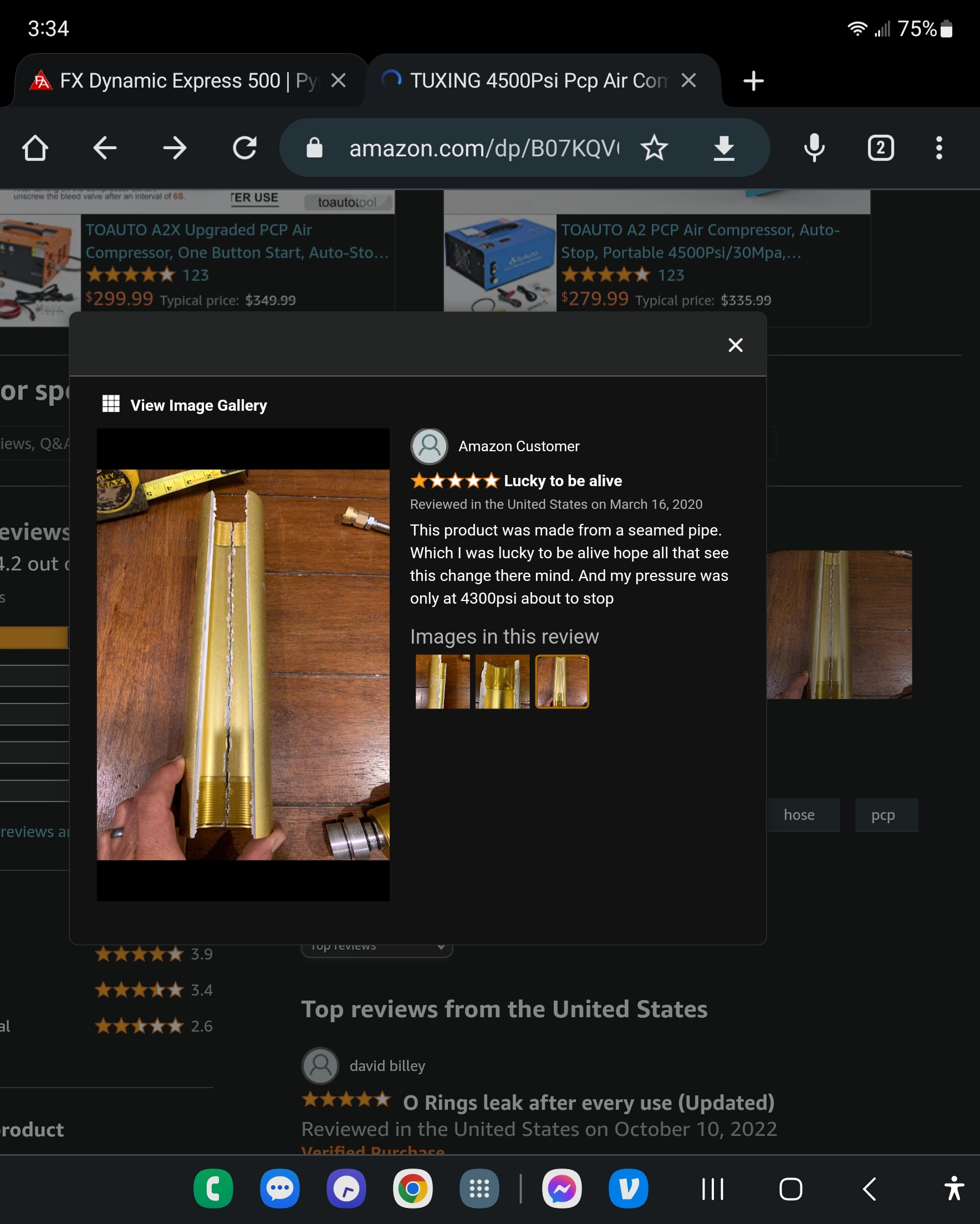

I think the "seamed pipe" video only serves to illustrate that not everything manufactured in China is made to the necessary quality level. $75 for one of the big gold filters is also too low a price which would be a clue something was not right. I have three inexpensive chinese made filters and none has any sign of a seam. They are significantly thicker walled than the air chamber of my airguns. I use two of them each time I run the YH and the only issue I've had is a need for new O-rings.
I think if you buy a filter preferably from a reputable source that is not the absolute cheapest you can find and then look it over when you get it you can avoid any risk of it failing at normal airgun pressures (up through 300 bar). That is my experience, at least.
Another data set to consider is a Target Forge video where he compares the air from a CX 2 and YH with different filters. He sent the air out for analysis. One result that stuck with me is the dessicant works, the other type filter did not. Didn't extract moisture.
