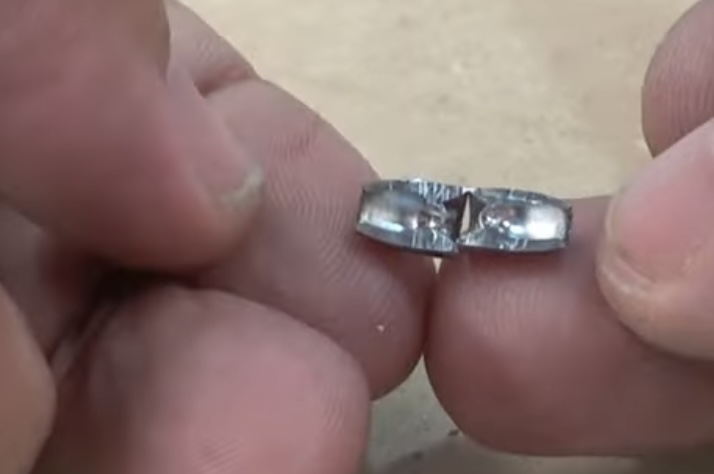

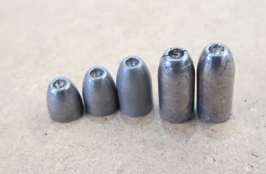

Is it just me?Or did you also notice some of those slugs were cracked along the hollow point
Reactions: Ta-Ta Toothie
Was the cracking just on the larger slugs? I seem to remember seeing they weren’t filled out as well but I also noticed the die didn’t extrude lead when he swaged them. I think he just went too long/heavy for the length of wire he had cut. If he cut a longer core, he would have got better fill out. I may have missed something though.

That may be the case, given that the other ammo looks just fine
A couple of screenshots from the video
