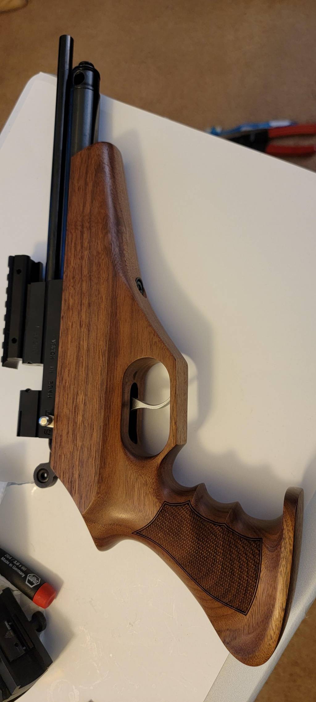

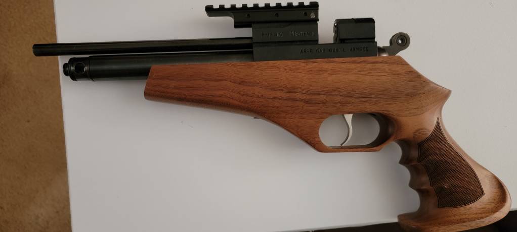

I just got a eBay hunting master pistol. It looks like good condition. But puzzles I wasn't expecting.

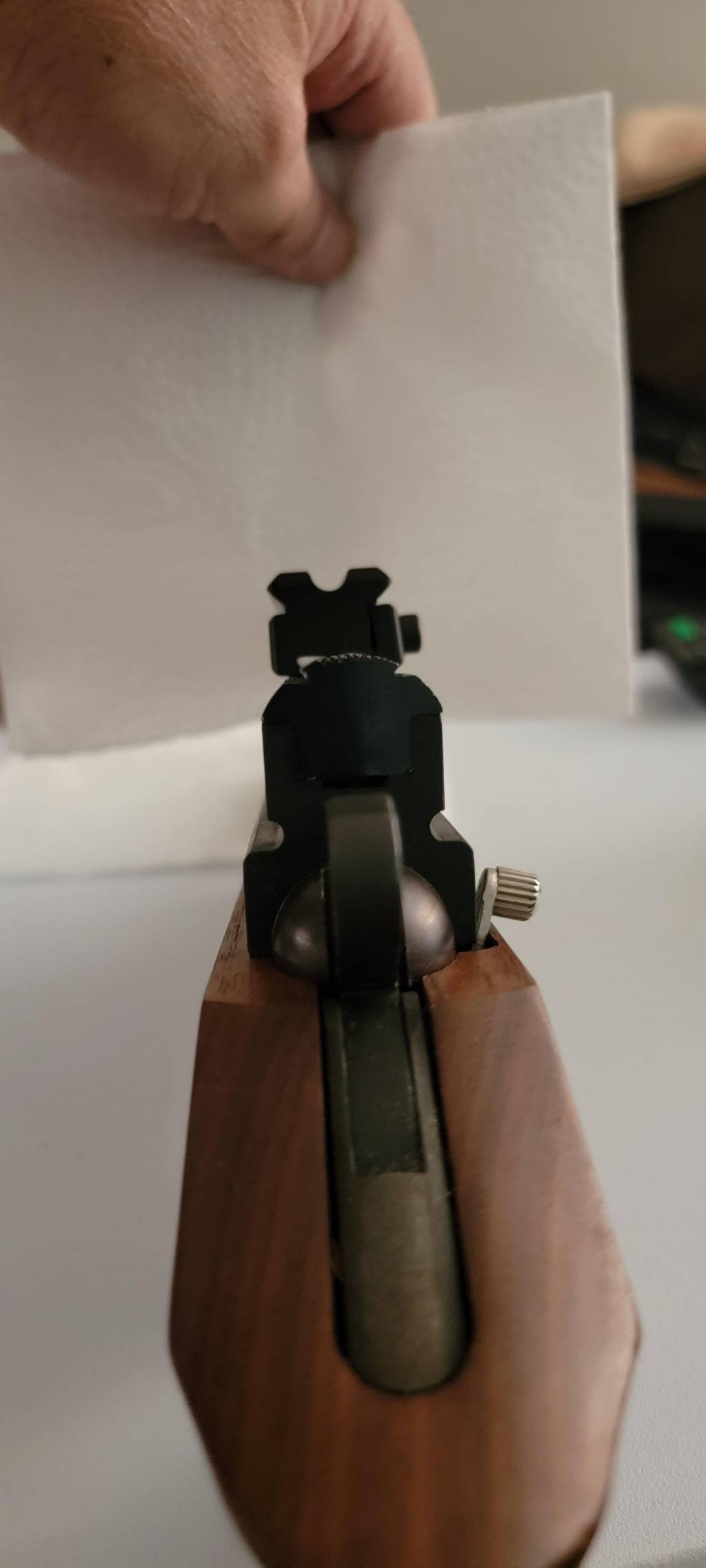

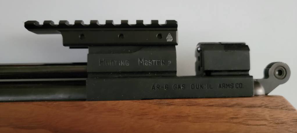

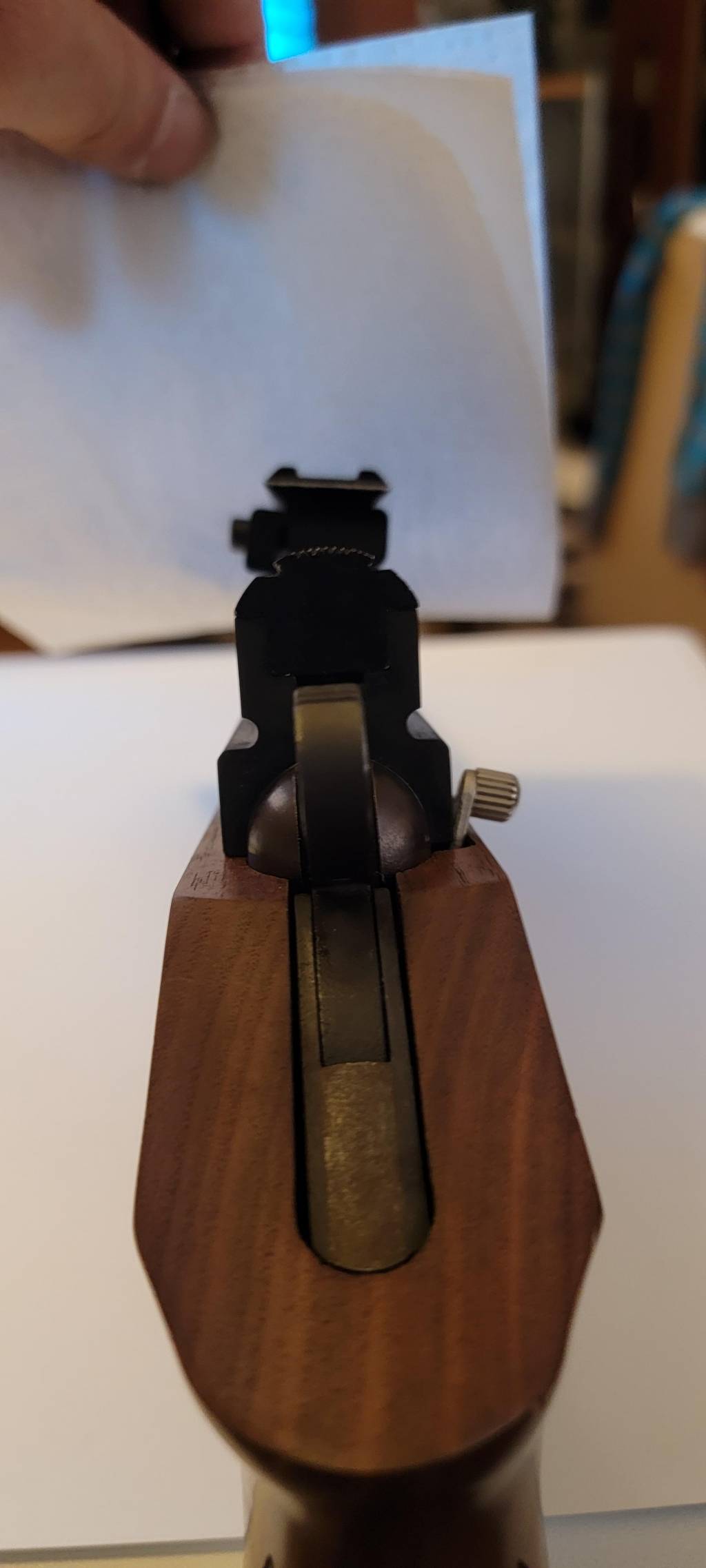

The action has a scope mount that seems too rounded for normal adapters. The utg universal picatinny adapter that worked for any other dovetail I had, can't work here. Seems it would have to bend/arch to catch both ears.

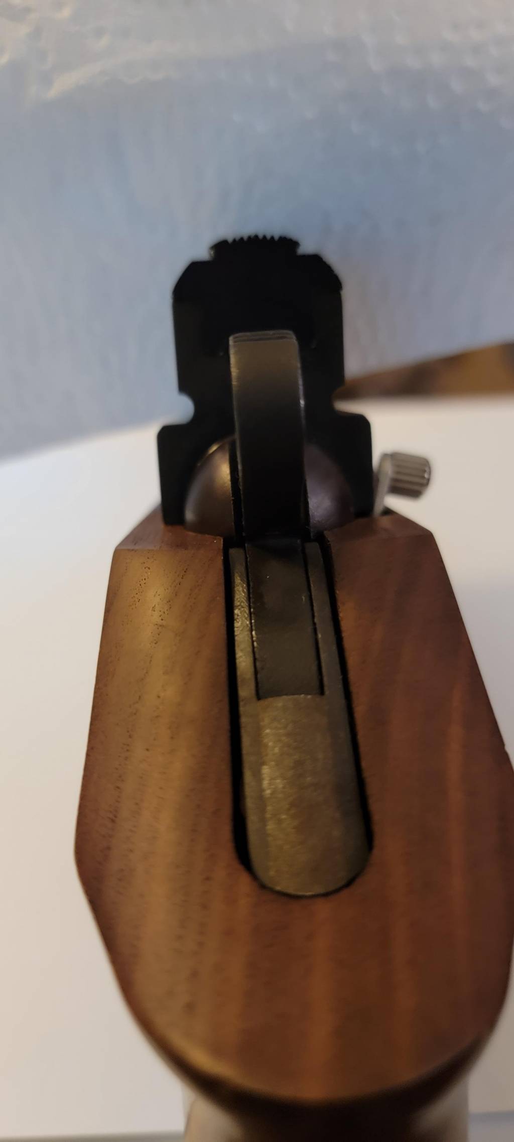

The riser mount that came with the gun fits. But as you can see it is not flat/level either.
What am I missing? Is there an adapter that fits this model so much better?
My inclination is either to flatten out the action (which should not be needed) or to round out the inside/under side of a mount which should give more clearance.

BUT...yeah, that gun rail isn't going to work with any adapter, or 11mm mount that I've ever seen.
If the gun didn't cost too much, I'd just flatten the mount on the receiver of the gun. Mill or carefully...file flat. Continuously checking the squareness (90 degrees) with the receiver. I'd ONLY remove as much material as you need, to get the adapter to sit flat and properly tight on the gun. DON'T take too much material off.
Note, that you "may"... have to come up with some sort of shim to take up any air space after you file the round...flat. Go slowly, remove as little as required.

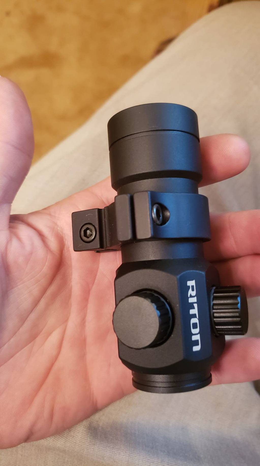

For the sight, I would recommend what I've been using lately. I have several red dots, but the riton 2moa dot sight (for the $100 asking price) blows everything on the market out of the water. I think any other 2moa sight worth anything costs about double. And the brightness levels available on this model alone make it worth the extra $ over the other dots I have. Very bright and very dim and several inbetween settings. As well as a very fine dot making it easy to take precise shots.

I didn't mention any model of dot since picatinny is all I have. I have the cheapest utg, an Ade, a riton (704 tactical recommended for 99$'thru bereli)

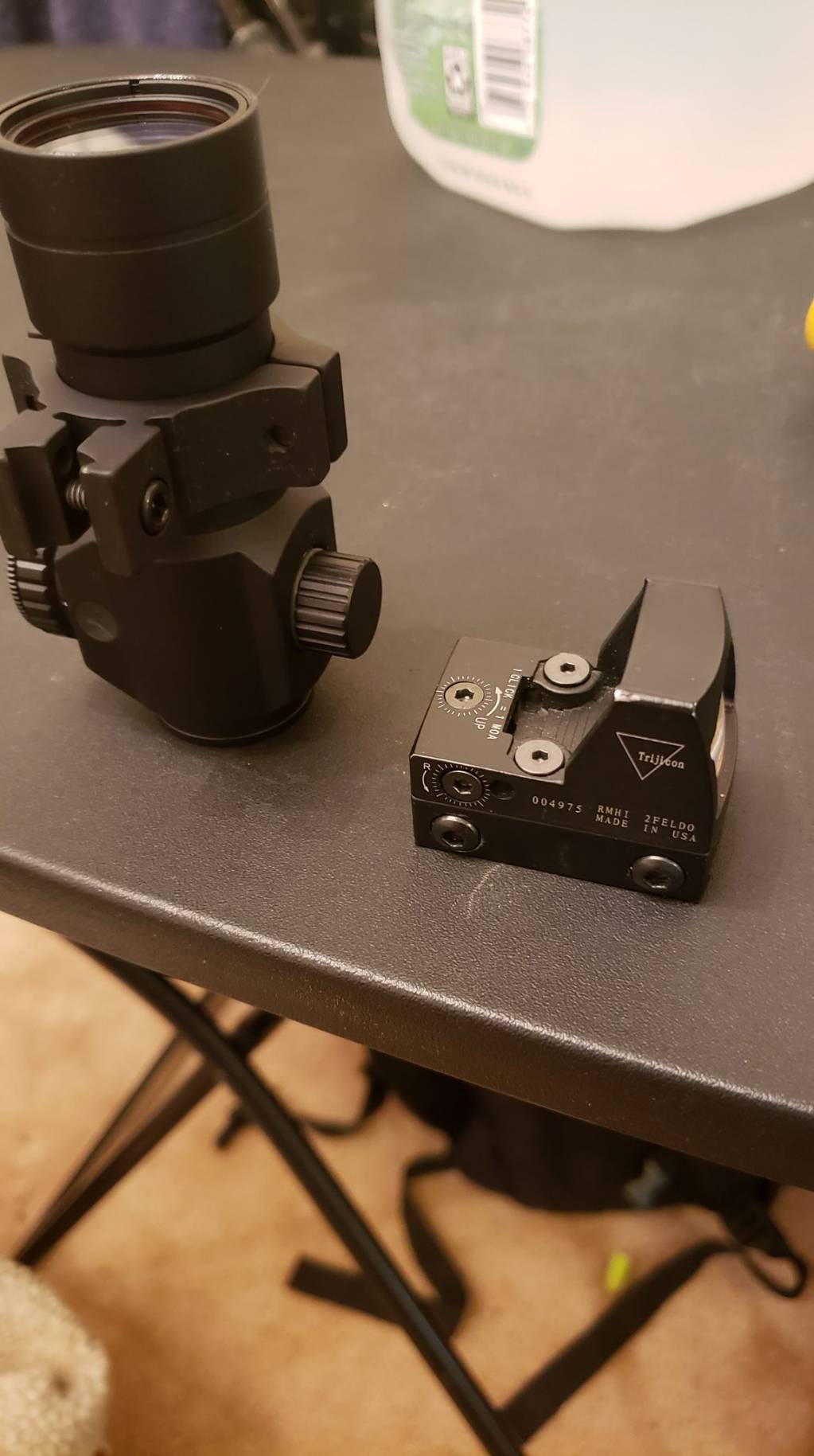

Long-Gun, I am confused. From all the different stores I have searched..a red dot can be a tube, can be a rectangle, can be a prism. Open reflex, supposedly was one pane of glass, usually on a square base.
Since I have not found tubes in the 1 ounce range or 1-2 inch length the open rectangles are my preference, although the tubes are much much more common and affordable

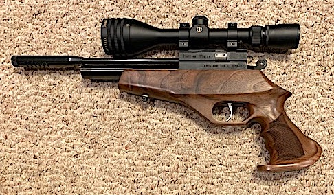

'Twould be criminal to attack/butcher the gun, when there are $20 mounts and red-dot scopes out there to overcome the hurdle, in my opinion. You can often find 1" tube red-dot scopes on Ebay very reasonably priced, since they are out of fashion. Like this-
https://www.ebay.com/itm/144424402953?hash=item21a05d8009:g:z-IAAOSwFtFiAwLT

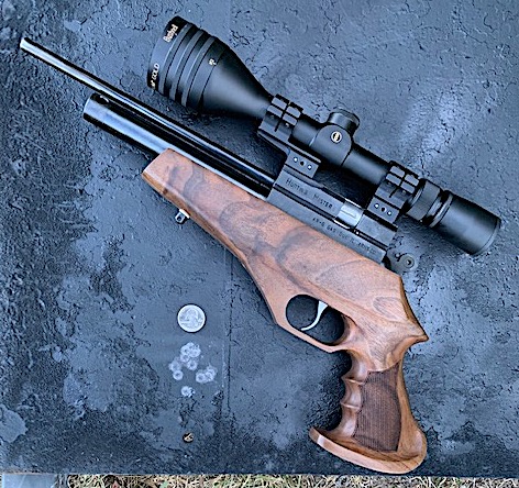

I've had good luck with Adco, Bushnell, Leupold, and Ultradot 1" tube RD scopes. The first two brands often go for $40-60 in good shape. Add $20 for mounts that will work on the AR6.
BTW, The AR6 can take pistol shooting way beyond usual air pistol power, range, and accuracy levels (two consecutive six-shot cylinders at 50 yards)-

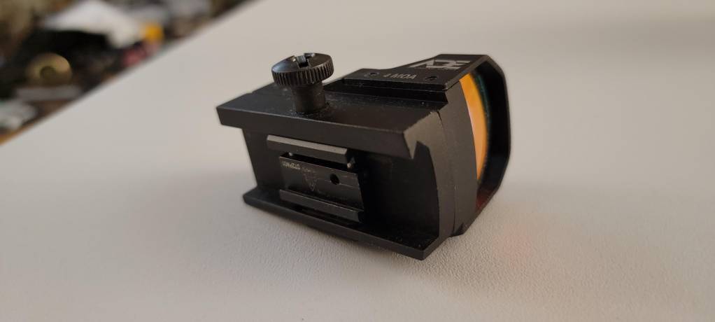

Rings and a dot would be maybe 6-10 ounces or more. Riser and a reflex might still be under 4 ounces maybe. So till I give in to easier/ heavier/and more affordable tube, I will try to get a properly level dove to pik mount to work. With maybe a new sig or holosun
You're fretting over what is going to ammount to roughly 1 ounce. If that? A tube dot sight by it's-self is going to be very light. My large one is about 4oz. I just weighed it. (5oz on the dot with ring.) A scope ring to mount it is going to be around 1 or so, possibly less. A reflex sight like you pictured is going to be around 3 oz (larger one looks to be closer to 4) add a riser at 1.5oz.... I don't see where you're coming up with extra weight?
My RMR sight is VERY small. And is 2.25 oz, but the riser will be close to 1.5. The one you have looks like maybe more than 2 oz..... so, your'e not coming ahead in weight anywhere. Not in any amount that is worth thinking about.
Reflex is simply a light being reflected off of a front refletive surface. It can be enclosed by additional lenses.

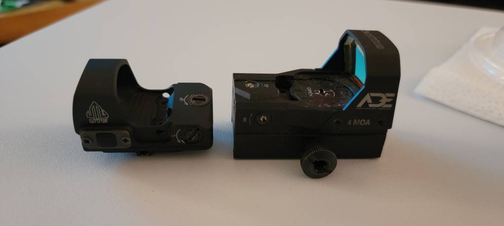

With my original utg adapter, the Ade is only 3.8 oz. , by itself 3.6
By itself the little utg red dot is 1.8oz
I agree 1.5 for a riser is reasonable
Romeo zero elite w/o any mount .5 oz
Holosun 407/507 w/o mount 1oz
So 3 oz should be possible if I can get a riser to fit ok. So with a lite tube a few more ounces, not that big a deal, which I would like to not lift. But then we get into aerodynamics ie footprint. Still I am a minimalist, less bulk, happier it makes me (excluding the power issue. Always neeeeeeeeed more)

Tinker, your guess was right.
Just got that utg dovetail to picatinny mount (gotta love Prime shipping)
It fits and sure looks more level ,to me, than the one the previous owner used.
I am happy now. Time to play with my new toy
