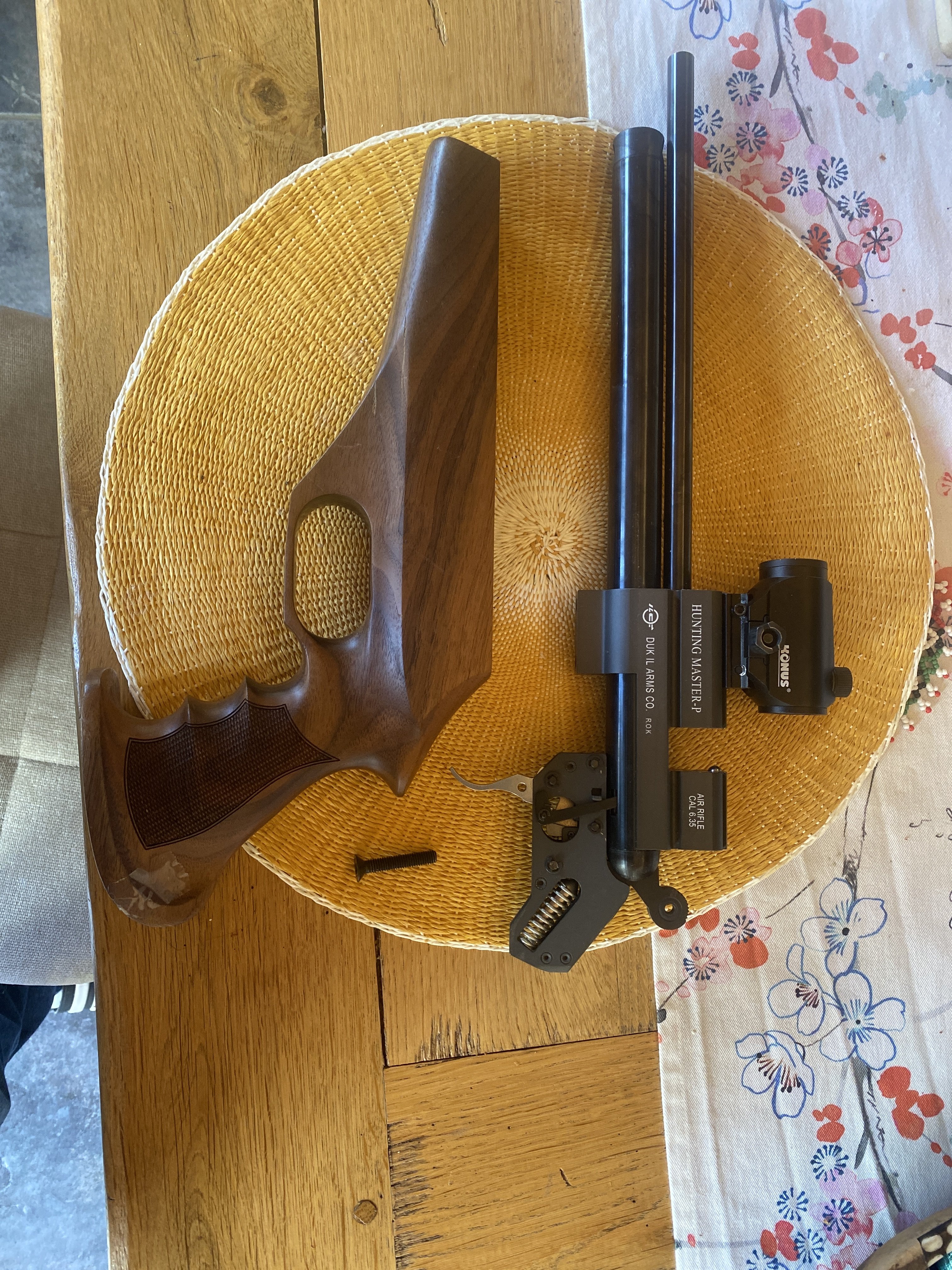

I have an Evanix hunting master AR PCP pistol in .25.
after not using it for a while I can no longer get it to fill due to a leak at the filling site ( both hand pump and compressor) I do set in in the cocked position but no difference.Any useful tips without having to send it in for repairs? I’ve heard that spraying the seals with a bunch of silicone oil may help but I don’t have any sitting around
Remove the e-clips from the pins on the trigger group. After trigger components are removed it will reveal two screws. After removing the screws you will be able to remove the valve(*the valve is threaded in the tube*). Replace the seal on the valve.
Next, use the fill probe to unscrew the fill port cap to replace that seal.
Hardware store o rings are no good for hpa. Buy this seal kit https://www.ebay.com/itm/274298151751
*when removing e-clips place the gun in a plastic bag. They have a tendency to fly off when removing them
