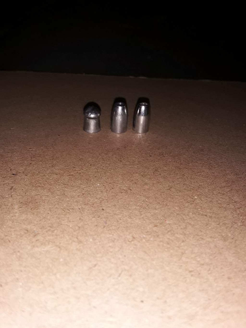

I just started testing NSA 43.5gr & 55.5gr HP.
As long has you have the power to get them up to speed, they have to pack a punch.
55.5gr I'm shooting it in the 920 fpsrange and the 43.5 right at 990-1000fps
I don't have a Rex though, I'm using a TalonP and picked these slugs up for a project but shot a couple for base line, and initial tests were favorable enough to continue.
From left to right
JSB 33.95, NSA 43.5gr, NSA 55.5gr
