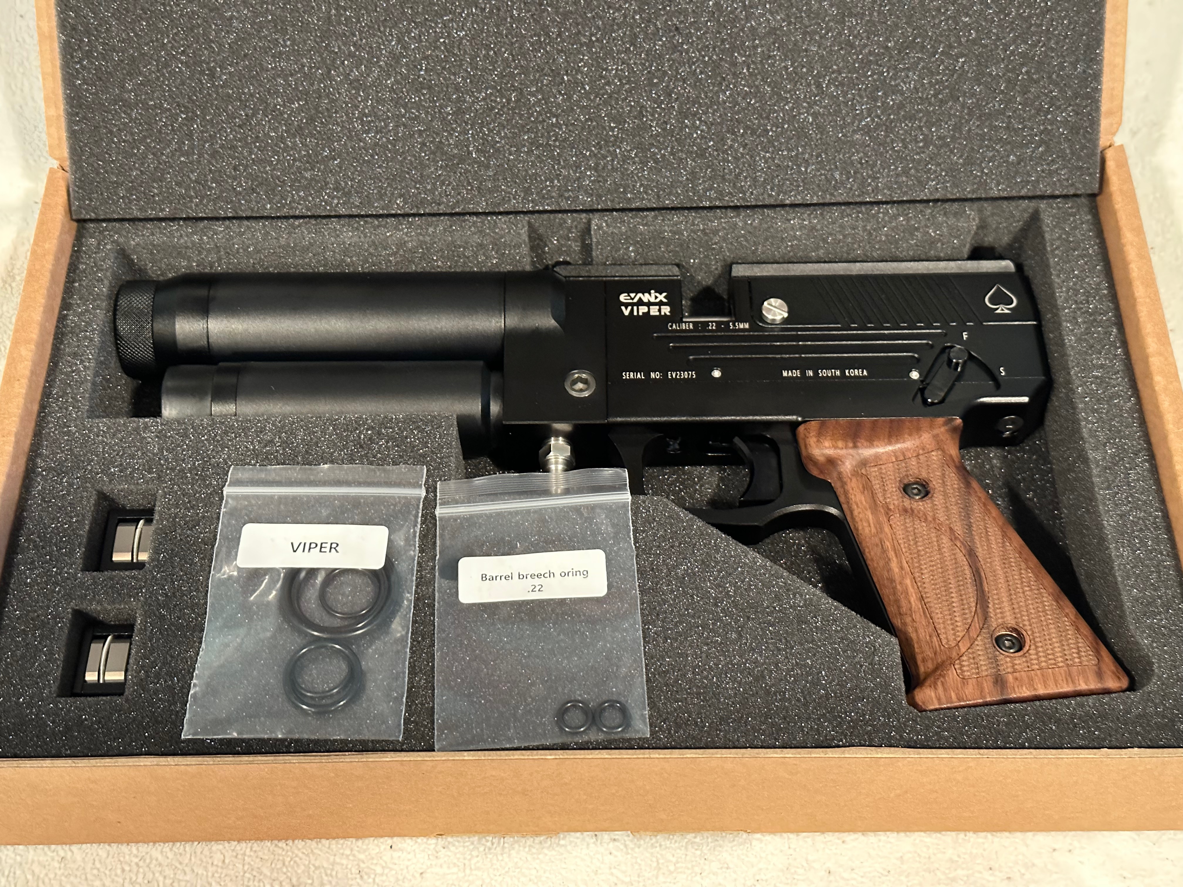

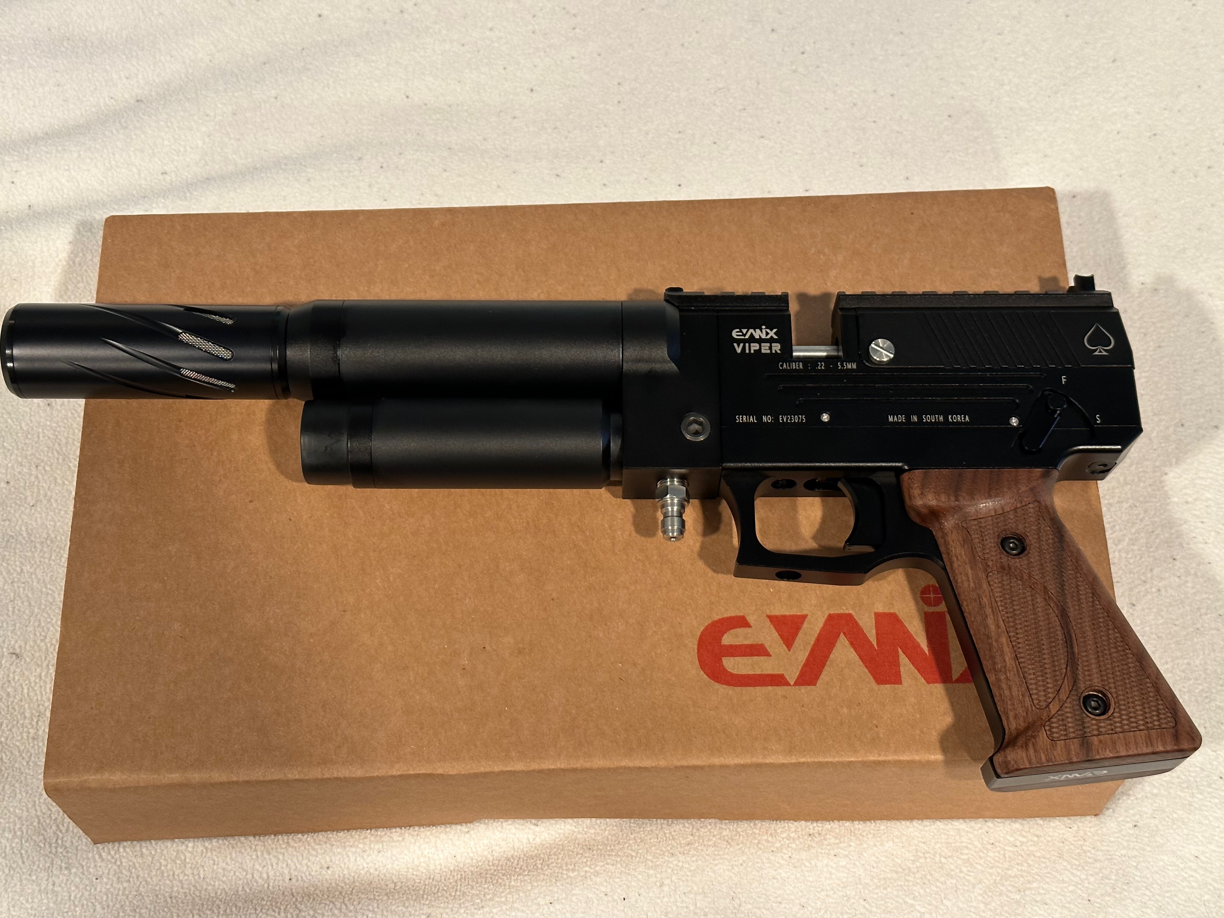

Some initial thoughts.
- Nicely packaged with plenty of extra o-rings.
- Wooden grips are a nice touch and have a good feel to them.
- Trigger is not feather weight nor too stiff. Just about right for a non 'target' pistol and very crisp.
- Magazine are well made and all metal. Easy to load and with a spring surrounding the cylinder each pellet is grabbed and falls into place easily.
- LOUD! Did I say LOUD! Even with the Hugget Atom it's still makes my Crosman 600 seem quiet.

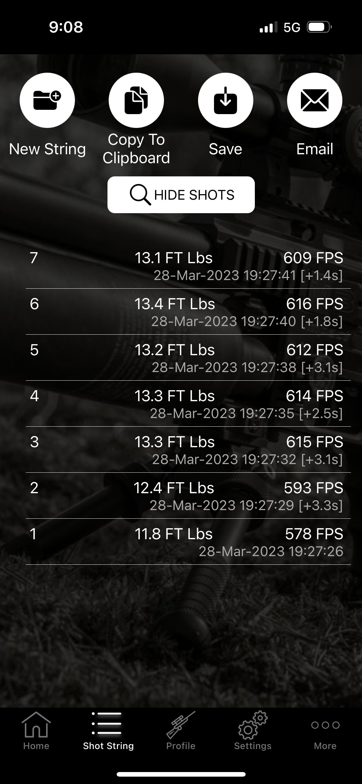

Hang in there guys, we have a Viper in the shop, we are at 615fps with 21g slugs and getting 3 full mags a fill at this time, a few more days and I will have numbers for the 18g. and a few others. Will add results of tests to this thread for folks if they want or you can check our site iin a few days for info.
@bthurman - Will be interested to see your results. Not saying I am skeptical of your statement on the 21gr slugs, but would think 615 fps is your highest speed of the shot string. Would like to see string of all 21 shots prior to making any further judgement.

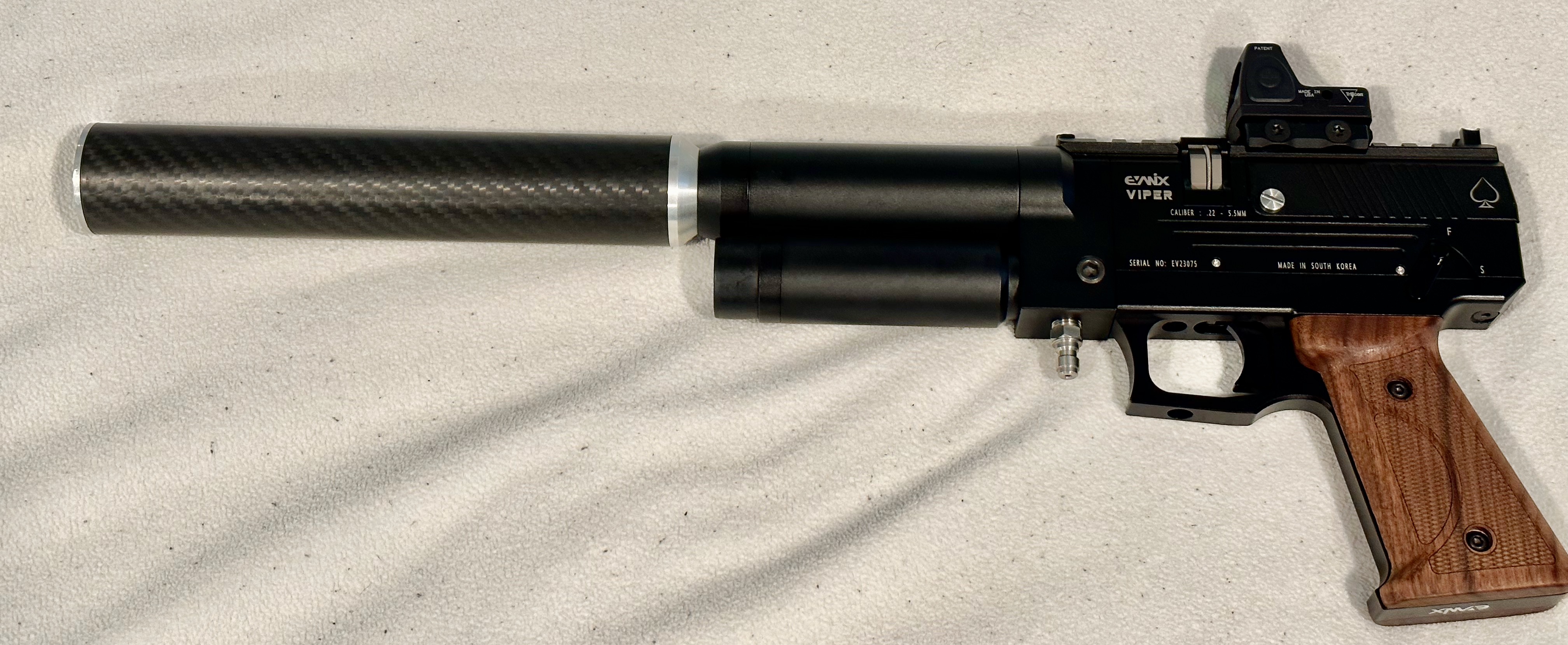

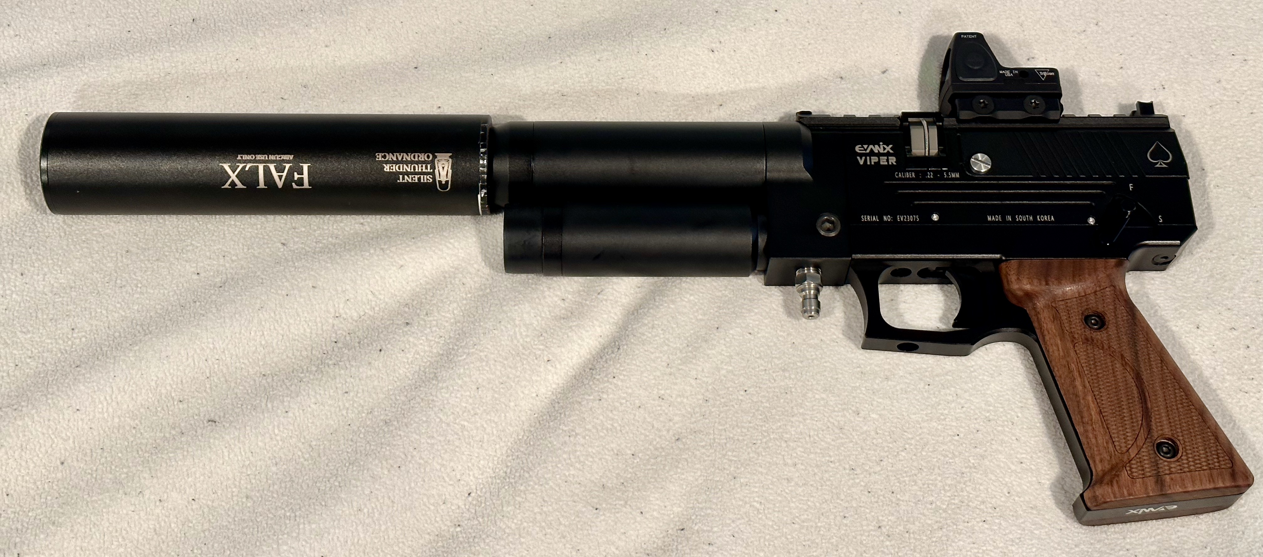

The stock open sights are just meh and not adjustable. I put a red dot on the Viper but it's mounted to the slide you have to pull back to cock it, so there is a little wiggle going on. I'm going to try to move the red dot forward to tiny rail in front of the magazine, but not much room there and it can't interfere with the magazine insertion removal.
