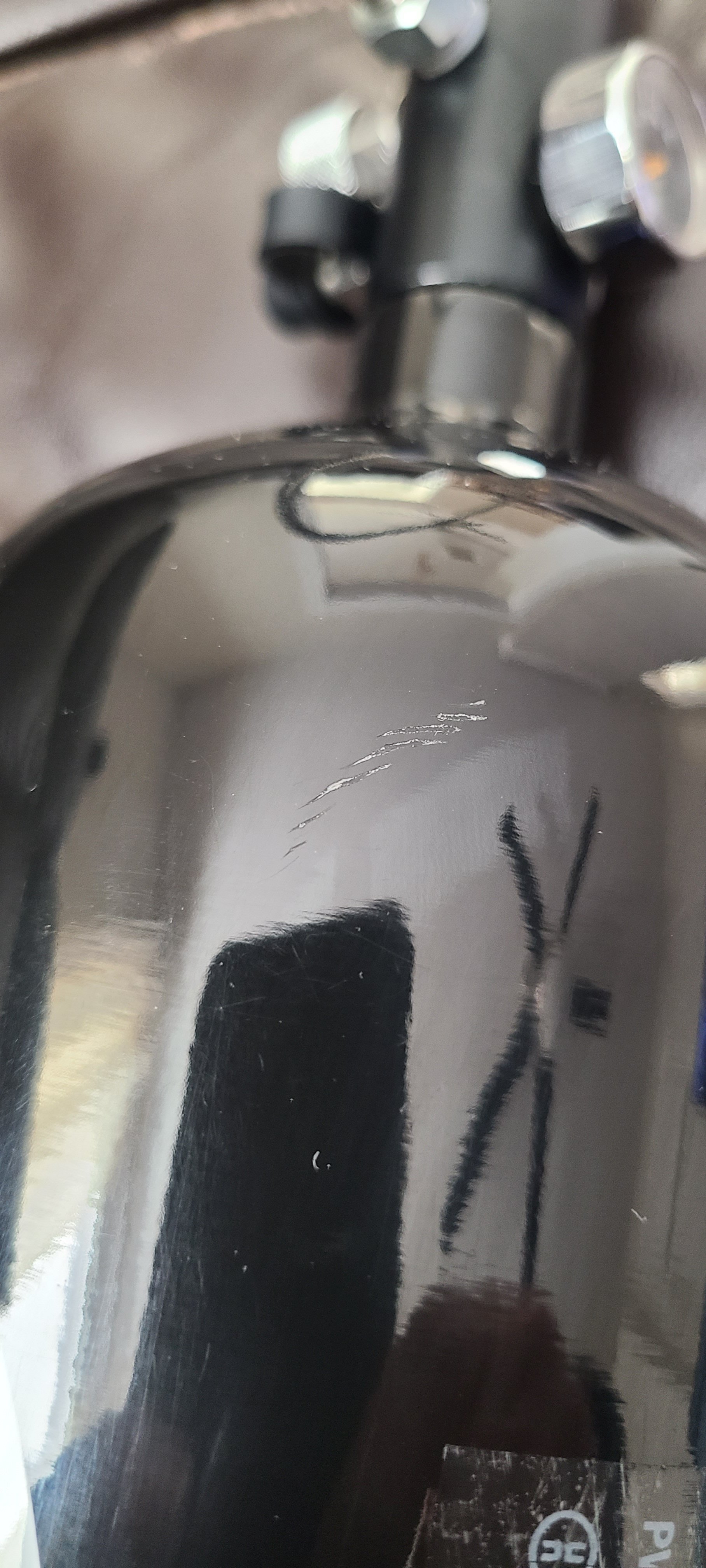

Ever have a tank split while filling
Was filling my Hatsan 1.6l
Buddy tank and right around 3800-4000 psi I heard a weird aluminum tin can sound
I looked at my tank and noticed the carbon fiber separating
Shut the comp down and immediately opened the valve to dump the tank
This is what I found
I do not believe I've seen a report like this before. As was suggested, the age and manufacturer of the tank would be useful information. Also if there was any visible damage prior to the event (there appears to be none). Did it seem to be leaking when you shut it down? I'm not suggesting it is usable, just curious if the liner failed first and air was gushing out.
Carbon fiber tanks are really thin aluminum tanks that are covered with carbon fiber. The limited test data I have seen shows large mechanical margins in the carbon fiber. My guess is this tank was built with a weak spot in the carbon fiber where the failure occurred. Perhaps too much resin and not enough fiber. Especially if the liner did not fail first. If the liner failed first, that could damage the carbon fiber. You would presumably know the liner failed because air would be rushing out - the carbon fiber is not expected to be able to stop a leak.
The good thing is this reinforces the possibility that when tanks like this fail it is not a big "explosion" but a more controlled leak event where injury is much less likely. I worry more about aluminum air chambers where there is no overwrap to contain fragments if they fail.
Well I have read numerous times that this in general is what CF tanks do when they fail. They generally don’t explode. That is the bright side. If it were me I would probably cut the thing in half and inspect the inside. Wonder if there is any evidence of moisture corrosion?

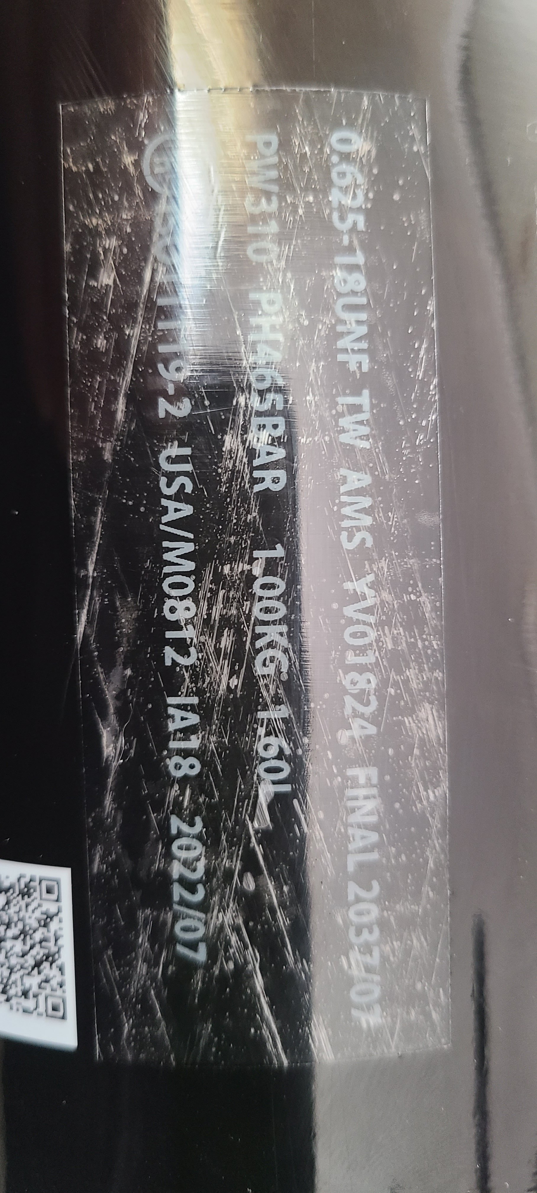

The tank says 07/22
Exp 7/37

Not sure who makes these for hatsan?

i put my scope inside and there is a dimple right where the carbon fiber split so i think thin spot in the tank

sounded like a beer keg getting bumped then i looked and seen the fiber splitting shut the compressor down and opened the valve to dump
was definitely getting the pucker affect
