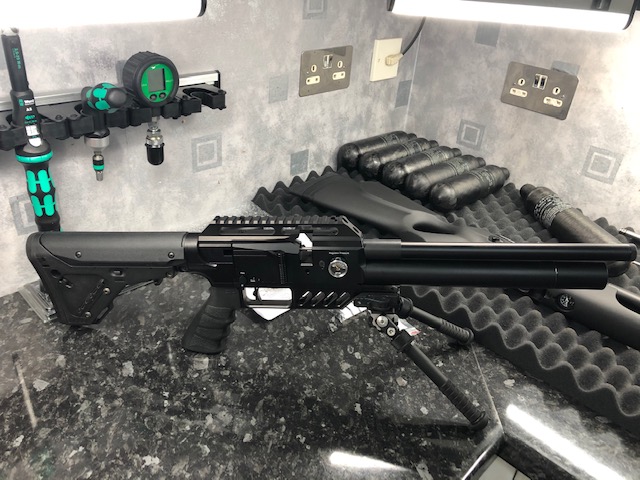

I had to make my own DreamTac Compact as they still aren't widely availible here, this is a 300mm liner set-up with cylinder shortened to suit.
That looks GREAT! Very nice job there 👌
