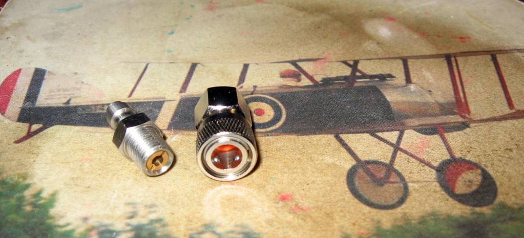

A one way foster valve and the corresponding quick connect foster fitting. Just plug it in and fill thru it. The one way valve will hold the air in just like the original fill valve.
It may look a little gamey but you are back in business. Probably would watch which way that thing is pointed just in case it would happen to pop off and of course once pressurized it can't be removed without first removing all the air from the gun.
For the fitting on the left just Google "Foster fitting one way valve" and all kinds will show up, $15 from airtanksplus.com down to $5 from e-bay. The fitting on the right is the standard Foster quick disconnect with female threads. Some of these fittings have tapered threads (use Teflon tape with those) and some have straight threads and they use the white Derlin washer or an O ring for a seal. The above fittings have straight threads. Make sure what you get match.
