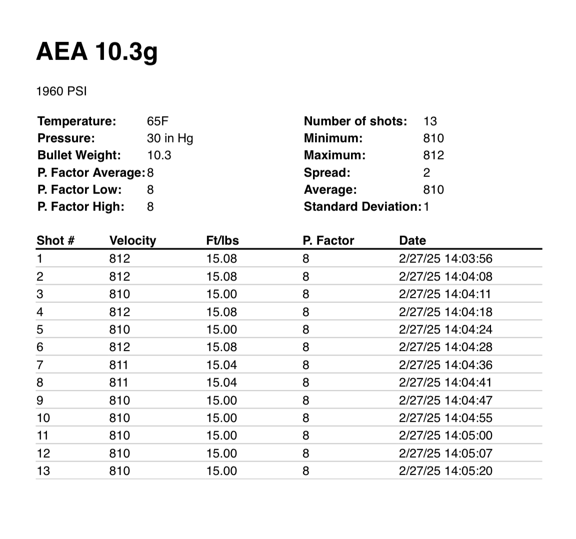

Interesting! Out of interest what size is the aperture on the valve seat/pre transfer port, as I have found making a reducer for the manifold (seat to barrel shroud) has tightened up my fps variation by a lot previously up to 20 or more down to 10 and below, but mine is sub 12 and I don't think it likes the regs being turned down to achieve this, I am also looking for another barrel for mine.Well it took me longer to report back than I was hoping. We’ve had everything from ice and snow and subzero temperatures to today where it’s 70°.
I finally got my coronagraph back up in recording properly and I’ve made some interesting discoveries.
I found that I get a greater POI shift and Pellet speed shift ( speeds changing between each shot) if im running a lower pressure, say 1000-1200psi range.
In other words, the 600 to 750 fps range I was getting a much larger Speed variation.. 10fps or more between each shot regardless of the pressure that I was at in this range.
So I started increasing my regulator pressure and speed and strangely enough my groups tightened up as well as my pellet velocity stabilized. My accuracy has improved tremendously. Now my extreme spread on multiple testing is like 3-4fps and better
I tried doing these tests before with the standard scout barrel with a 1/19 twist and my pellets did not like to be pushed fast and seemed to prefer a slower speed.
Since changing barrels with a 17.7 twist, and the overall barrel length is about 2 inches shorter the pallets seem to like to be pushed a lot faster and has really responded well to the AEA brand of pellets. The biggest surprise was the change in velocity consistency. Before each shot would go up or down sometimes by as much as 10FPS, but now since I’ve turned the regulators up, the shot speed has held really consistent.
So here’s my secret settings
All shot using a front tripod and the rear was shouldered. ( yes I need a rear rest!)
HP 1960psi
LP 215psip
Dwell 12
Lothar Walther .177 barrel 17.7 twist.
AEA pellets 10.3g
Shoots around 812fps
19yards
Here is a 13 shot group and my chronograph results.
NOW, if I can repeat this tomorrow and the next day I’ll be extratic !
