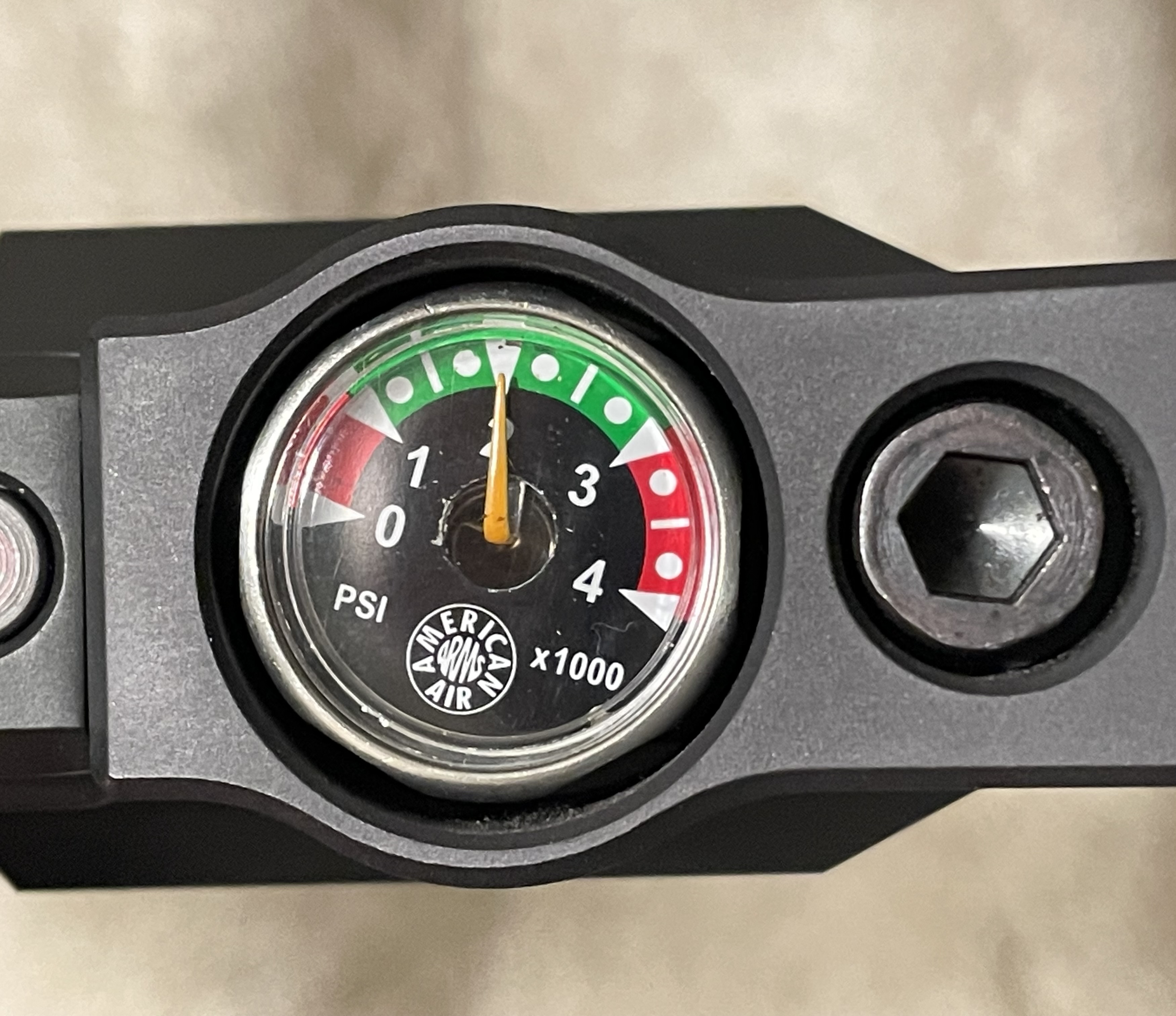

That's around 39 fpe so you will need to bump up the reg a bit. Prob around 2100 psi will get you there. If you think about it that's really not that bad. That's about a 145 bar reg setting with a 15" barrel which is pretty good.

Here’s where my reg is set at.
