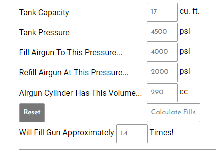

I think I did this correctly. Ninja buddy bottles are measured in cuin at 1 atmosphere and SCBA tanks are measured in cuft at pressurized working volume making the conversion a bit confusing.
100 cuin buddy tank should equate to 17 cuft @ 4k500
Thank you! 0 fills sounded off to me. Why else will they be in the market? I can't wait to sling lead out of your work of art!
