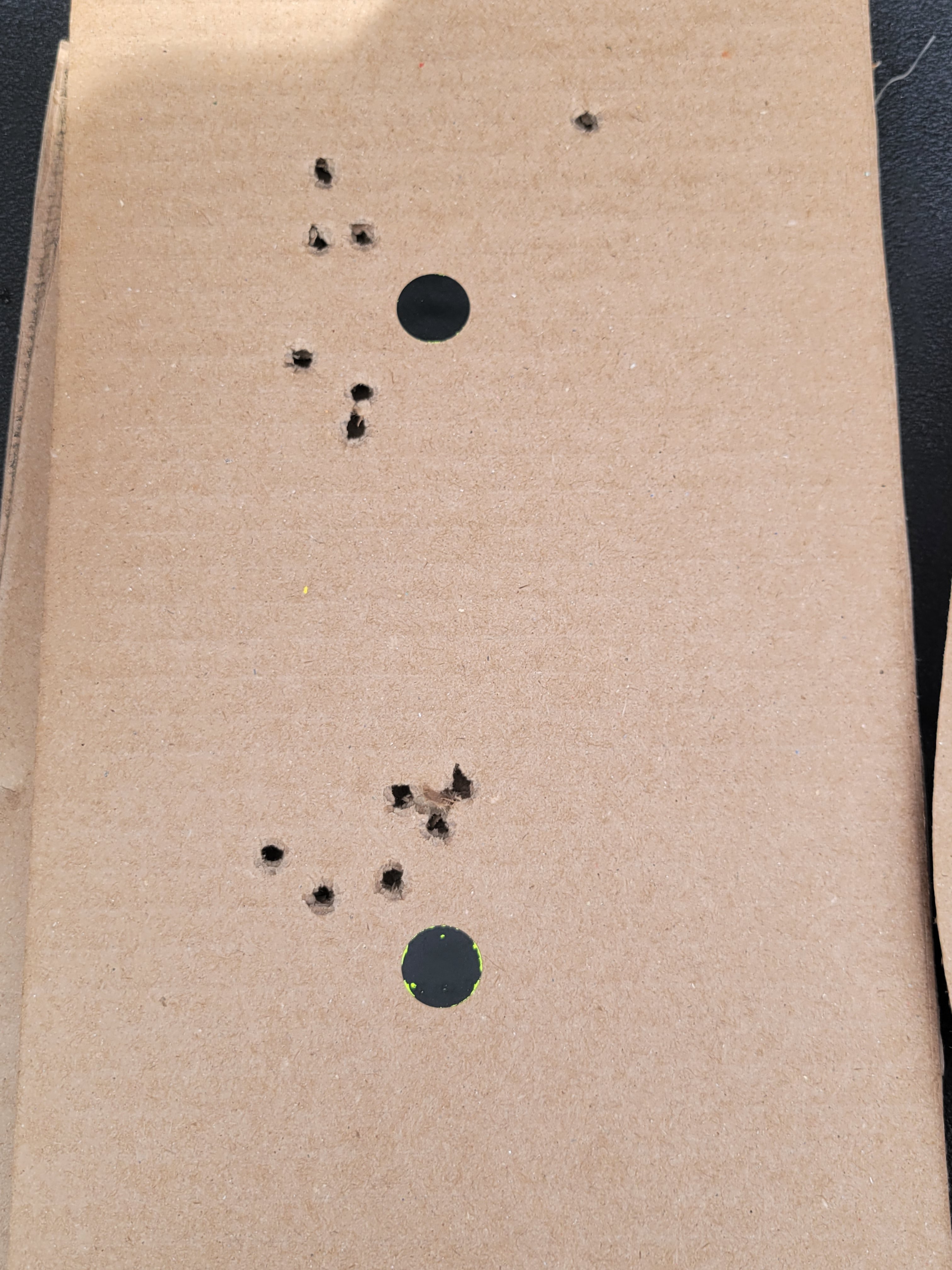

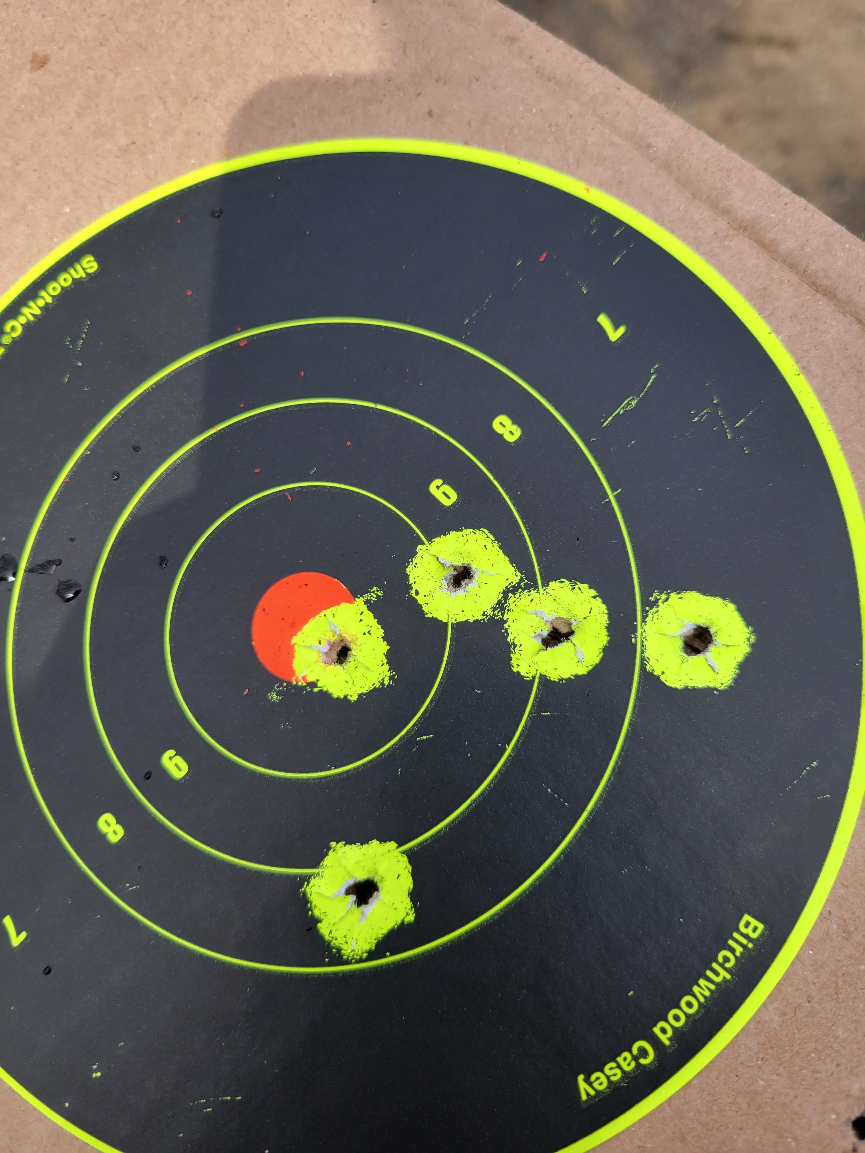

My Magnon shoots JSB 44 pellets lights out. 50's close. Tried lots of different slugs and none come close. Group here is 50 yards. View attachment 339702
