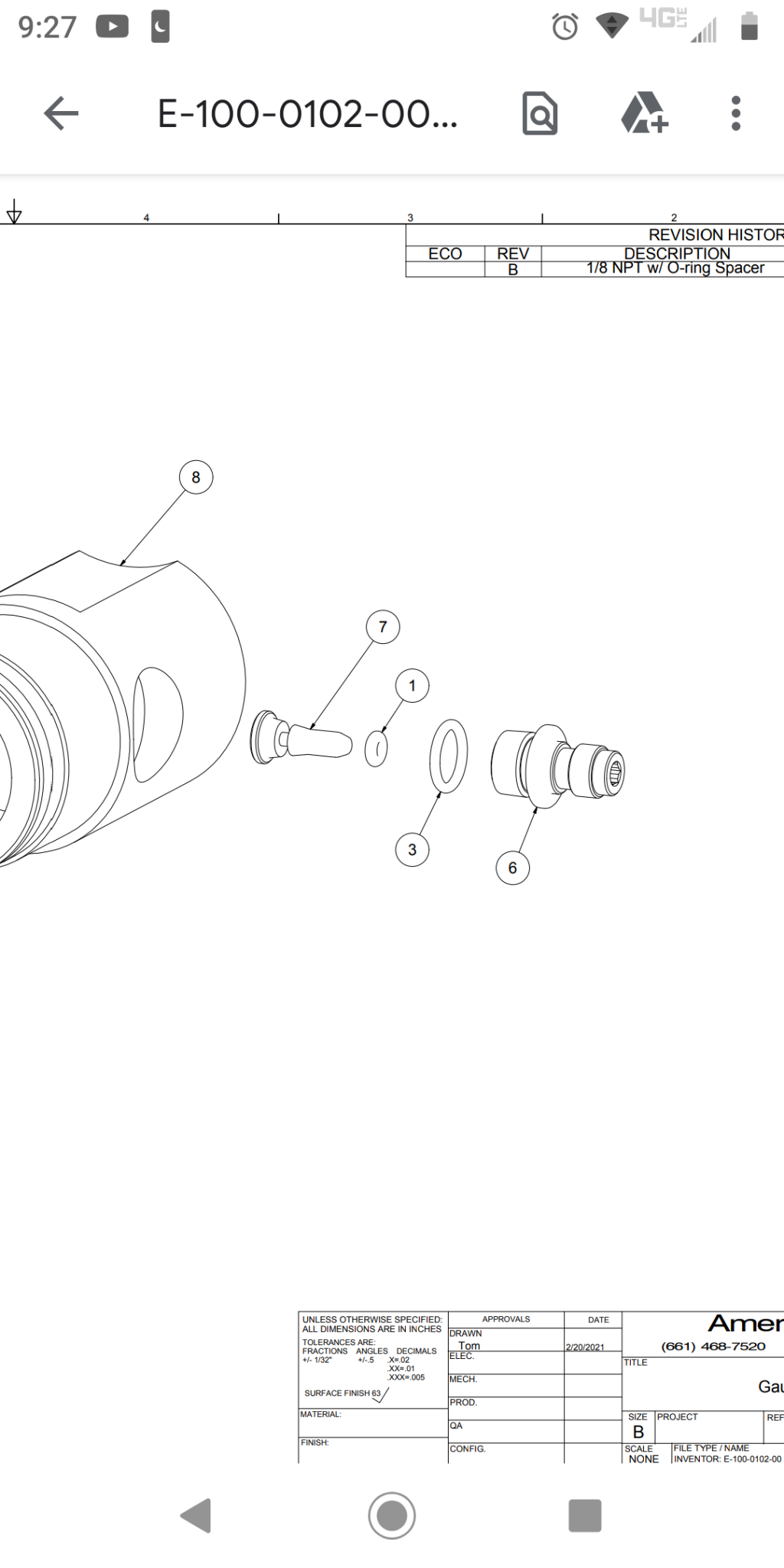

Well little issue with the EVOL. Not sure what caused this as I've filled it like 15 times so far and last 5 times the foster is getting stuck open. Need a pliers to quickly do the bleed screw and not drain the tube on the gun. Based upon this photo looks like the part that could be the culprit is the little oring? #1. Could just try adding silicone oil to it I guess. Doesn't leak at all once I get it bled. Annoying thing is if it is that oring, it's the only one oring store didn't have in stock when I ordered all the orings for the gun.

Oh yeah it's not a big deal to me really. Gun still holds air just fine just upon the bleeding. I contacted Tom and he said that the oring should be the issue. It's funny as I bought all the orings for the gun just something I've been doing the last few guns and the only one out of stock was that size at the oring store. But yeah you never know when an oring can go just happens.
I appreciate it Gerry! But I have them on there way. Nice thing is the oring store is in WA so most orders from there is like a day or 2 max. And yes I am bleeding it fast. Can't bleed it fast enough to shut on my own so need to use the pliers. Usually works just fine. I did actually add 2 drops of 10wt silicone oil into the foster fill and did help it work as it should again. Will likely replace the oring though once I get it.
